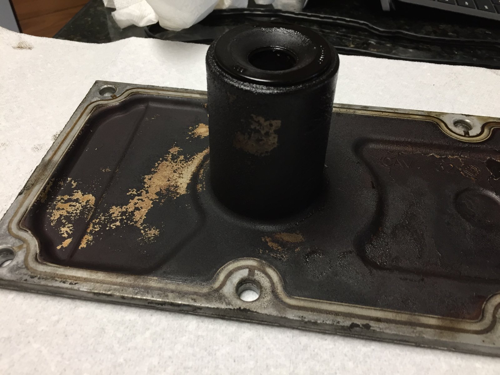

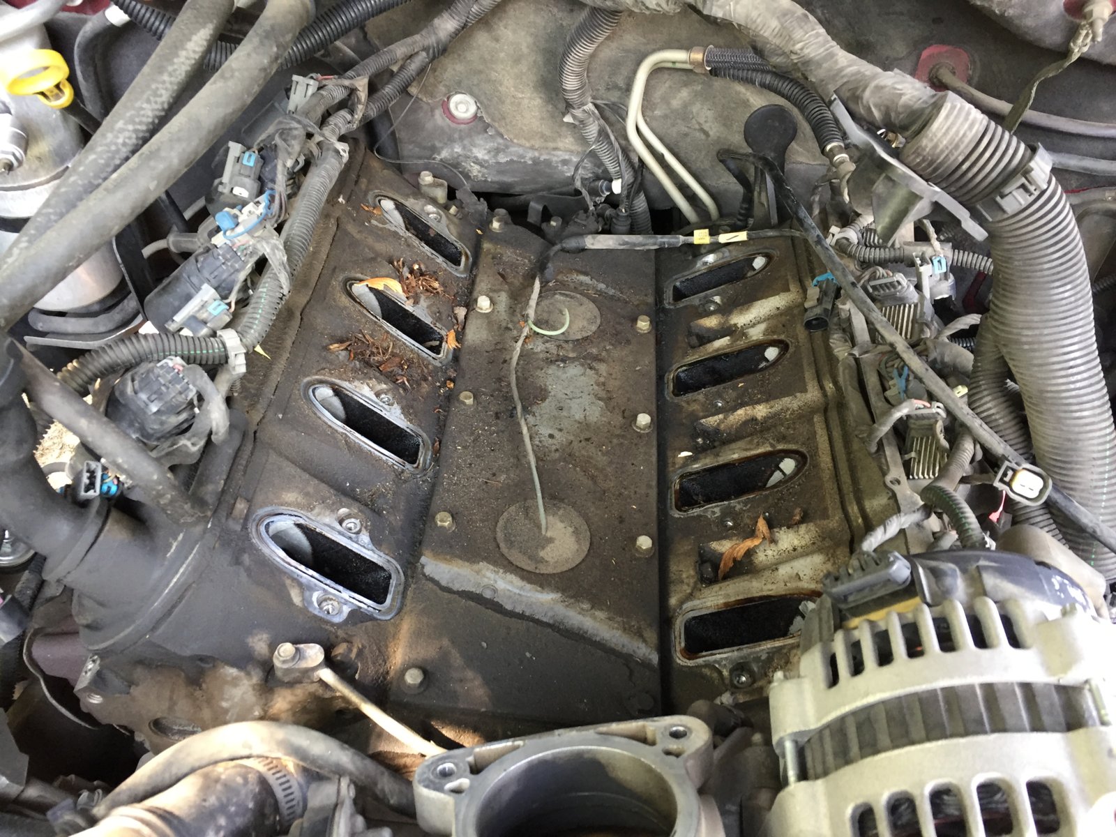

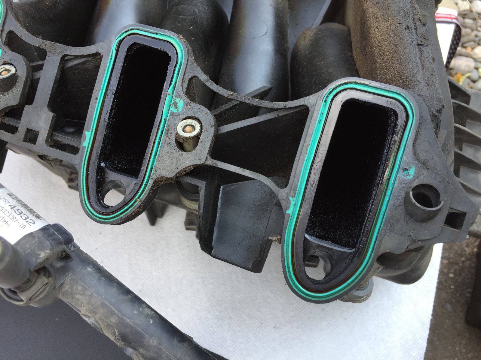

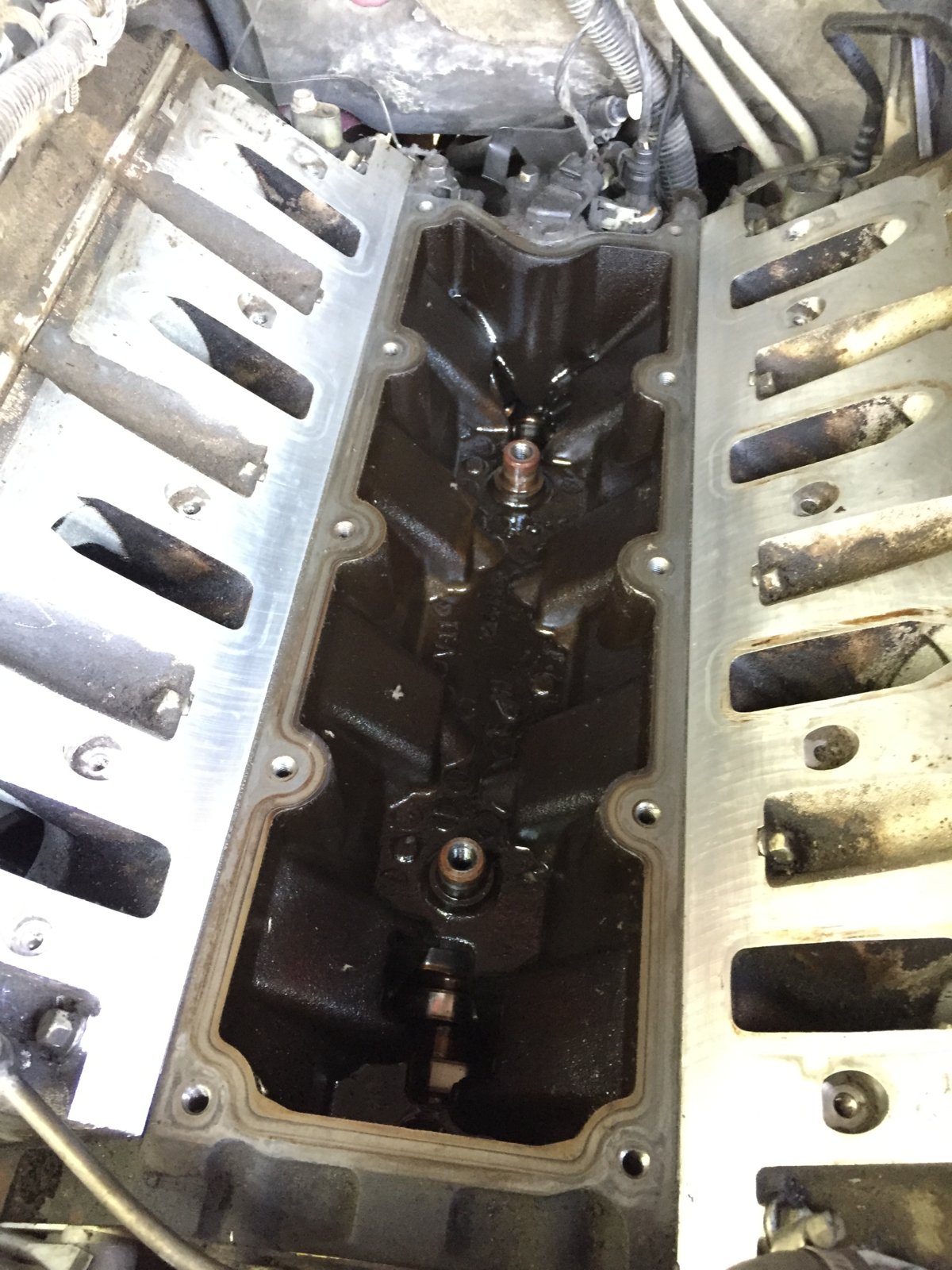

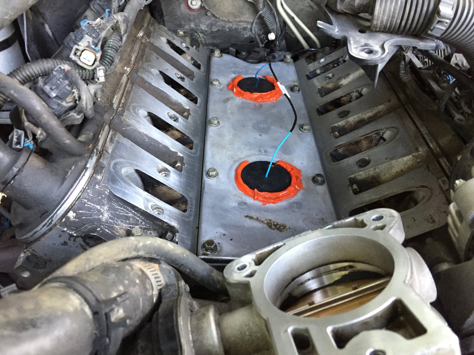

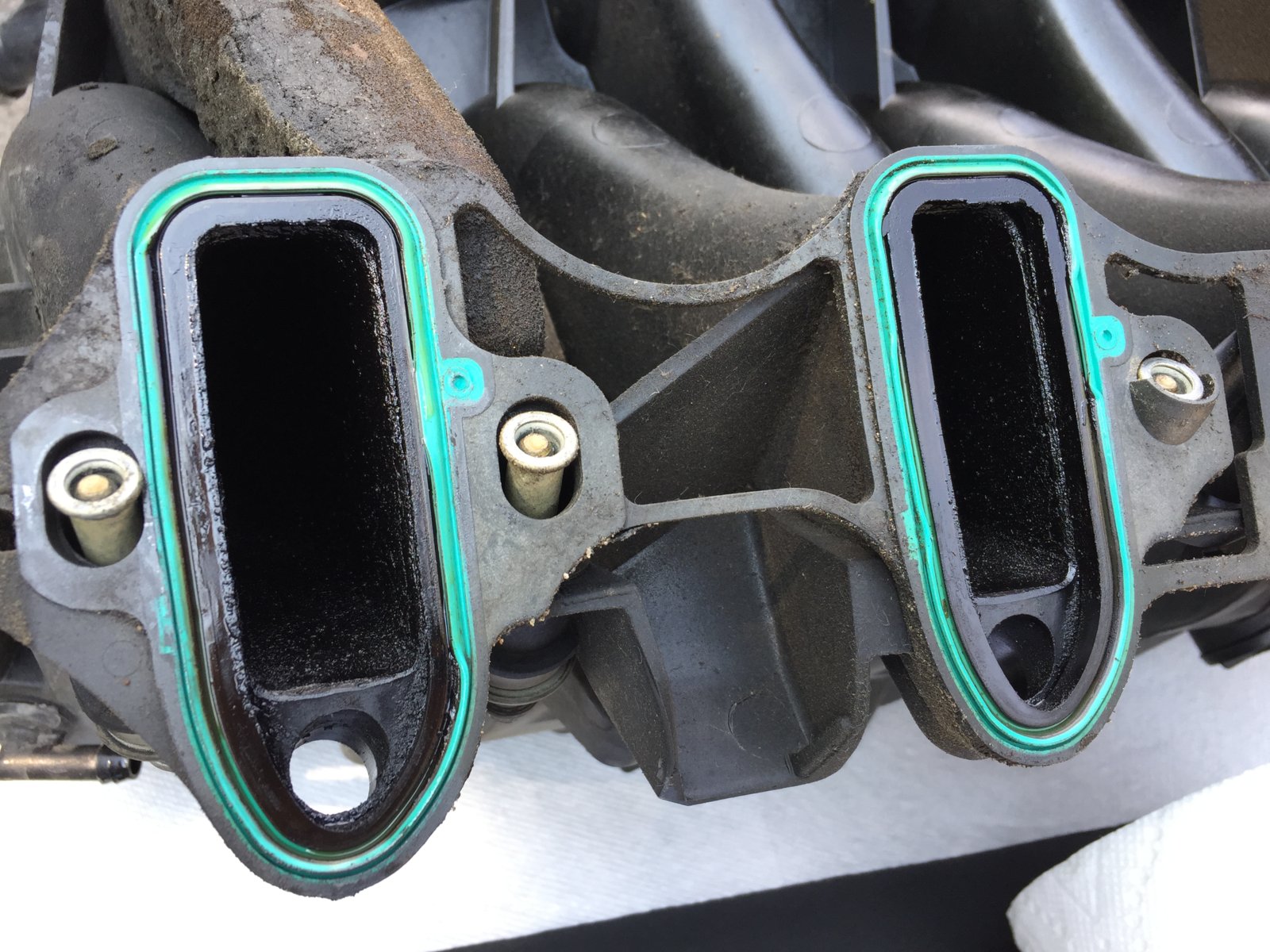

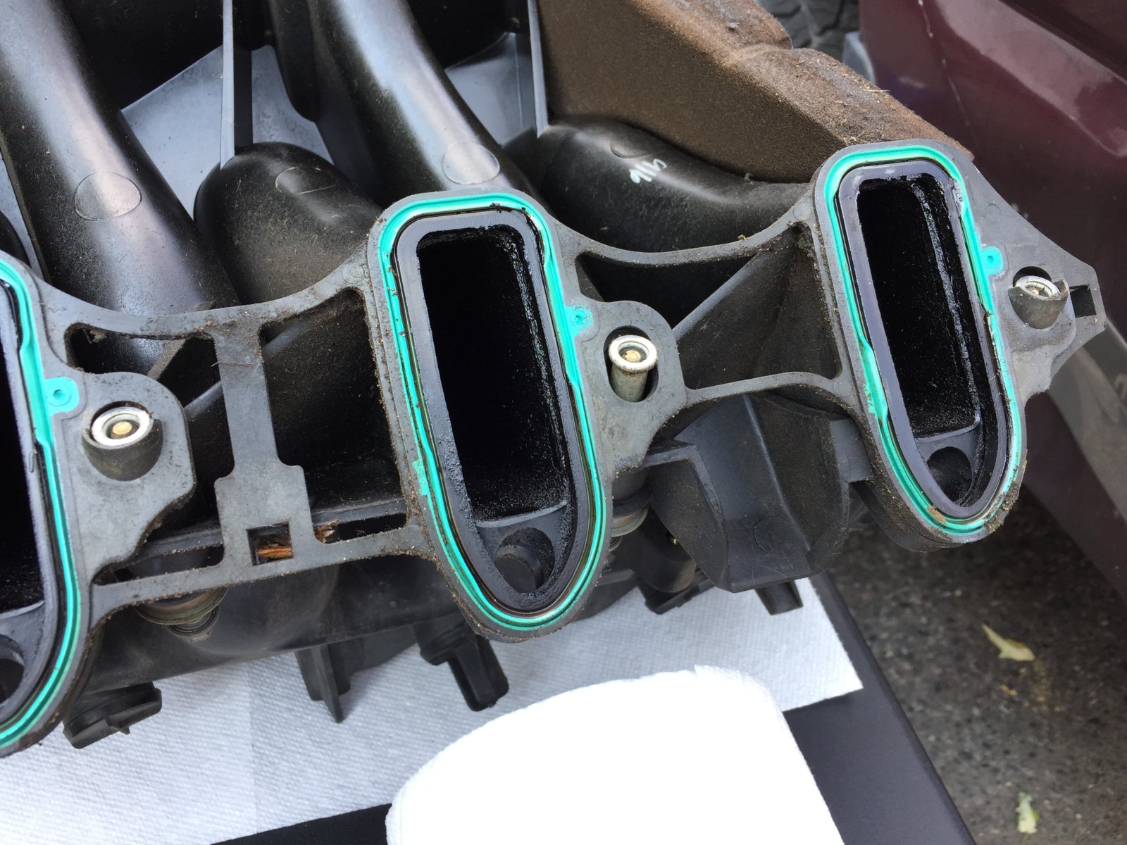

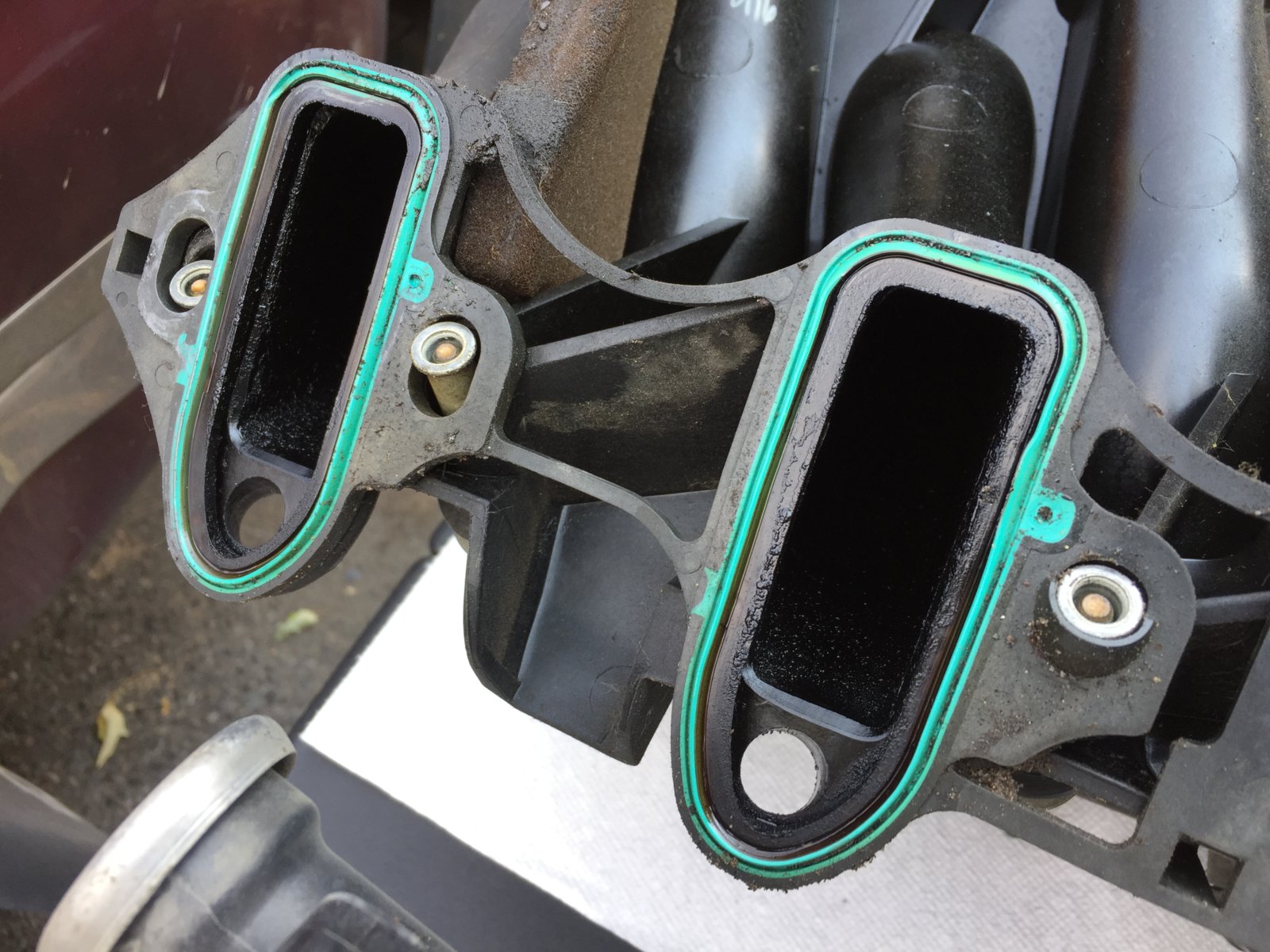

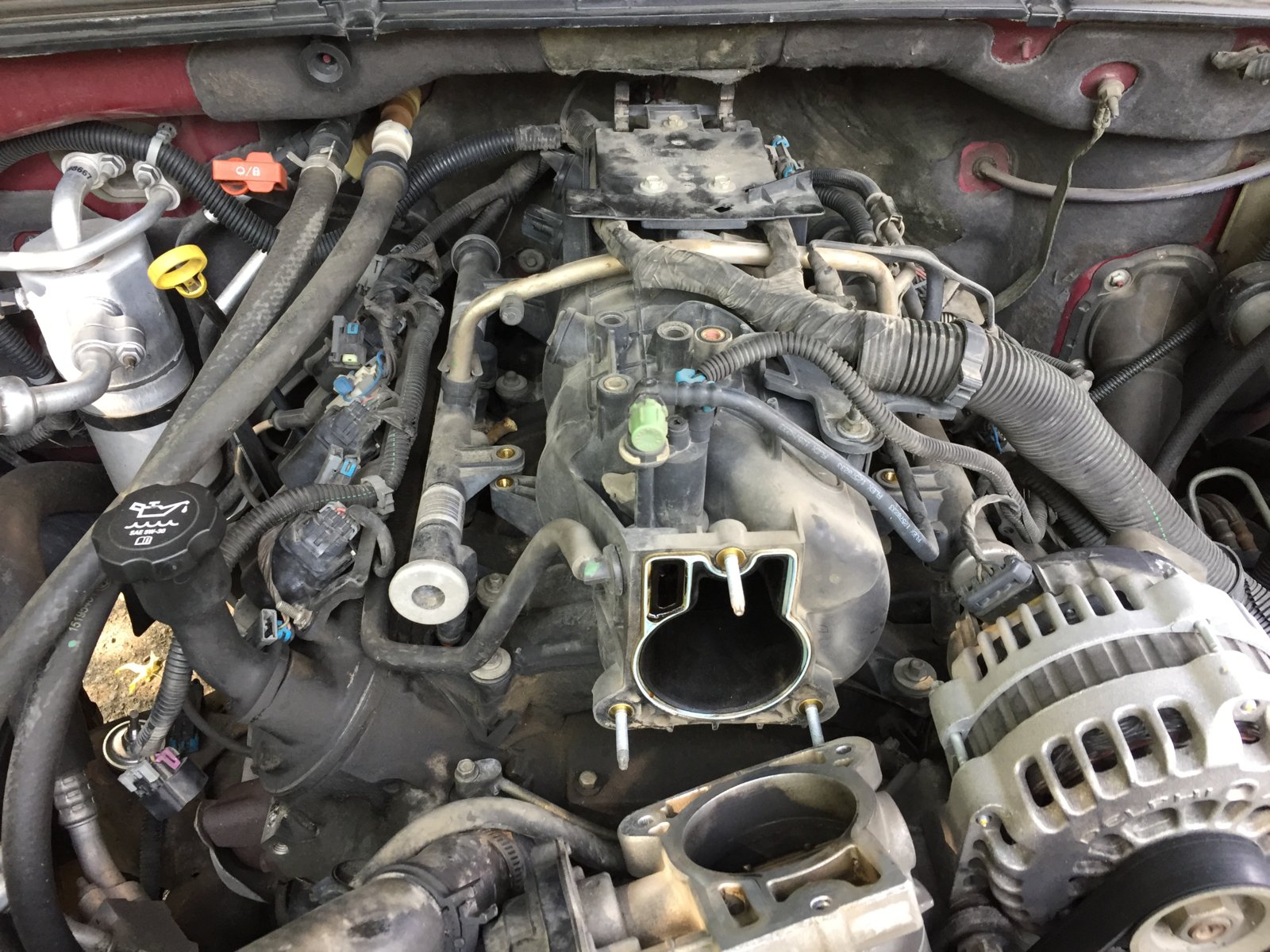

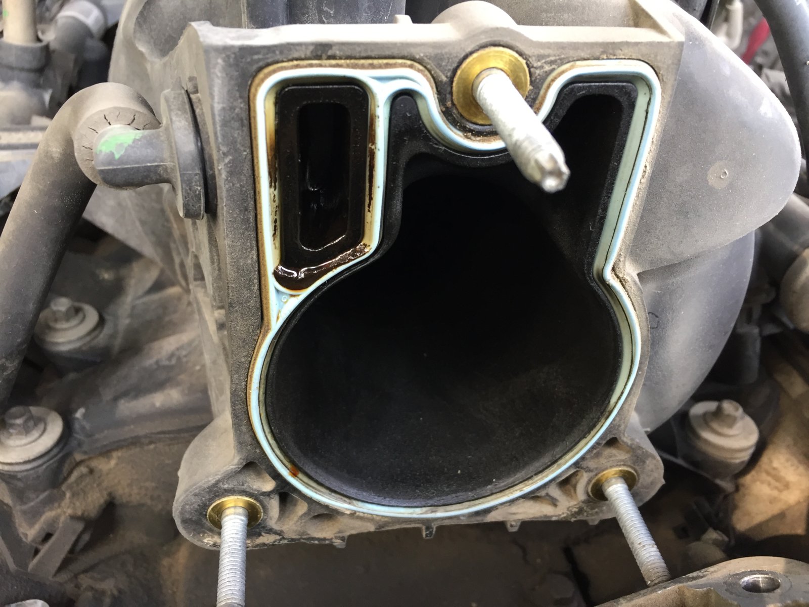

Alright finally made some progress today. Replaced the intake manifold gaskets and the valley cover plate gasket. I just have to put the fuel rails and injectors and the throttle body back tomorrow. I have new gaskets for the valve covers but I figured the dealer would check in there anyway for cracks so I'll let them change them. I'm taking the truck there on Wednesday for a check up. Let me know if anything jumps out at you.
20180908_174355744_iOS.jpg 20180908_174406749_iOS.jpg 20180908_180450917_iOS.jpg 20180908_184218524_iOS.jpg 20180908_184224627_iOS.jpg

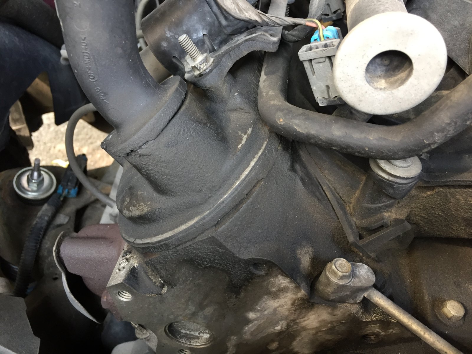

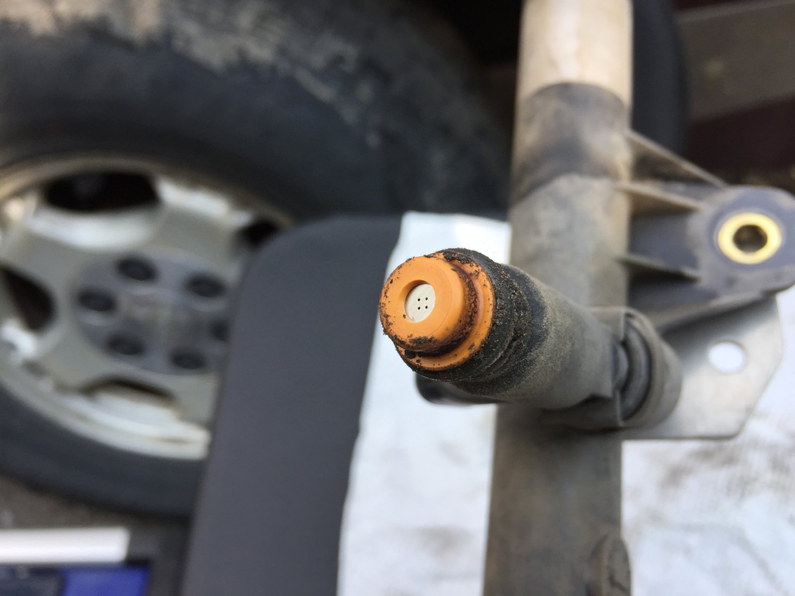

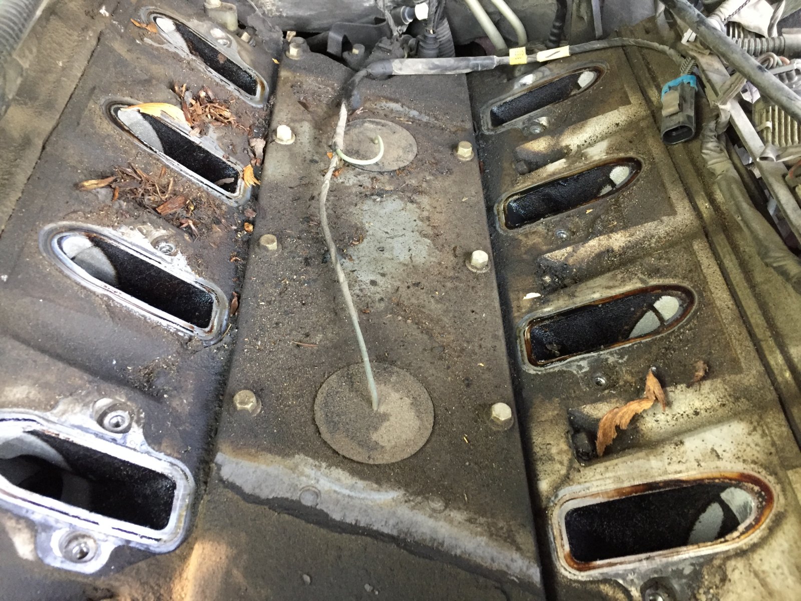

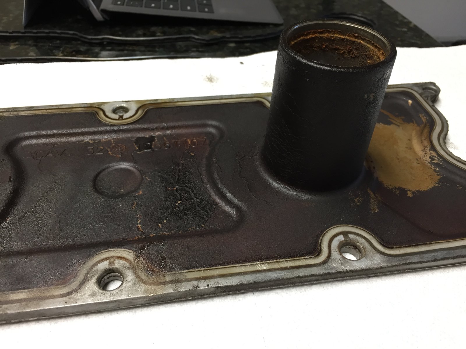

Also, found what must have been a bird's bone next to the intake manifold. Time for mouse poison...
20180908_201046646_iOS.jpg 20180908_201052682_iOS.jpg 20180908_210855200_iOS.jpg 20180908_235618596_iOS.jpg

There's not much into to be gleaned from the intake side of things. These trucks have a dry system, coolant doesn't interact with any of the intake gaskets

I just did intake gaskets. Those can leak coolant right?
