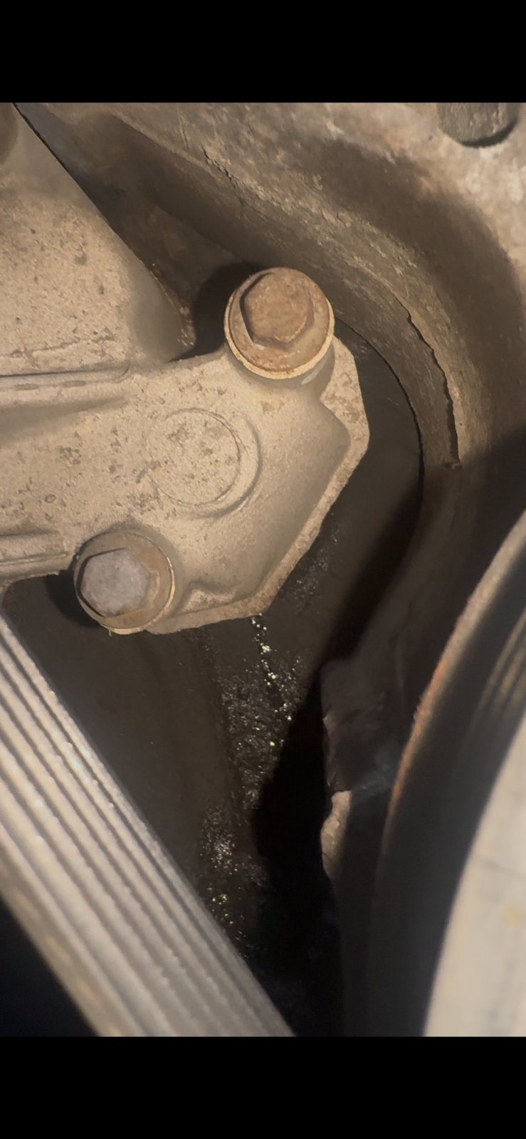

Look for the corrosive stain from the weep hole, that will show a water pump leak, which is likely what you have.

Yes my bad ha, its a 2005 Yukon with a v8 5.3 in it. lovely motor. This morning, i found the leak!!! i confirmed the leak is coming from the upper right most area of the pump on the bottom end of the seal. Looks like gasket failure. i will be replacing the pump, thermostat, belt and resivoir cap just to get all that out of the way! I will post pic of the leak its on my phone
