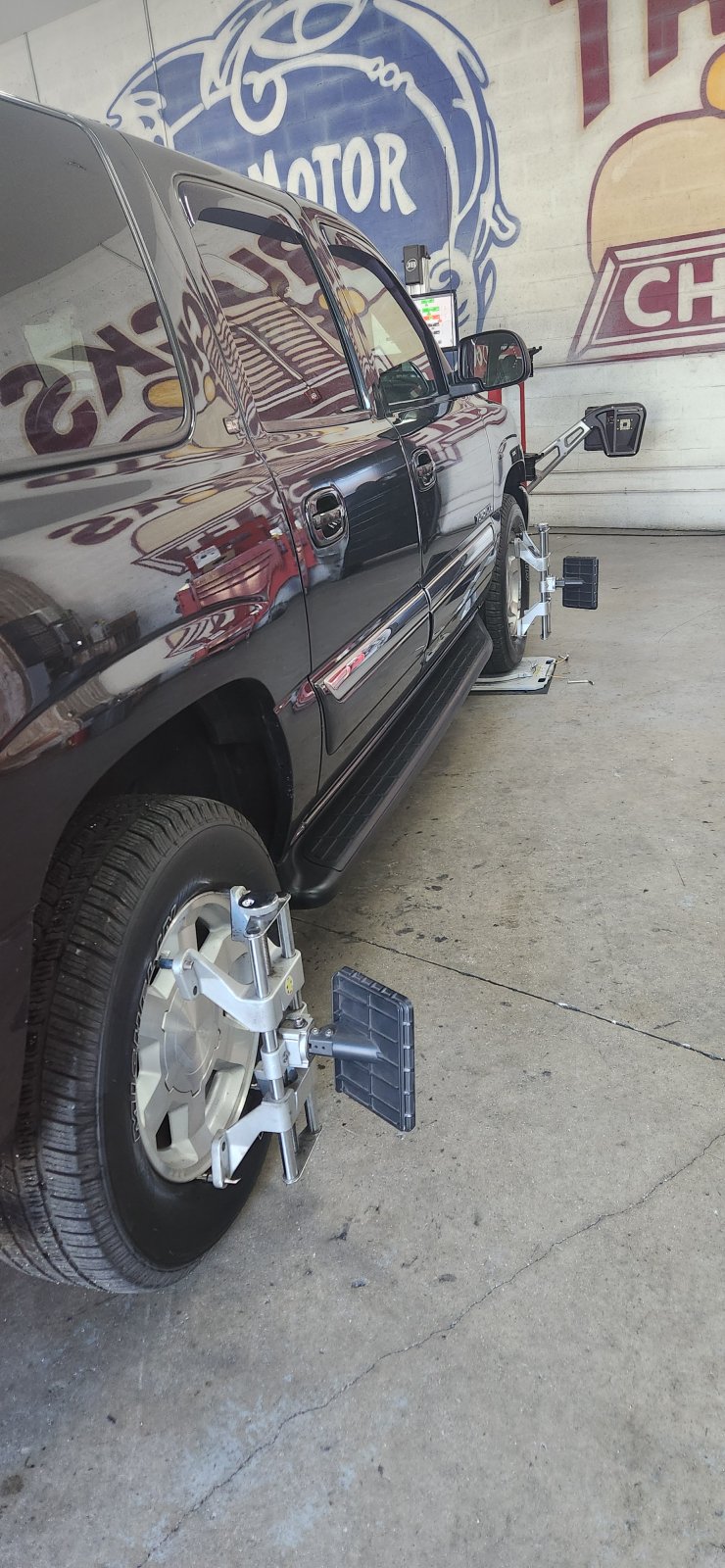

Good info……. My front steering & suspension / balljoints etc. is new, installed by a VERY good custom truck shop along with Hellwig sway bars, about 6 months ago, along with them doing a front/rear alignment …. Then had my tires a ‘road-force’ balancing.
>> Just got back, getting the alignment….
My ’05 truck rides like an S Class Mercedes at speed.
