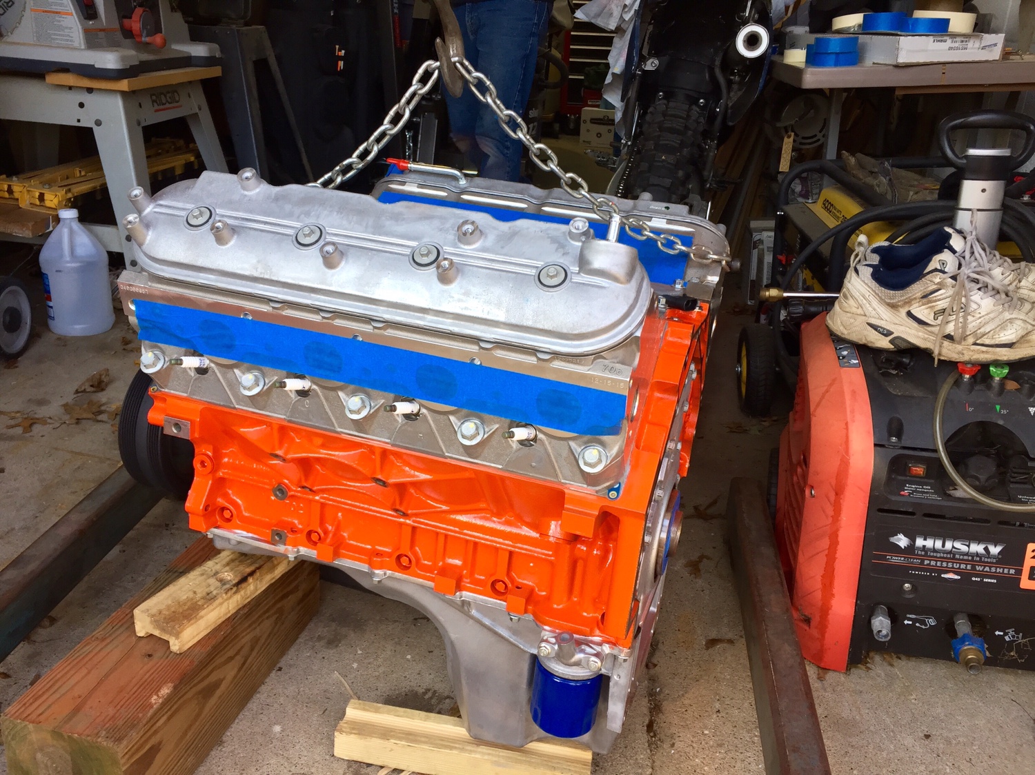

UPDATE: I had an engine swapped in and it's finally back up and running better than ever! I want to thank each and every one of you that helped guide me through this. I would've been completely lost without you guys.
The engine is a remanufactured 5.3L by ATK. I've driven it for about 300 miles so far and am pretty happy with the slight power increase over the old one that had 206k miles. Although, if I had to do it again I'd probably go with an L33 or a 6.0L. I couldn't find a remanufactured L33 and the 6.0L was a little out of my price range though. I also haven't noticed any better gas mileage so far. The new engine has 706 heads and the old one had 862's so I'm wondering what the difference is between those.
So, by now there shouldn't be any bad Castech heads getting remanufactured out there, right? That would suck for that to happen again.

Congrats on the swap and refresh! Do you mind sharing what the reman cost you, both for the engine itself and labor cost for the swap? Where are you located?

I expect to easily get 200k from this engine. The original one made it to 206k with zero issues whatsoever until I discovered the infamous cracked heads.
I don't mind sharing. After the core return the reman engine cost $2500, shipping included for both ways. It has a 3 year/100k mile warranty that also pays for labor costs.
The labor I feel like I got a great deal on. It cost $1400 including new misc parts like a radiator, thermostat, block heater, oil, filter, coolant, etc. One of the best parts was that I couldn't even tell that they'd been in there. No paint scratches, oil smudges, left over little parts, nothing. Everything just looked perfect which is perfect because I'm a perfectionist. Since the labor was the best deal I could find I expected it to look hurried and sloppily done. I'm in Billings, MT
