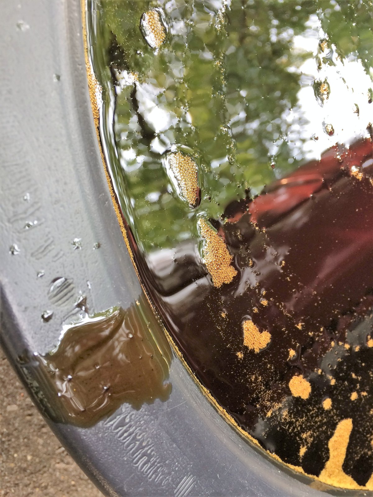

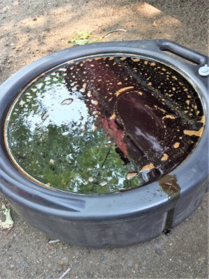

I had time to drain the oil at lunch but didn't have time for anything else. I sent the pics to my dad and he said without a doubt there's antifreeze in there. Judging by pictues online, it could've been a lot worse. I will check the underside of the filler cap. I do drive short distances to work.

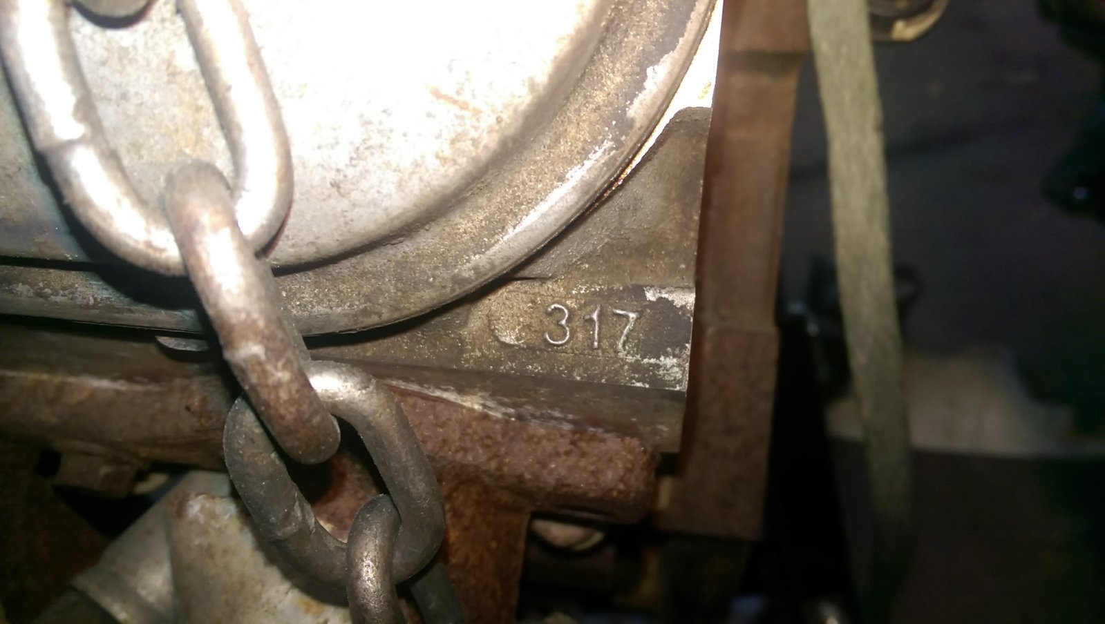

Easiest way--On the driver side, look all the way to the lower right(rear of the head) , you'll see a 3 digit # stamped on the head, that'll tell you what head casting you have--on the pass side that number is all the way to the right(front of the head)
