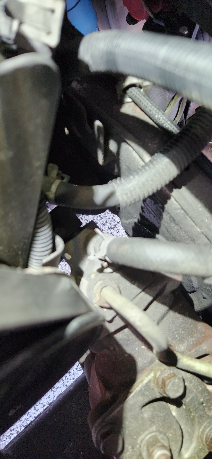

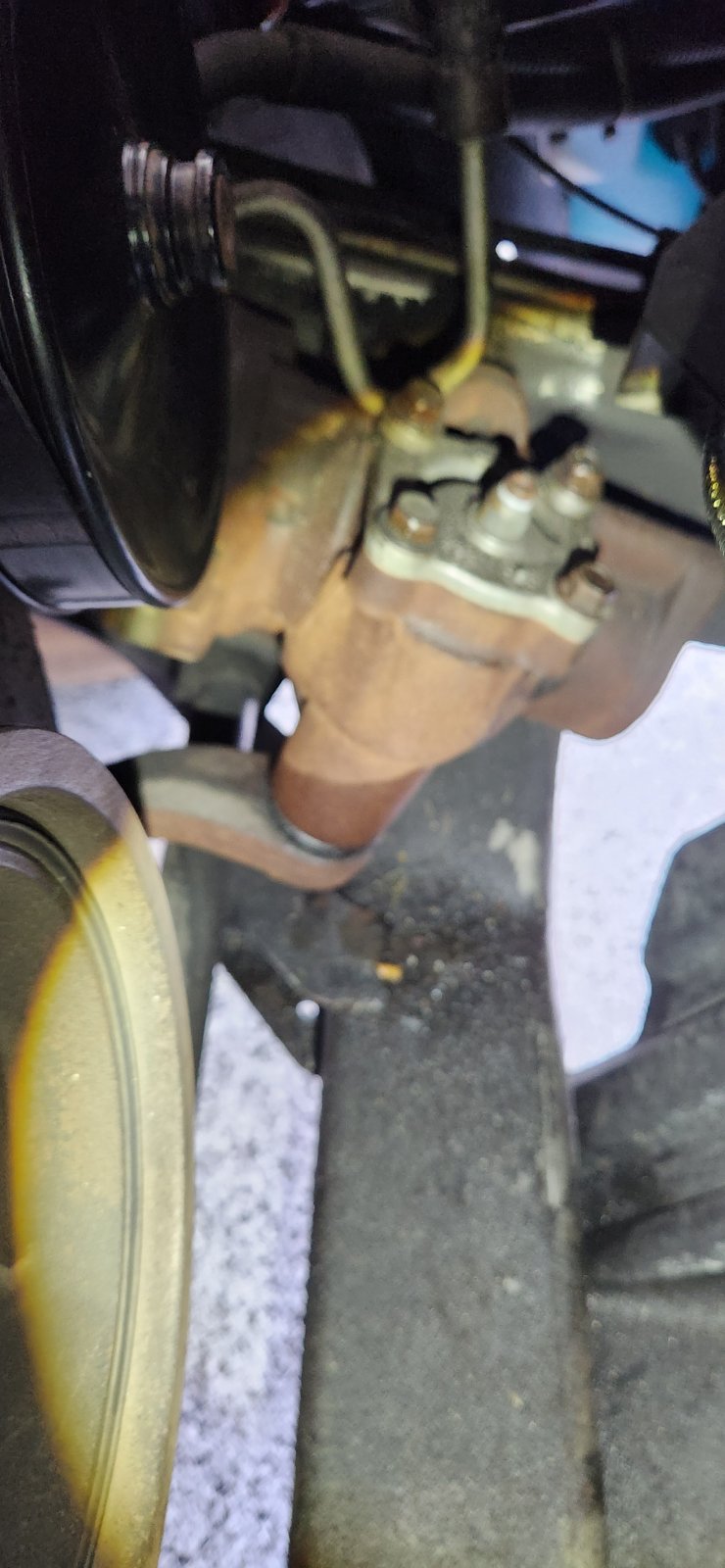

1st photo showing fluid leak… It appears it’s coming from the cap….. at the forward side……. unable to see, but……fluid on the cross member below the box….. but not causing much of a ’spot’ on the floor…. no spot on the floor this morning.
2nd photo…..The fluid lines attached to the box are dry.
Maybe try to tighten the steering box cap?????
>>> Update……. I think, the oil on the lower half of the box in photo……. It may be from the leak, wicking upward from the bottom spline….. I reached down & felt the area below the top cap, in front and it seems dry.

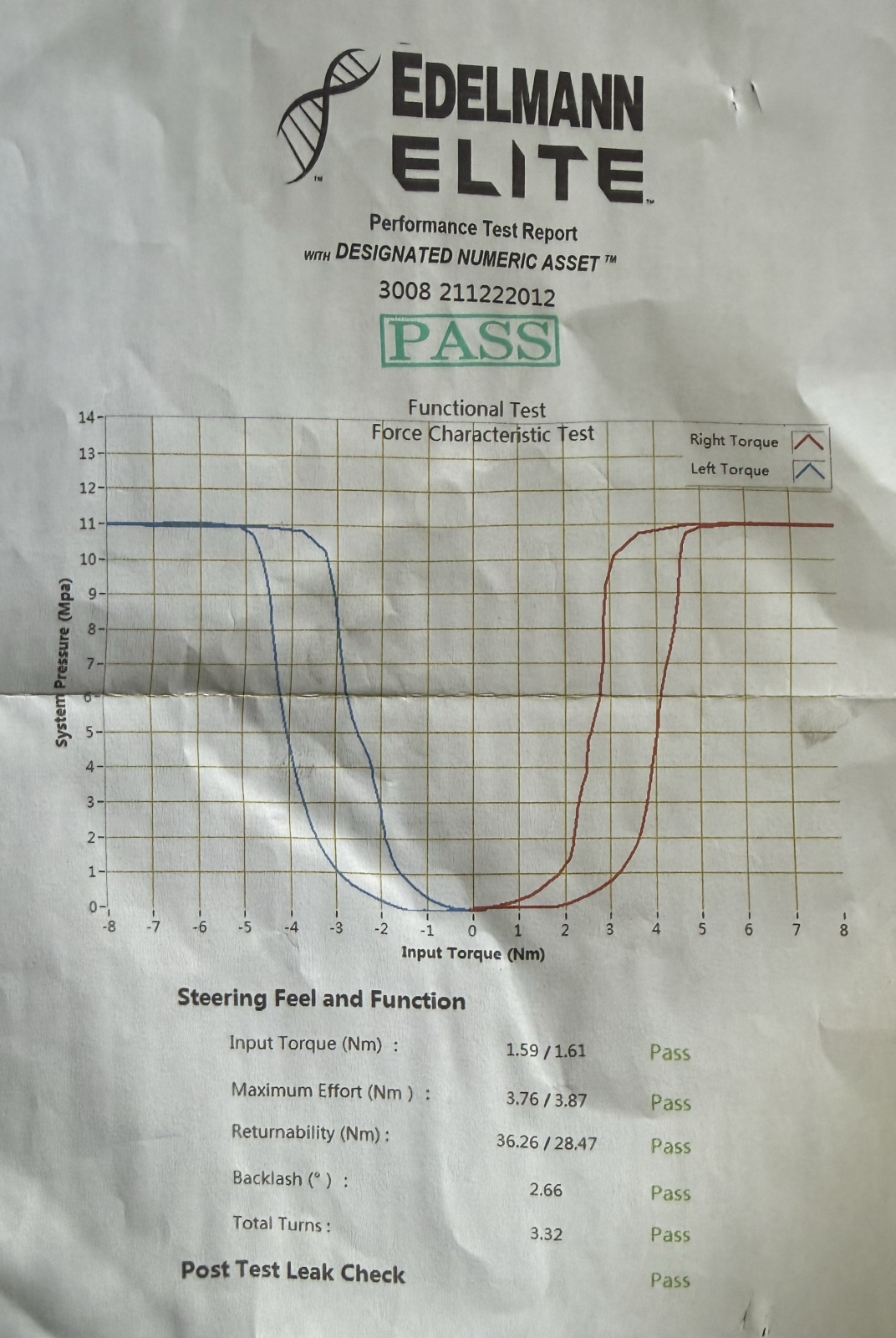

Steering box is not a reman……. This is their test result sheet.
But not quite finished yet….. The pitman arm is limited how it attaches to the steering box shaft….. I am now researching how to ‘spot’ the steering wheel back to center….. I may just get another front end alignment to center it?
