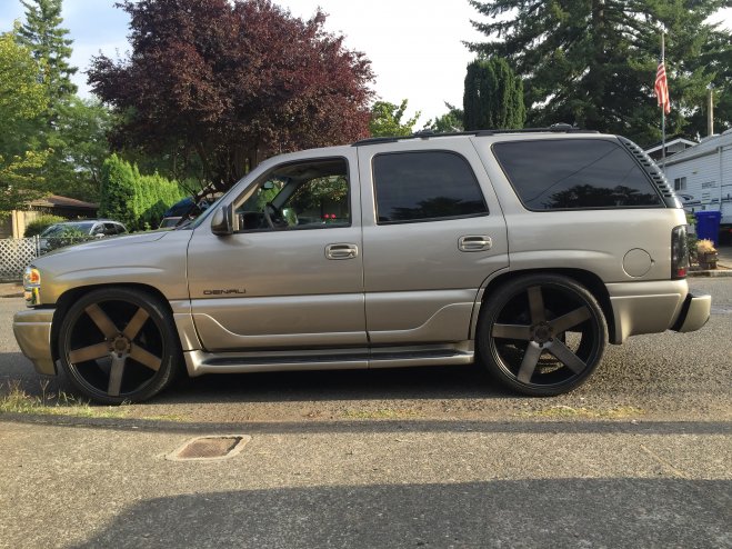

Popo I had a shop do my drop too and now I'm going to do the free travel mod. Mine rides OK for 26" rims but Im hoping to make it better. Also doing the DJM endlinks so the swaybar sits right, its supposed to help too. I'm trying to go a bit lower in the rear and I need that mod or it will bottom out. Check out the thread on the free travel mod and you'll see what we're talking about. You can then look at your truck when you get it and see how much travel you have. I was surprised mine didn't bottom out, must be coming close.
52,956
Hey Tony I did the free travel mod today but I don't see how to install the bumpstops- there's no way to get to the nuts. Do you just drill and tap a hole in the frame and use vise grips to tighten the bumpstop ? I made some 2 1/2" Autoride ride links and it sits almost perfectly level now. I'm concerned that if it's loaded or towing a heavy trailer it might hit without those stops installed. Now if those endlinks get here...looking good though.
unbolt the lower trailing arm where it meets the axle and pivot out of the way you will be able to bolt the bump stop to the axle pad there should be a hole towards the rear section of the pad, its tight to get the nut up in there but you can do it...getting the trailing arm out of the way was necessary for me to get my fingers up in the hole to hold the nut ( no wise crackin jokes please... Lol) you might try to hold it with some needle nose pliers...

southboundchicken thanks, I got the bumpstops on. Then the endlinks. Then decided to pull the Belltech shock relocators and replace them with the DJM ones since they space the shocks further down which should have lowered the rear a bit more since the Autoride adjusts it. But no difference there. I was hoping to use my longer 3" autoride ride height sensor links because in the past when I went to 2 1/2" ones, they would pop out of the threads when the suspension was hanging. Anyway, now the 2 1/2" ones stay put when I jack up the frame; guess something changed there and the suspension doesn't hang as far down as it used to. And my truck sits level so all's good. Plus the ride is much better- thanks Tony.
