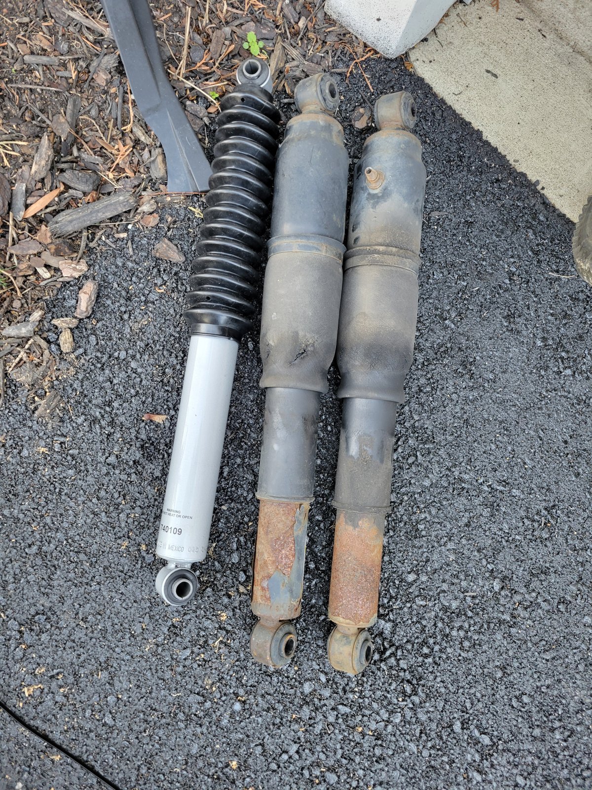

Got them installed yesterday, so far, so good. I was pretty nervous that putting in lowering springs in the front (vs. drop spindles or lowering control arms) would really screw up the ability to align the front end but a local shop was able to align it pretty close to spec. The only sacrifice in alignment was I lost about .5 degrees of caster. Overall impressions are good-the ride feels much more "sporty" and both brake dive and body lean are greatly reduced over stock. The front now sits about 1/4" lower than the back vs. the 1 1/2" difference before. My only complaint is that the front end ride is a little stiff now though it may settle a bit.
As a part of the spring install, I replaced my blown rear air shocks with shorter 02-07 Avalanche monotube shocks (GABRIEL MaxControl 77953) so I wouldn't risk bottoming out the shocks. Eibach doesn't call for shock extensions but I figured it would be safer to get shorter shocks to be sure.
I capped the air lines and zip tied them out of the way and to (hopefully) prevent any air leveling codes/messages/etc. and I "adjusted" the level sensor levers to make it think it's sitting higher than it actually is.

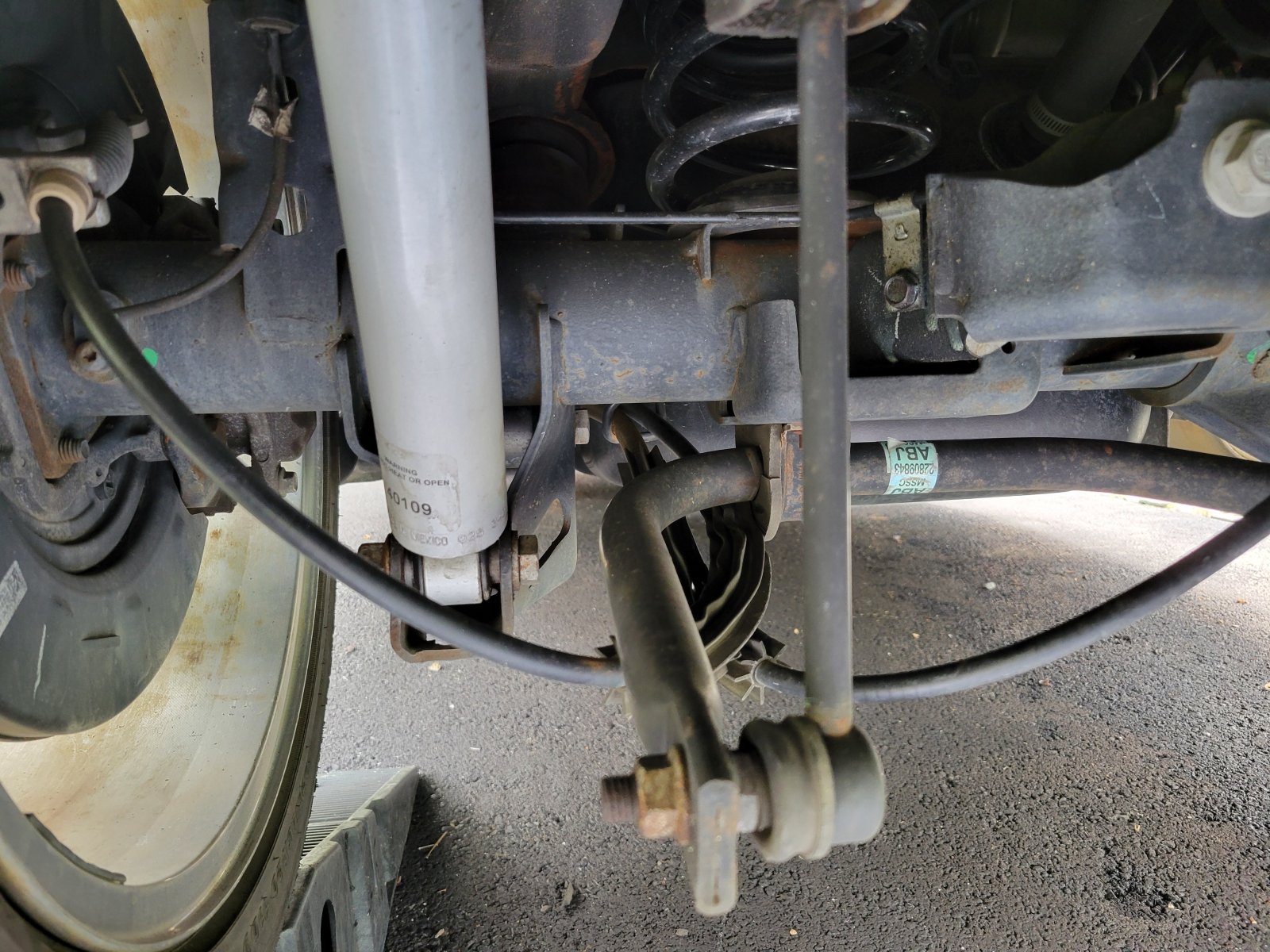

Update 2: I put some 1.5" shorter end links on the front and that got the swaybar pretty level at ride height. The rear swaybar absolutely needs a link change/modification with this kit despite the instructions not mentioning anything about doing so.
It's a little hard to tell from the picture but the swaybar is hanging way down in relation to the axle and it is somewhat straining the parking brake cables and causing them to wear through their ribbed protectors. Eibach really should have done something about that in this kit so just be aware if you decide to go with this kit or go with any other 3+inch lowering springs that don't recommend a swaybar position change.
