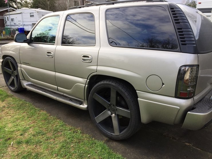

I used drop spindles in the front and rear springs with shock extenders on my '02 Denali. The rear kit came with shorted ride height links for the autoride to keep it functional. It rides great considering I'm running 26's. And I can tow without having to mess with anything. It sits at about 3/4" higher in the back.
That thing looks great! How much of a drop is that?

That's a 2/3 drop about. The belltech kit is adjustable from 2.5 to 3.75 in rear on autoride trucks that I have on my site
