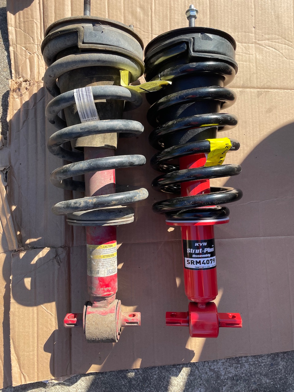

Installed the kyb monomax front struts today. I think @Rocket Man was wondering about these.
Taller for now.
Updated first post with picture. Hard to compare because I didn't measure and I removed a 1.5" lift spacer.
(Stock Z71 rear springs with 3rd row removed) The way it looks currently, I'm hesitant to install PPV rear springs.

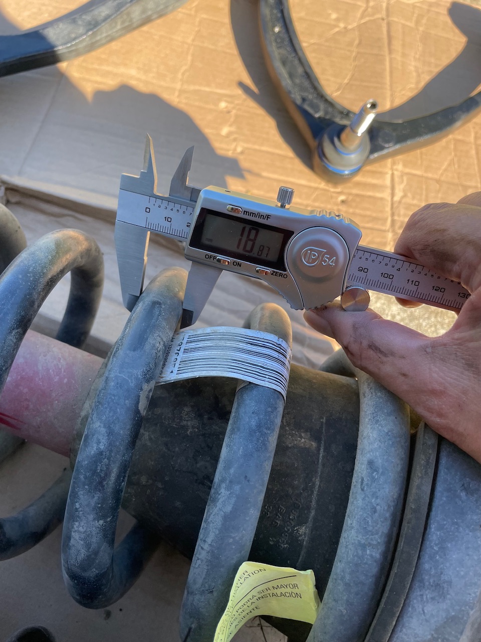

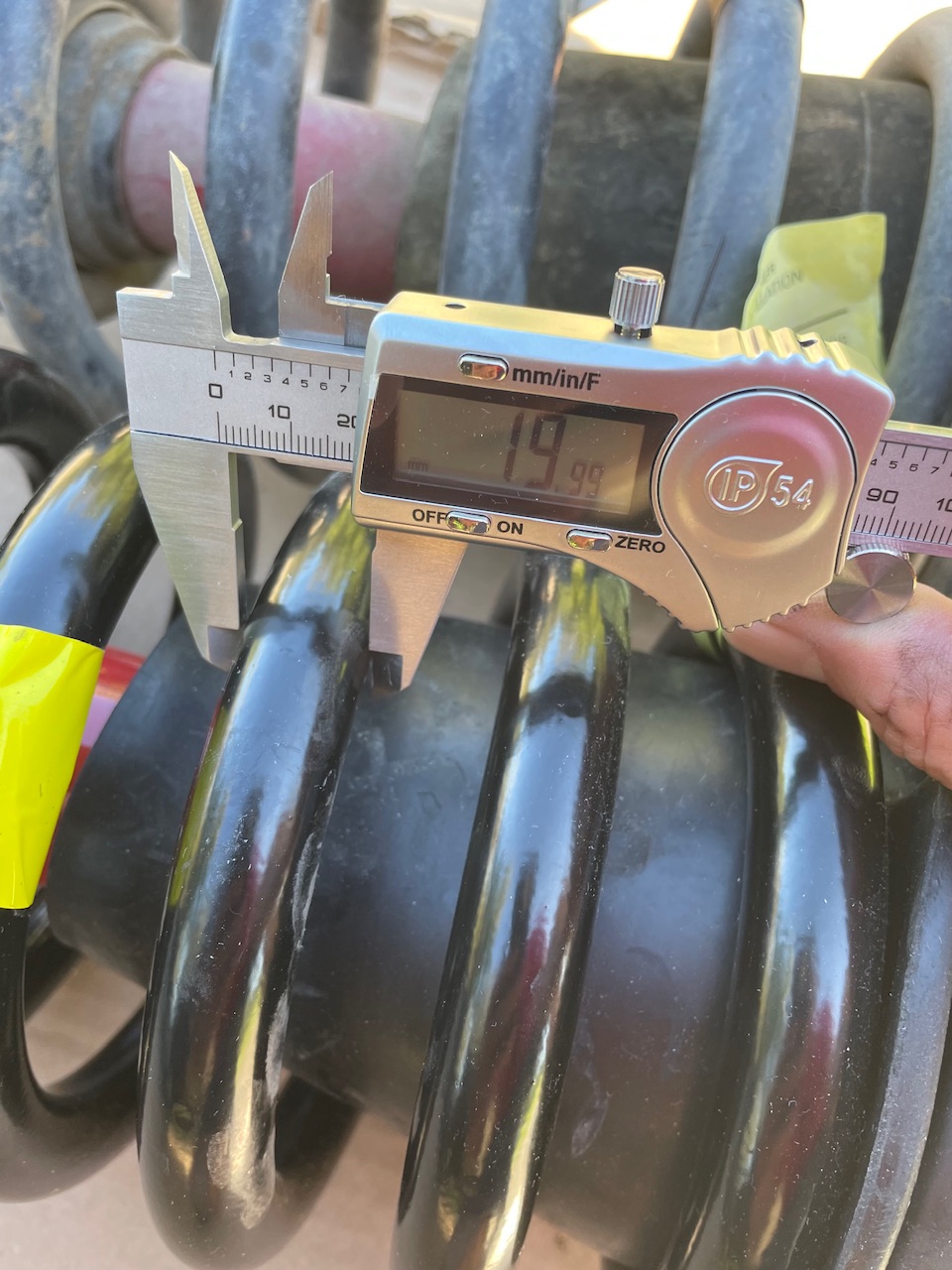

The coil spring was about 1mm thicker and had 1 extra coil compared to the Z71 front's (stock 4WD?)
KYP top hat seems flimsier, doesn't have that edge completely rolled over.
I re-used oem strut top nuts, they had a bigger flange and did not have serrations like the ones included from kyb.
Hardly any weld holding the shock to bottom mount, but all photos I've seen look like that.
Taller for now.

KYB feel softer than stock over bumps. I like it so far. Probably raised front .5" or so. Might still settle..
Stock was a little jarring on speed bumps in comparison.

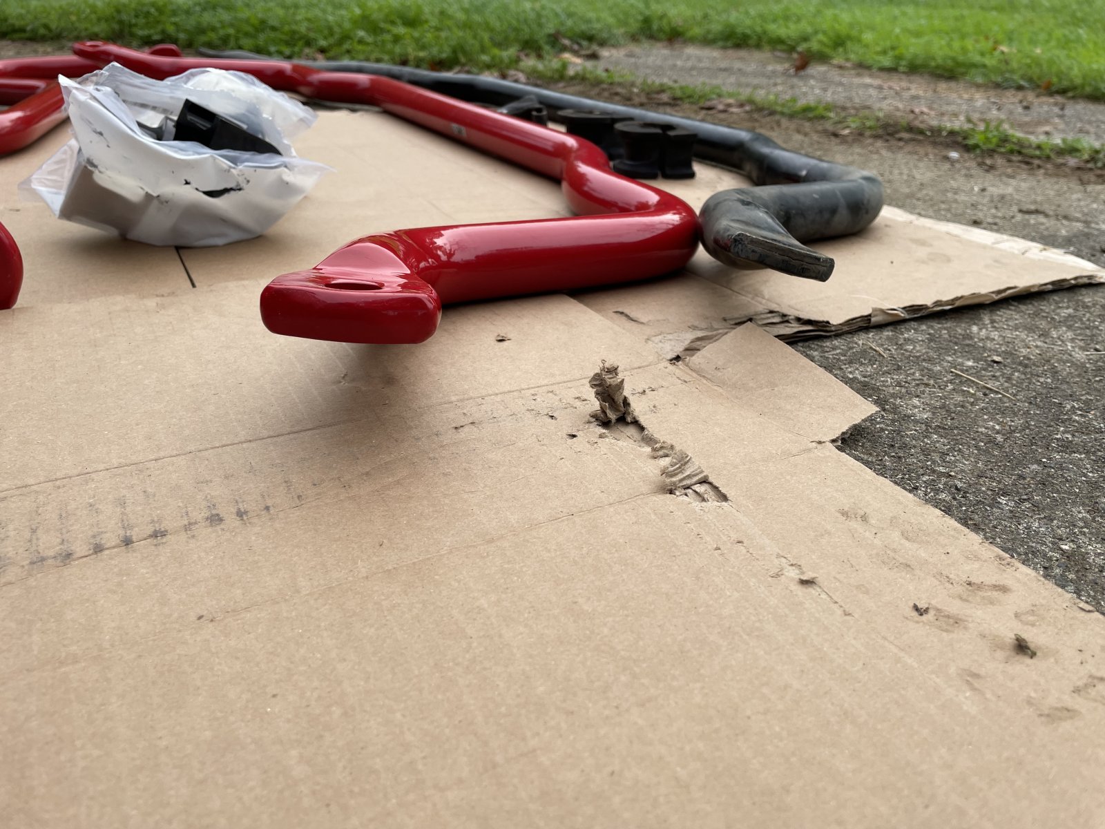

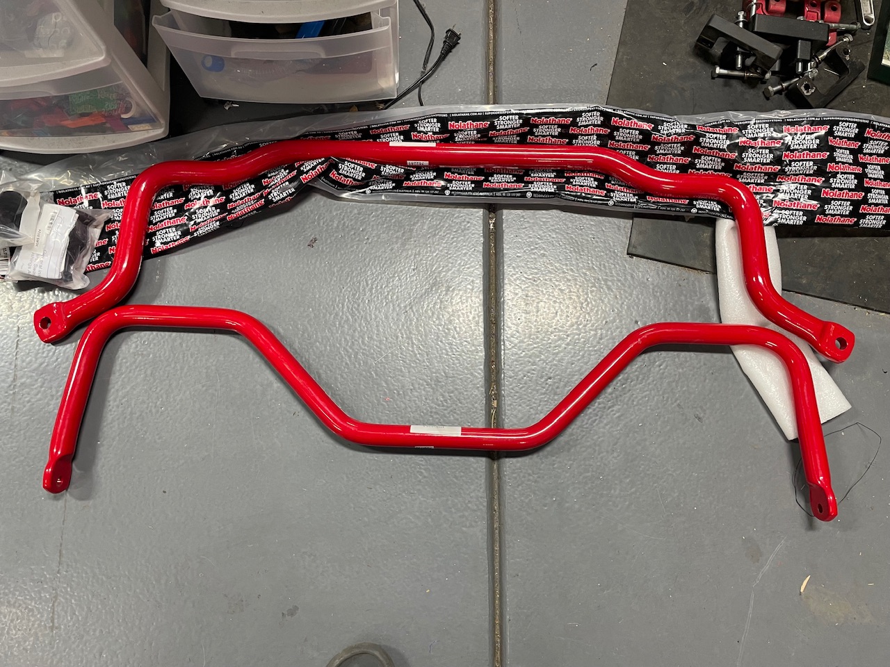

Got the Nolathane bars. Thanks to @kbuskill for the autozone link. Took just 2 days.

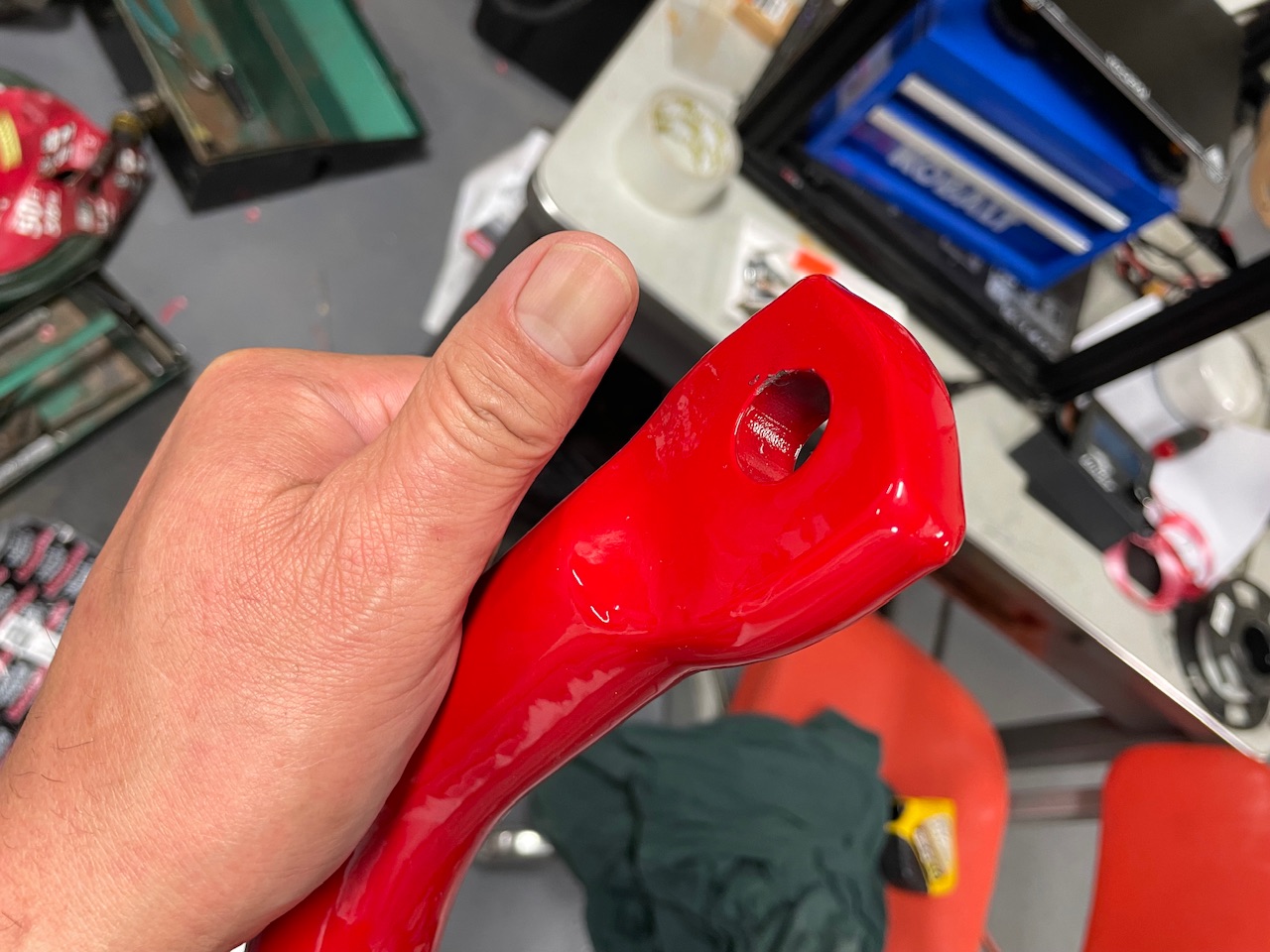

Here's the beef! 30.8 lbs / 38mm front bar, 24.4 bs / 33mm rear bar.
Stock rear bar with endlinks and rubber bushings, 12.2 lbs. / 28mm
I'm worried these will break something! Front eyelet 5/8" thick..
Here's the beef! 30.8 lbs front bar, 24.4 lbs rear bar.

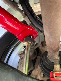

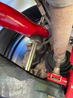

I found the end links a bit of a challenge on the front, seemed the eye is a bit of a different angle but I got it to work- just took a bit of messing around. Damn thing was heavy.

Yup.. Here they are upside down..
First try I put it in the way I thought it should be.. wrong..
Second try, a lot better, not perfect.
Thinking a shorter link might be little better.
Already compressed endlink bushings made it easier to assemble..
I could see myself struggling with fresh bushings.

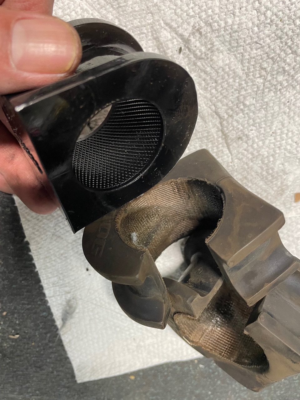

Old Moog bushings after about 5k miles. Ovalized some, seemed fine.
Pried them apart so you can see amount of wear.

Yup..
Second try, a bit better, not perfect. Thinking a shorter link might be little better.

That was my first impression when I had it installed with the long end links and it wasn’t parallel to the control arm. Install shorter links; the road imperfections you feel will be unnoticeable. As far as using new bushings- I take the big washer off and use a regular washer just to get the thing compressed, then disassemble and reassemble with the correct big, cup washer. It’s a cheat.

Small update, went to 2-3/8" energy suspension endlinks. Stock was about 3" (spacer length only).
before with newer delco endlinks.
after with ES 2-3/8" links
Looking like 2" might be better still.
The ES links use standard bolts with 9/16" socket size.
If installing Nolathane bars, one should assume shorter endlinks will be needed as Rocketman mentioned.
