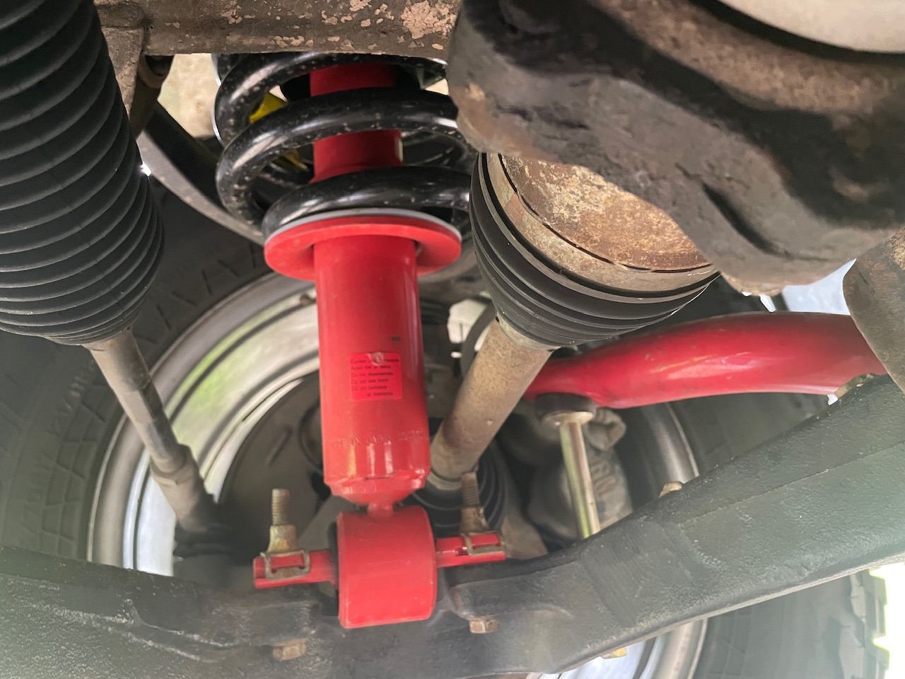

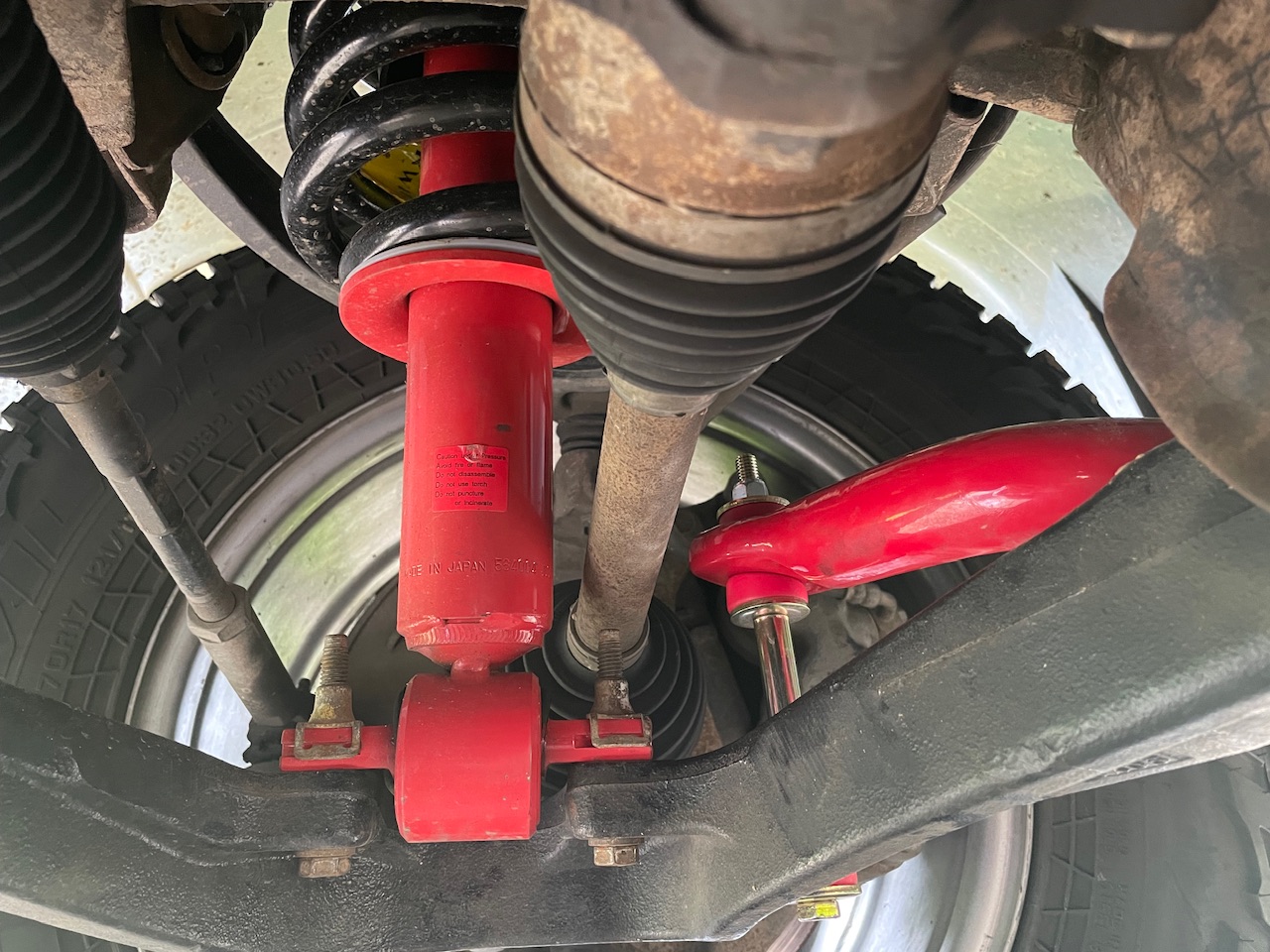

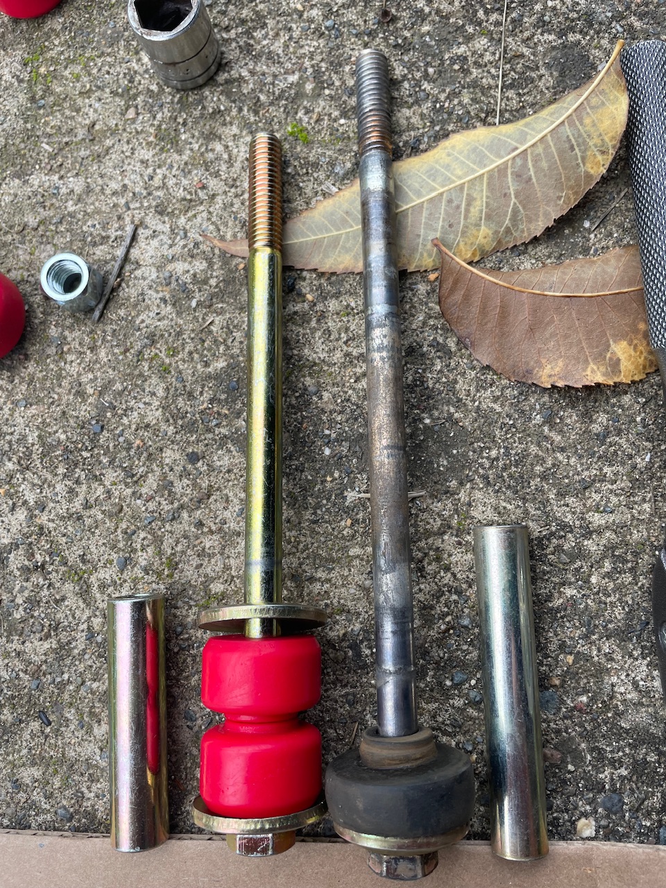

Small update, went to 2-3/8" energy suspension endlinks. Stock was about 3" (spacer length only).
before with newer delco endlinks.
after with ES 2-3/8" links
Looking like 2" might be better still.
The ES links use standard bolts with 9/16" socket size.
If installing Nolathane bars, one should assume shorter endlinks will be needed as Rocketman mentioned.
yessir. I still need to dial mine in. I think I ended up with too short of ones. sure would be easier if I had a lift to get measurements.
