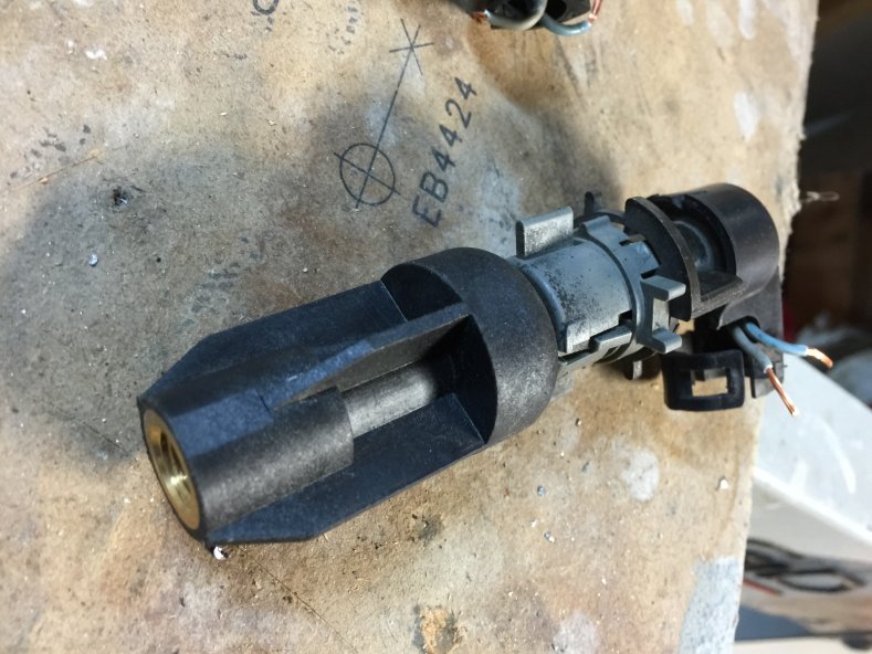

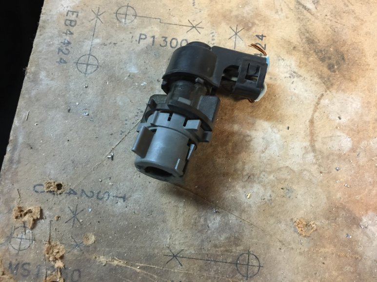

Front is different fitting. Open hood you will see harness laying there above shocks
52,956
popo this is the front connector for the autoride. The module attached to it is the Arnott bypass resistor which I removed and replaced with 3.9 ohm 25 watt wirewound resistors soldered into the wires. The Arnotts kept failing. The connectors should have attached to the tops of your stock shocks. They're probably tied away somewhere now.
