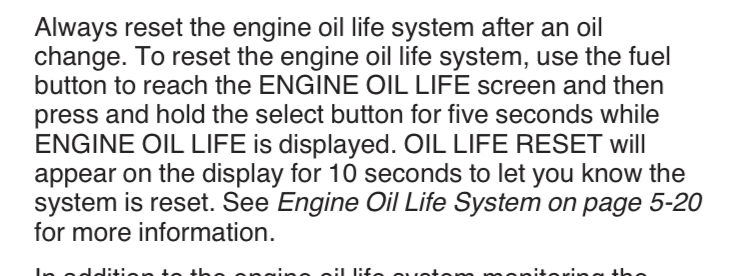

I can not reset the oil change lite, I press the gas pedal 3 times fast after turning the key to run position, I even tried 5 times and stomping the pedal 3 to 5 times, it still won't reset. I literally had the oil changed twice in 1 week, the second time was a mistake service by pep boys wen I ask for a fuel filter Change. I ck oil and the oil lever is fine.

Don’t think you reset it by hitting the pedal.

both ways works for my truck. just did the pedal reset a couple weeks ago on my 05. it has a dic, ive re set it from there in the past as well.
if you have no dic you just turn key to run and push the gas pedal 3 times.

Just did pedal reset on my 04 just the other week. Didn't have to press the pedal too quickly. Just 3 times to the floor within 3-5 second time span. I probably could have done it with my Tech 2, but I just got it and it was quicker to do the pedal reset procedure.
