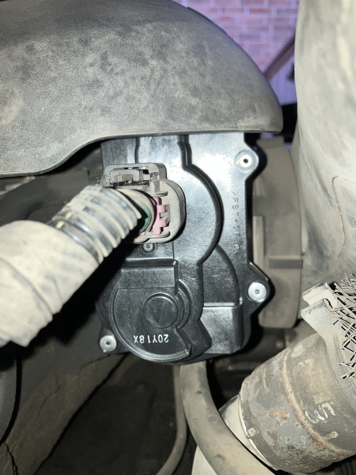

When
OP wrote "“low engine power”...Did you mean reduced engine power? If so this is a clue and usually means you have the dreaded broken wires at the throttle body for the fly by wire. A wire breaks in that harness and you will get that reduced engine power along with just above idle max throttle. The throttle will NOT respond to you at all. A replacement plug with wiring pigtail is available and is a normally stocked item in most auto parts st
OP wrote "“low engine power”...Did you mean reduced engine power? If so this is a clue and usually means you have the dreaded broken wires at the throttle body for the fly by wire. A wire breaks in that harness and you will get that reduced engine power along with just above idle max throttle. The throttle will NOT respond to you at all. A replacement plug with wiring pigtail is available and is a normally stocked item in most auto parts stores.
When they replaced the throttle body, it also had a new module to plug into and they checked the wires.

Thats the typical culprit...but that problem will produce a "reduced engine power" on the cluster and the engine RPM will default to around 1000rpm no matter what your throttle input is. If you were just having stalling problems then I would replace fuel filter AND the pump, esepcially when the volume test was low.
