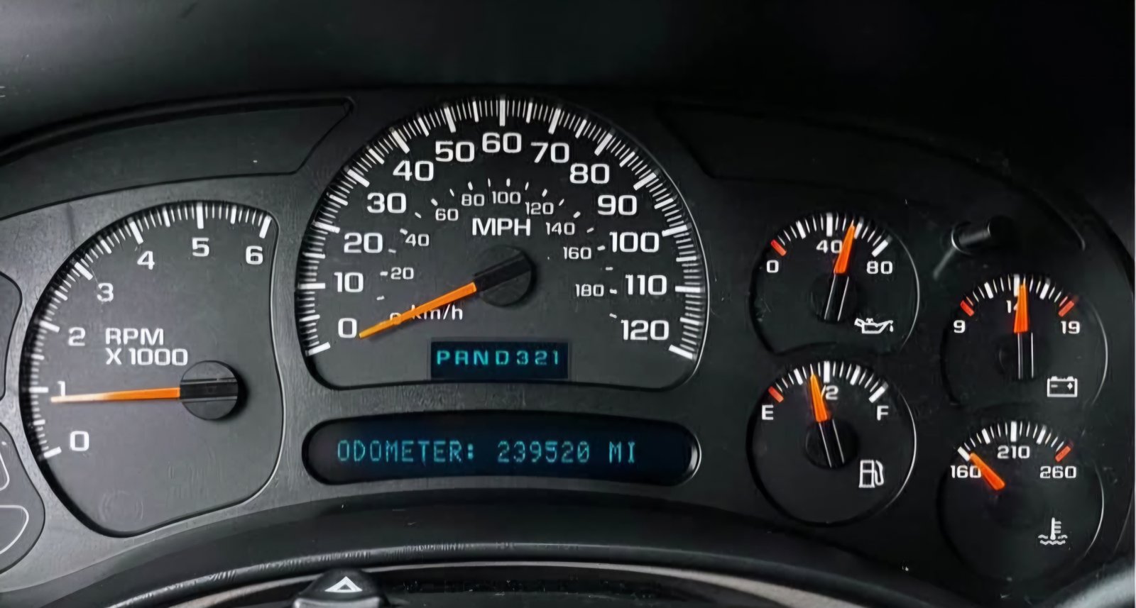

I'm looking at buying those relatively clean 04 yukon xl with 239k on her. UT the idle rpm seems high. Around 800-950 and thr idle warm oil temp is 55psi. Every pocket and video the guy has sent me it looks like this. Engine sounds. A it loud too while the hood is open. I haven't gone to see it yet because it's an hpir and. Half away. Oil psi on these is crazy. Is thay idle rpm and oil psi even normal or good?

That's a defect in the gauge's stepper motor.
Is it a problem? Is it causing false readings as well? What do you think of the 2004havinf thr 900rpm idle ans 55psi of oil pressure at idle?
