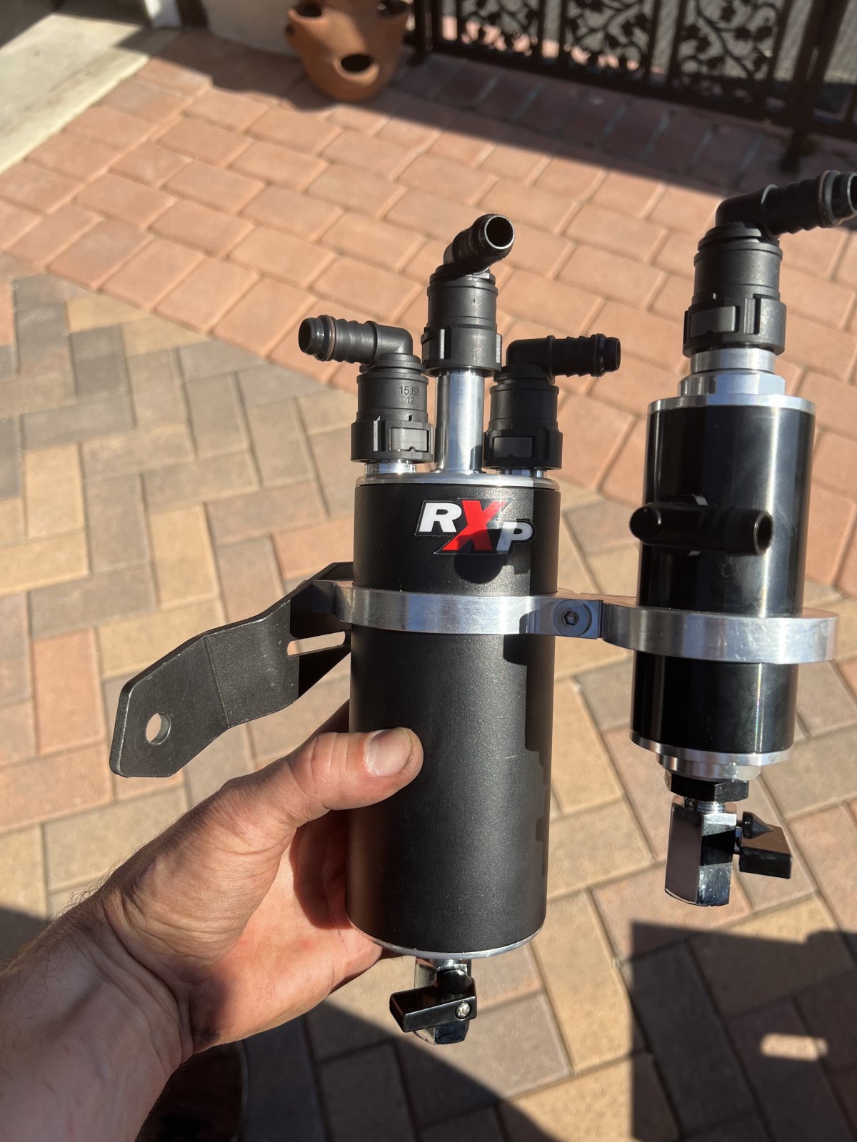

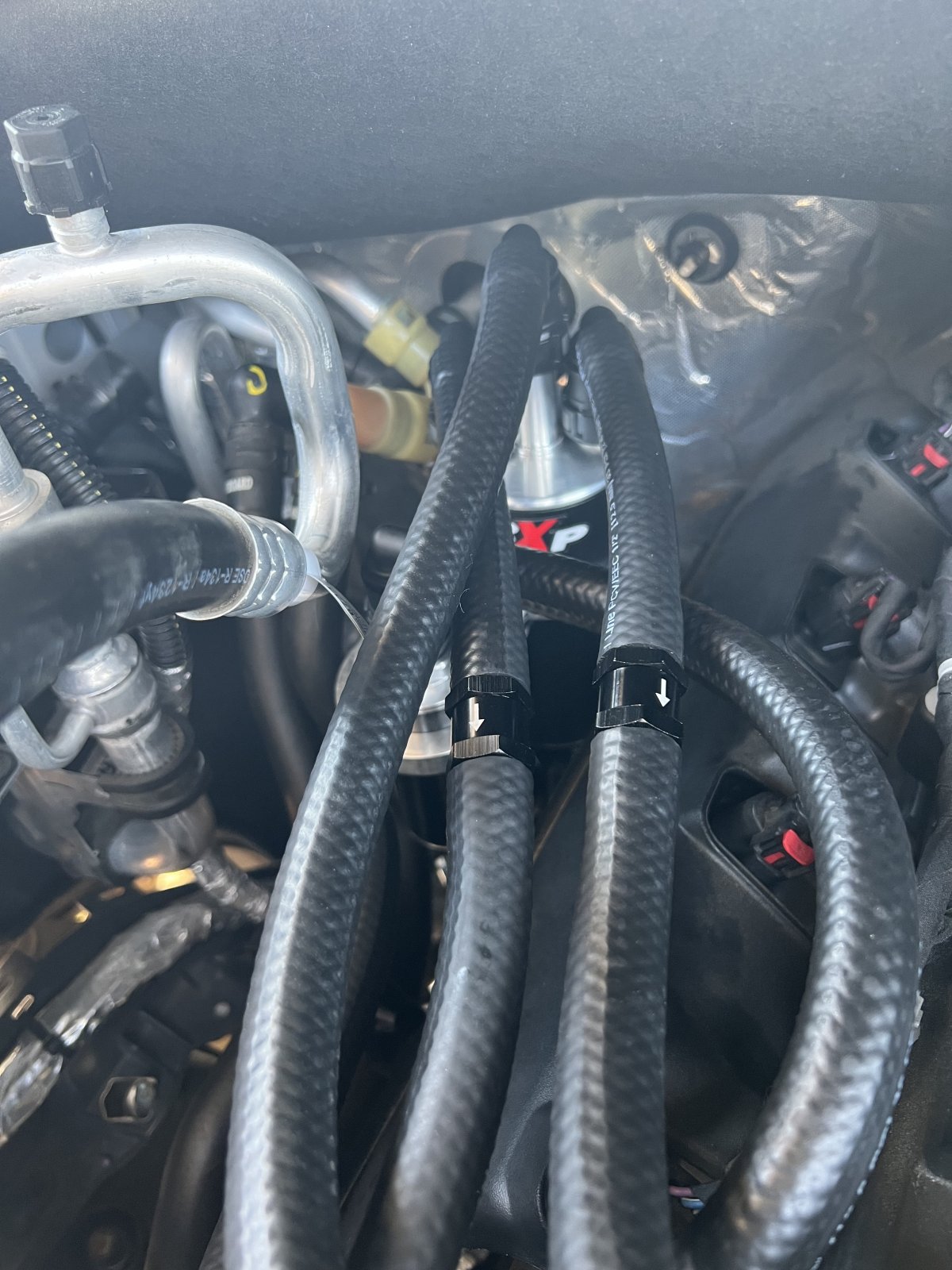

I recently installed a Team RXP Catch Can system. It’s a dual can system that catches both the passenger manifold and intake side and the driver side.
