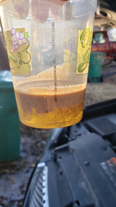

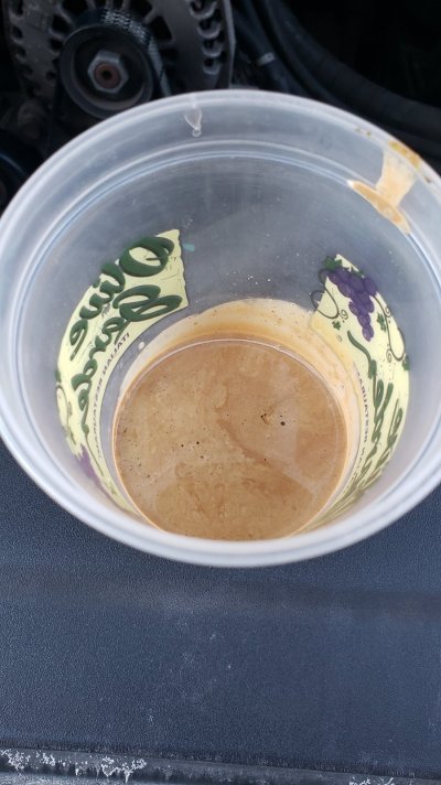

I just emptied mine. I empty it at oil change and halfway through the oil life monitor.
It's been 4 months (Oct. 10th) and 2410 miles since my last oil change. I do 5000 mile oil changes. Oil life monitor is saying 48%
This is a kids Olive Garden cup. The bottom half of what's in the cup is water..... 20220220_164201.jpg

I don't know?? We use our Denali to run back and forth between TX and the CO mtns in the winter and spring where it's cold. No condensation.
Trailblazer may have a leak allowing moist outside air into the crankcase and he has stuck rings. IMO, that amount of oil and condensation is unhealthy evidence.

The catch can doesn't "pull out the water"
Usually when the engine gets up to operating temperature any condensation in the crankcase will boil off into steam.
Constant short trips, where the engine doesn't get up to operating temp, will not let the water boil off and the oil (and under the oil cap) will look milky.
In the colder weather, the catch can will get condensation inside it just because it's away from the engine and has cooler air around it and then gets hot oil vapor ran through it from the engine. The temp inside the catch can will not get hot enough to boil off any moisture and it gets stuck inside the can. That condensation inside the can will mix with the oil that has been caught from the engine and cause it to look milky.

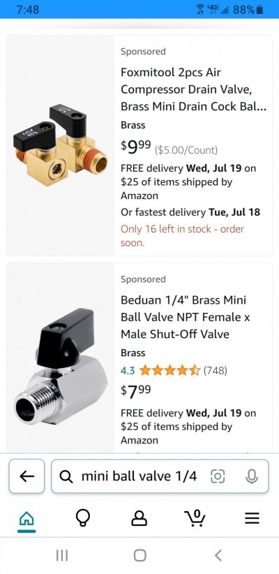

My can came with a petcock style valve that screws out. I replaced it with a ball valve style.
1/4" available at Home Depot by the air compressor accessories
Or if you don't like the long handle, any 1/4" mini ball valve on Amazon will work. I used a mini style one on the old catch can I had.

Did that size work for yours? those valves seem small compared to the one i have, but im getting pretty tired of the oily water puddles. i want to say mine needs a 3/8" valve
