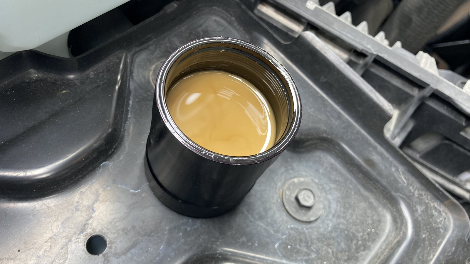

Last oil change was about 2k miles ago. Truck gets a lot of remote-start time during the winter but we don’t really drive far with it as this ‘09 Tahoe has been replaced by a newer Yukon XL. I just drove 350 miles to visit family and this is what came out. This is the most I’ve ever seen since installing this can a couple years ago. It came out as a very very light trickle. I walked away for about 45 min to find this!!

Nope; I believe the production date was about a month before they made the change. Looks like a fun project for the next owner. I’ve just never seen it this bad before. I checked the oil level and it’s at 3/4 off the hatched area. Must just be a shîtload of water. I bet the throttle body has a small lake past it.

It's winter time, condensation happens, even just in the can when it gets hot engine vapors inside it and it's cold on the outside.

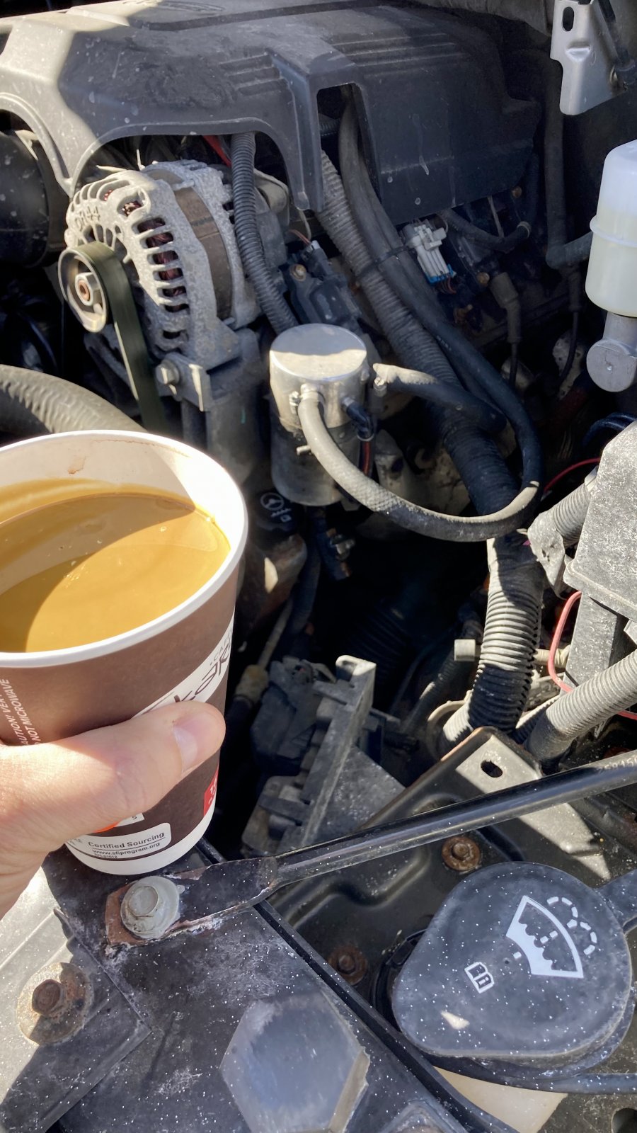

This is a big can; that’s a 16oz coffee cup in the photo. I should have this dump into a 2L bottle. I recently installed a UPR kit in my 15’ Yukon and that comes with a tiny jar. Hopefully the ‘15 vintage 5.3 has the provisions to not allow such a ridiculous build up of moisture and oil.

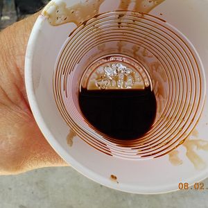

We have a smallish catch can. Holds about 8 oz. We get about 2 oz every 10,000 miles from it. Doesn't have h2o in it, but smells like gasoline.

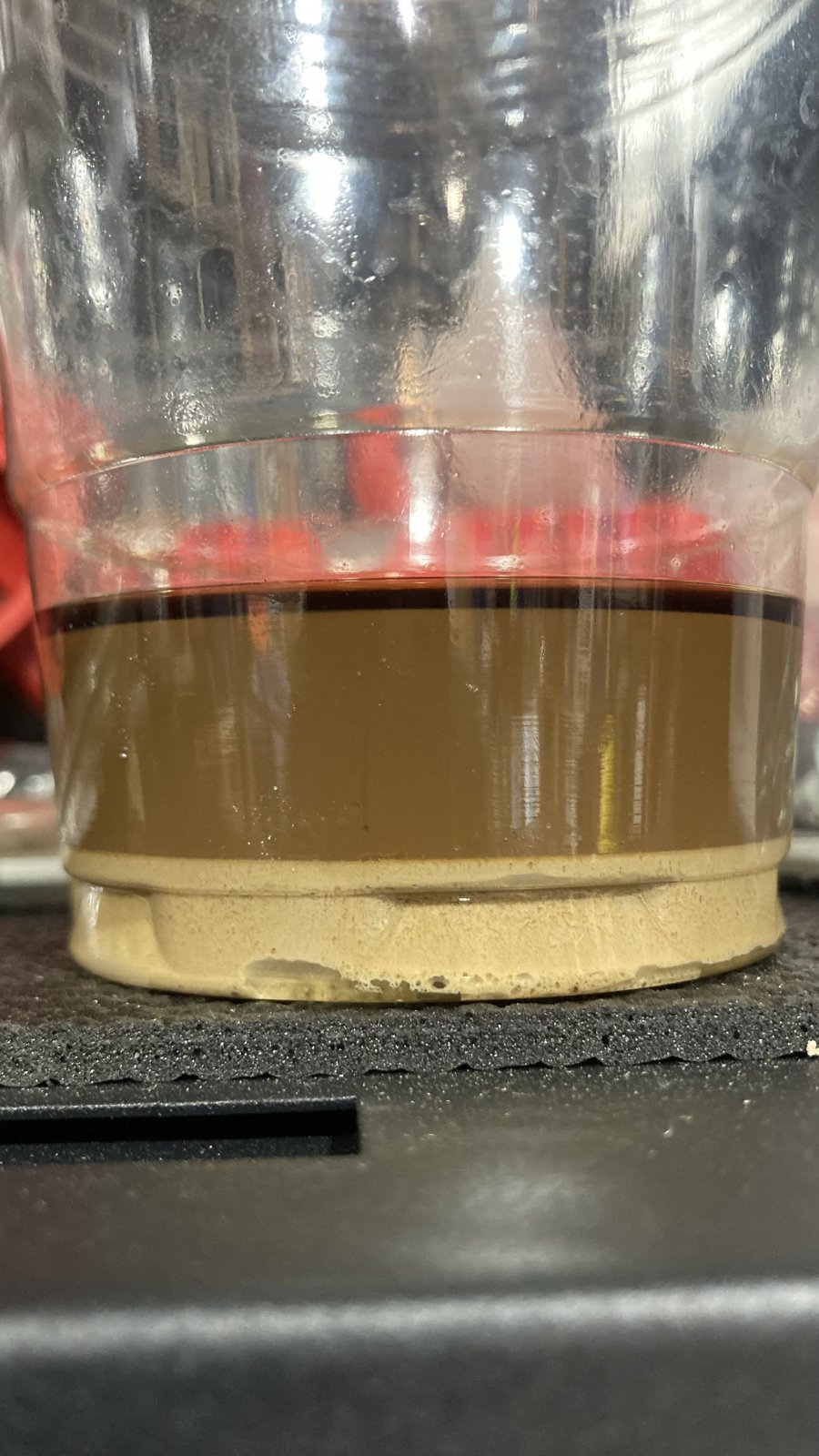

Here it is separated after sitting since Sunday evening (I just took this photo). Odd layers of oil and two types of emulsion. Looks like chocolate syrup over a latté.

Does anybody else here get this in their catch can ??? I certainly don't. I posted a pic previously here.

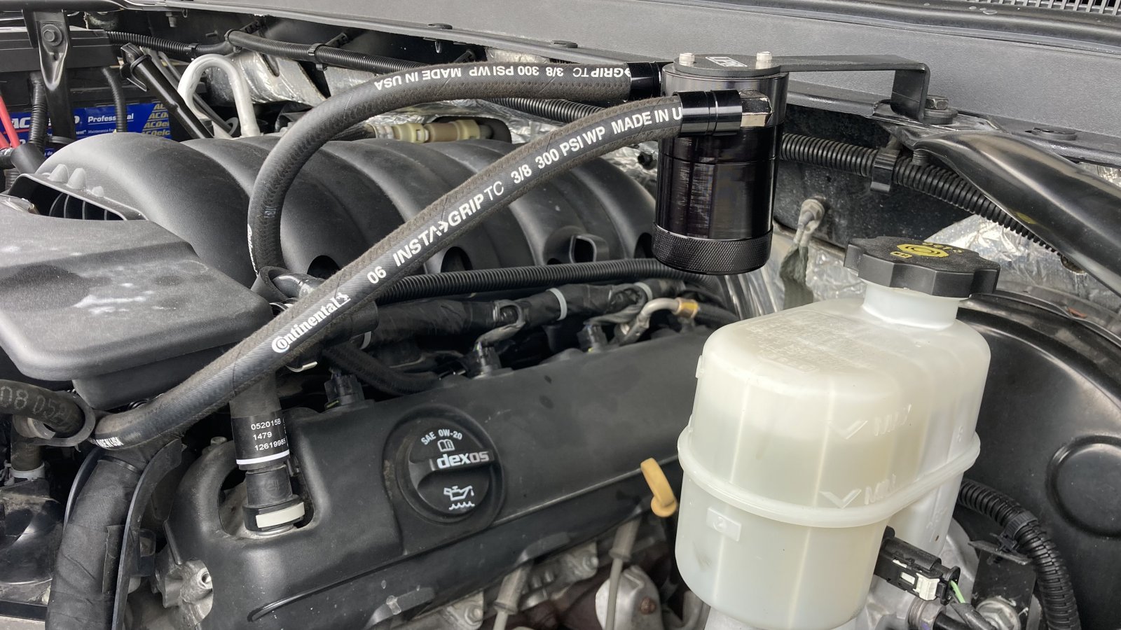

This is the first time I’ve checked the new catch can in my 2015 Yukon XL 5.3. It’s FULL after about 1000 miles! Lol. I’m going to mod this like the one in my ‘09 to have a dump valve on the bottom. Unscrewing this was a hot mess. It’s easier to just turn a valve and drain into a cup.

I really wonder if I could just drill & tap the bottom of the cup (probably install a quick disconnect nipple) and have that connect with a hose to a bigger simple container that can sit on the battery box. Like a gallon of milk or Amsoil 4qt jug. These catch cans are in vacuum, correct? If so, then I’ll have to keep it from venting when the engine is on. I know that the manufacturer of the Yukon’s aluminum catch warns that freezing wx could cause their cups to crack open if not emptied. I just don’t want to dump this thing every few days.
In the winter time when it's cold out the oil in my can will be that thicker light brown color only because of condensation.
My can doesn't get that full though. I empty it at oil change (5k miles) and once halfway between oil changes and it only gets maybe a shot glass amount each time.
