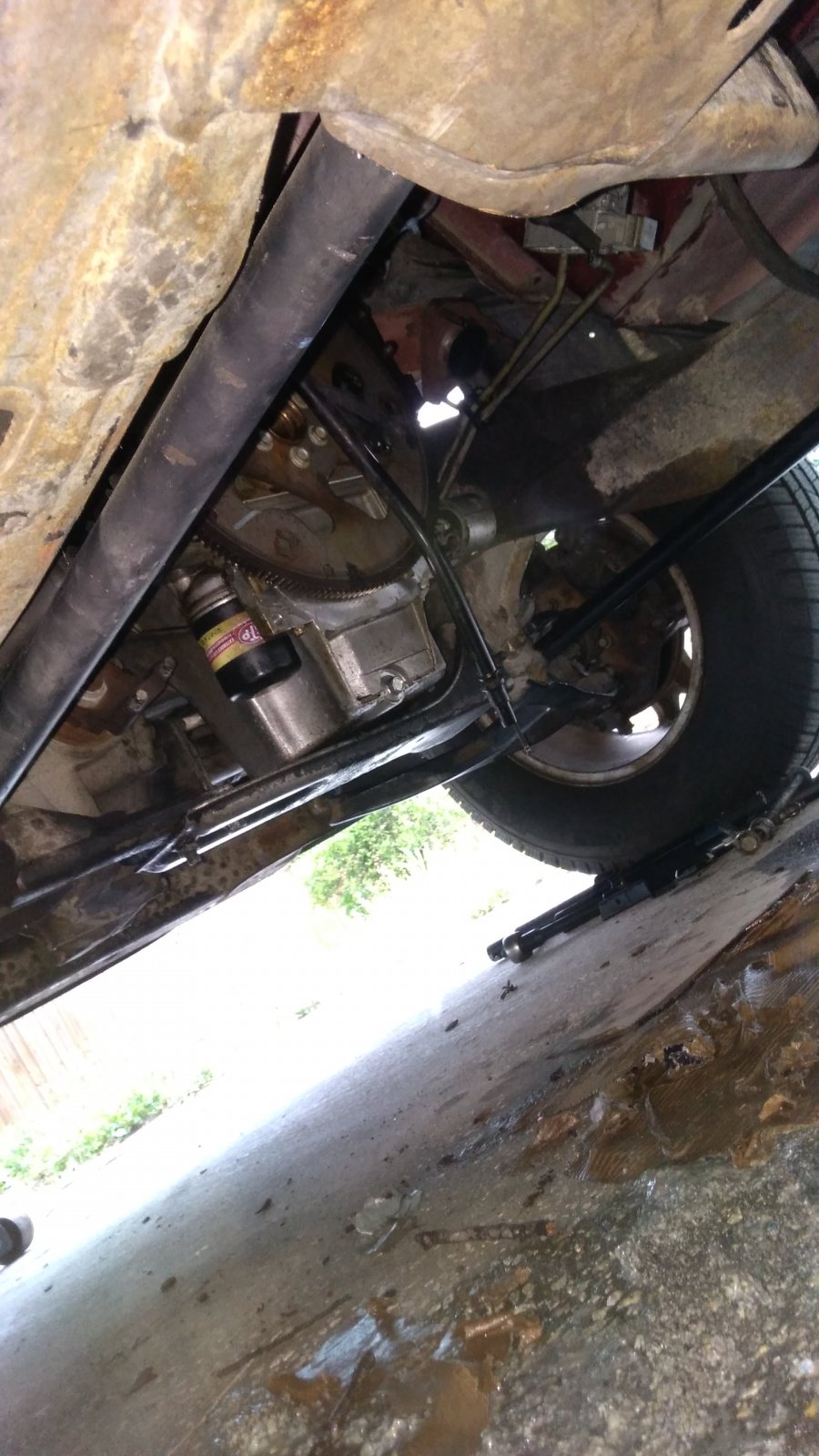

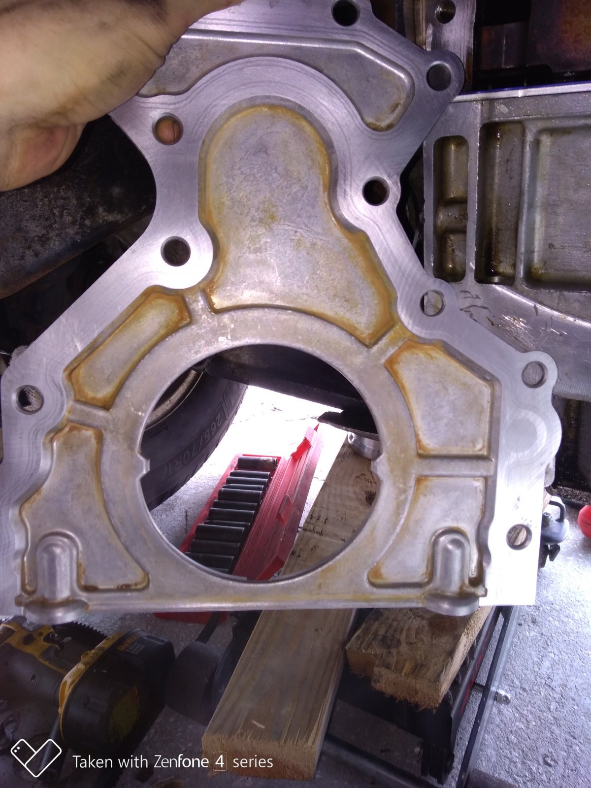

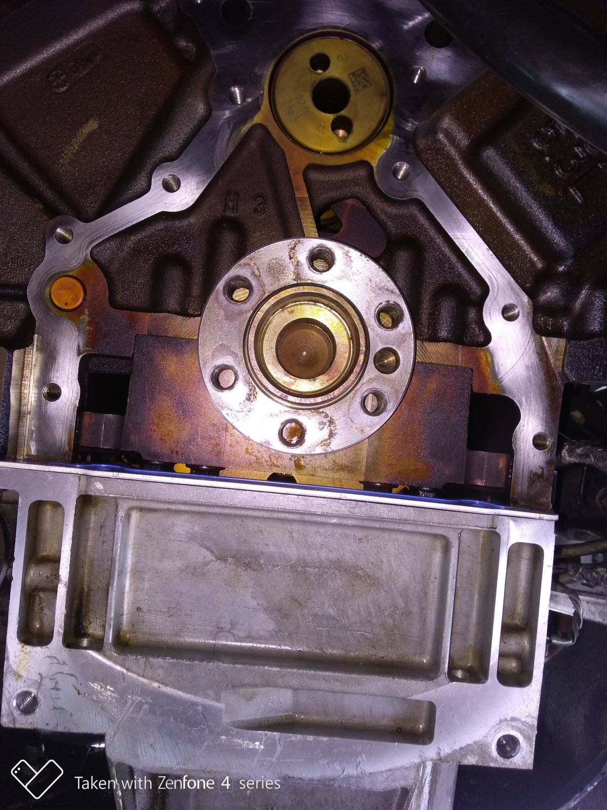

Update, I just finished dropping the Tcase, am fighting the torque converter bolts, I've disconnected about everything. The hardest thing so far has been removing the exhaust bolts, Snapped one the rest were tough to get out without any penetrating oil, but I managed to get through. My jack fits the oil pan perfectly, the good thing is my engine leaks a lot so the bolts were pre soaked for me. Funny thing is the flywheel looks dry from the plastic access panels. I can tell the rear cover is done though, looks pretty wet. Crankshaft sensor was bone dry, I might post pics some time. It's raining so I had to stop, I might not have time til the weekend but we'll see.

It's off! What a pain in the butt it is to get these things down! My rear main has a slow leak, so does the cover. I haven't taken the flywheel off as of yet. I will look at those things this weekend, Weird thing I found was the the driver side is covered in oil half way from the head to the bottom of the block. The other side was spotless, and the only leak I could see was from one of the main caps side bolts, I will reseal those when I get to that. Now I thought about rebuilding just the pump, as the trans has low miles, but I will just save me the headache and buy a reman one, that way I just pop it in and call it a day.
