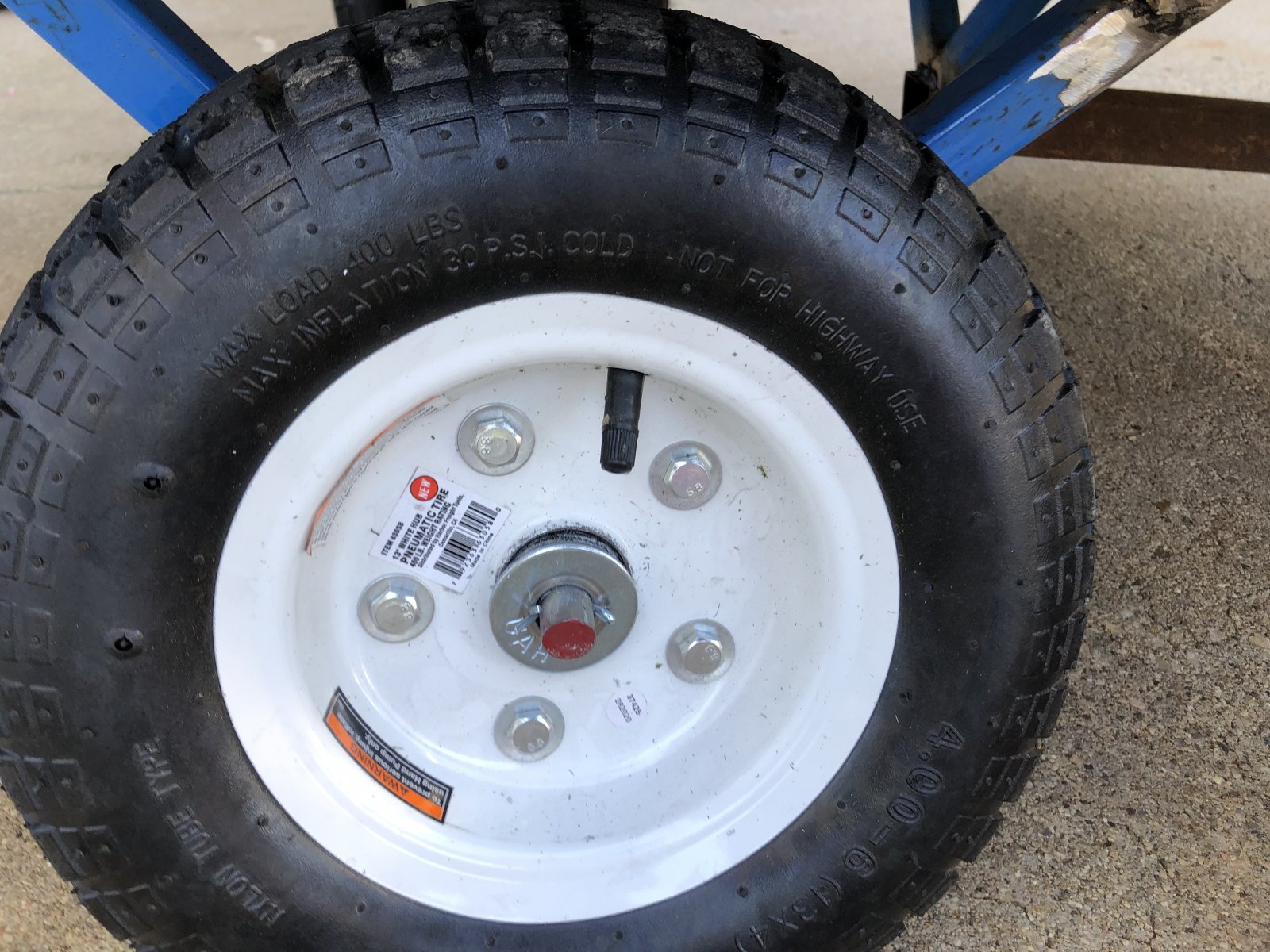

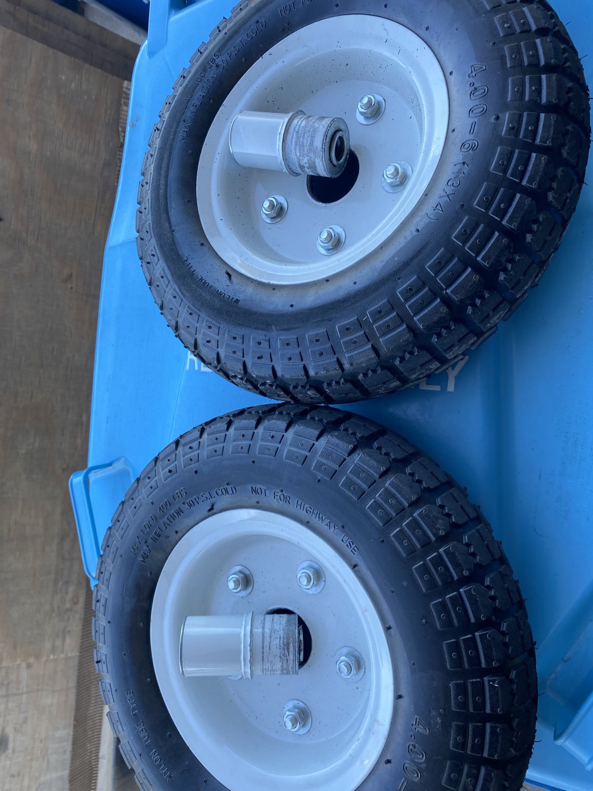

A little update. Took a chance on using some Harbor Freight wheels that said they were rated for 400 lbs each. Guess that was a lie. Got a call from Joseph saying the wheels broke on his little trailer. Said he thought the bearings worked themselves out of the hub. Nope! Whole hub assembly separated from the rim on both wheels! Was able to buy some better wheels with a better design and get him back up and running again last night.
View attachment 278687 View attachment 278688 View attachment 278689
OMG what pieces of crap! o_O

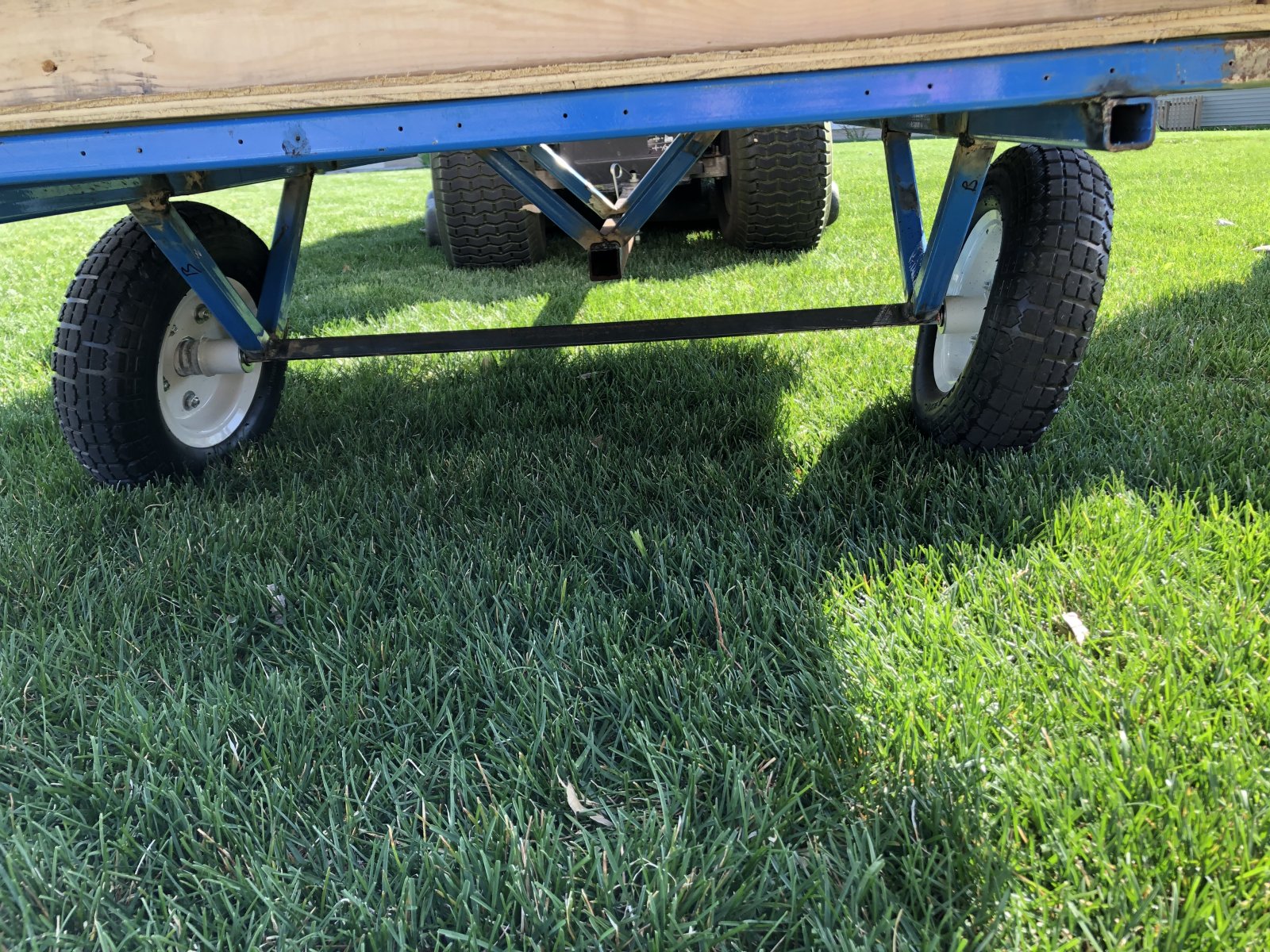

Have had to shift from auto mechanic work with Joseph to trailer fabrication. Joseph wanted a flat bed trailer to pull behind his rider so he can haul a push mower and other lawn care accessories as he runs his lawn care business. So we have been working on making one out of some scrap steel I was able to get from work. Not finished yet, but thought I’d share what we’ve got accomplished so far. I’ve been doing the welding and he is getting the hang of cutting and grinding. It’s been a fun father/son project. Once it’s all fabricated, it will be painted red to match his rider and get a wooden deck with some side boards.
View attachment 277400 View attachment 277399 View attachment 277401 View attachment 277403 View attachment 277402
I missed this awesome cart build!!!
Super clean break. Clearly a welding fault. Probably done by the same people or equipment that built their jack stands. They should have a 90-day warranty on them so you could get your $30 back. Or keep them to re-weld (another father-son teaching project) or mount to separate hubs. This would at least prove valuable to Joseph as a lesson that an unwise dollar saved could cost many wise dollars elsewhere.
Yeah-they are going back for a refund/credit. It’s a poor design having the hub only welded to one half of the split rim and then a poor weld job on top of it. Went with different wheels that have the bearing pressed onto both sides of the split rim.
