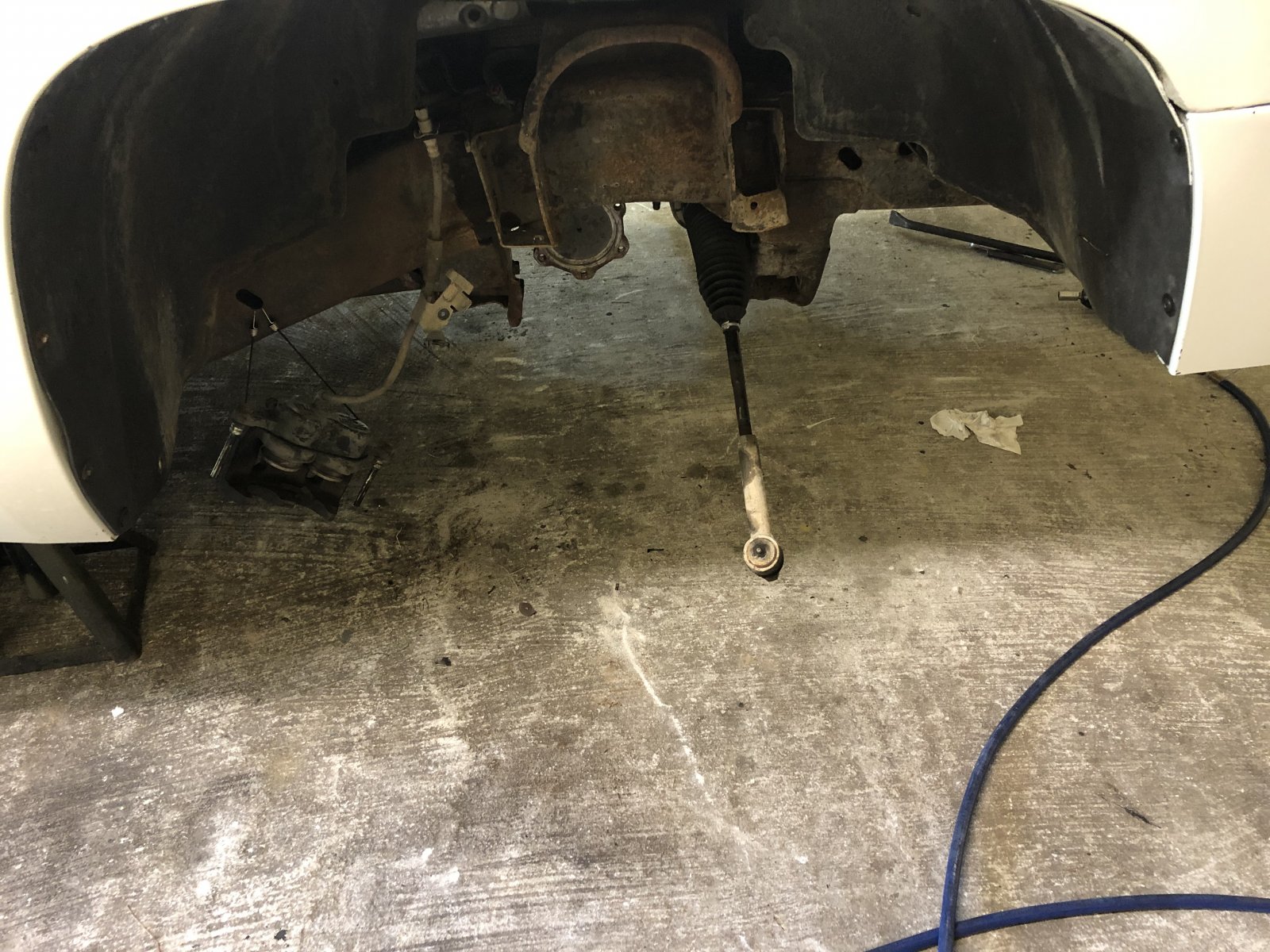

I spent the morning measuring and recording all the ride height, track width, alignment values before etc. Took a bunch of photos in case I need to refresh my memory on anything later.
The afternoon I removed all the front suspension and differential. Nothing rusted in place, seized, or challenging. Found a Rio Grande river rock on the skid plate.

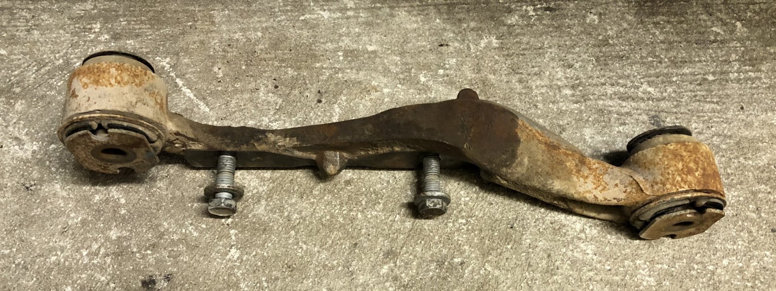

The first unplanned replacement. I discovered one of the bushings in the differential carrier had debonded and was floating around. Since the 35” tires will be adding more stress to the front diff mounts I decided to replace both driver and passenger side diff carriers, rather than just the one bushing.
The local dealer had them in stock. Which makes me think it’s a commonly failed part.

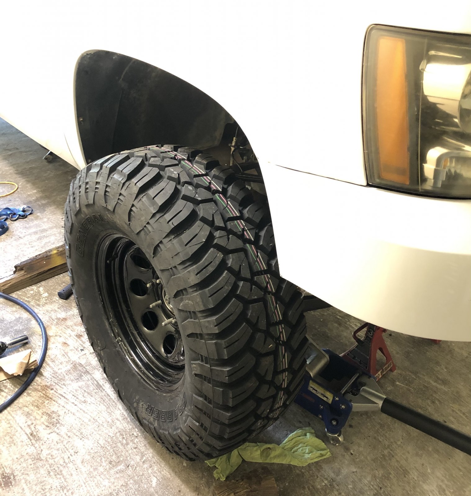

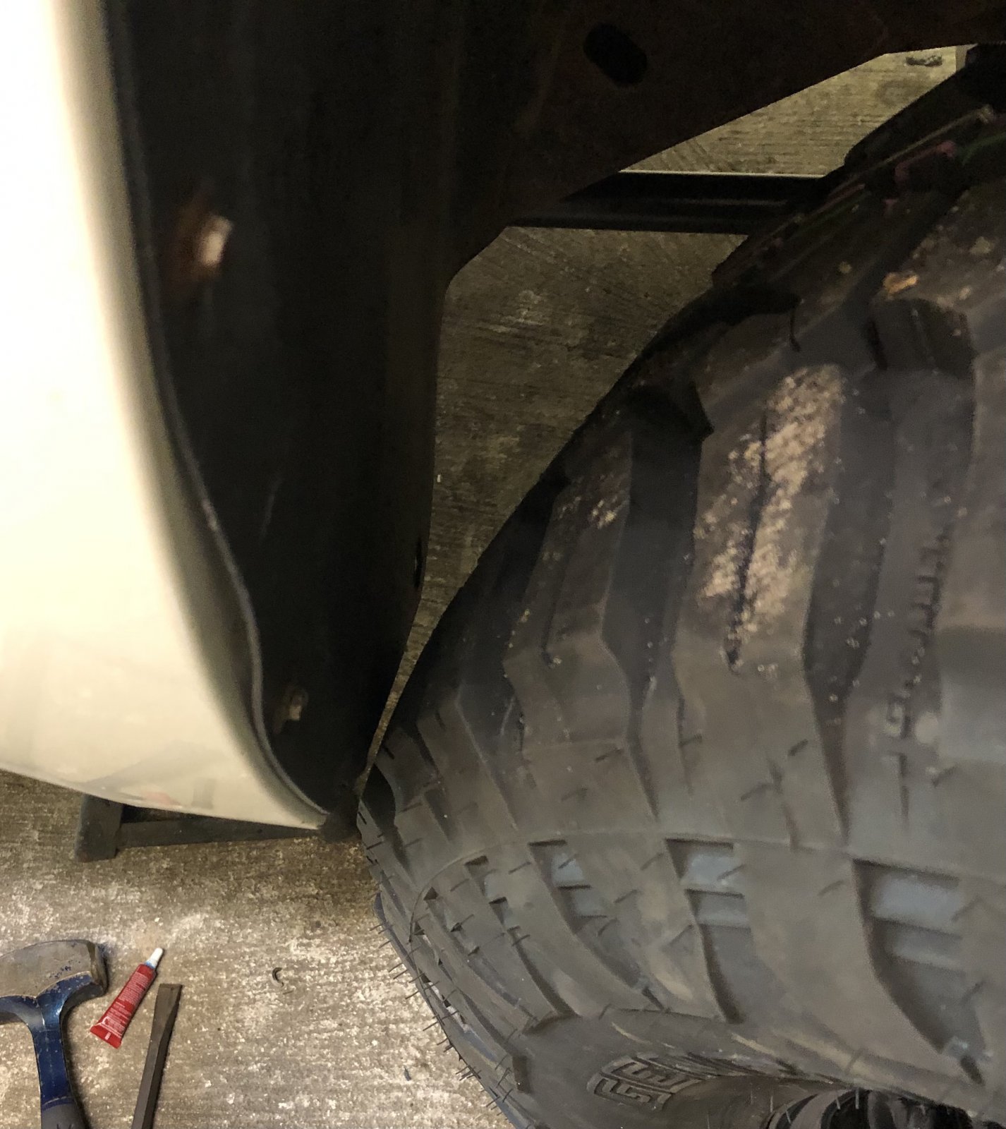

Got the RF done enough today to test fit a wheel and tire. I’d like it better if the tire were less outside the fender, but it’s not gonna happen; only 1/2” clearance now between the tire and the tie rod end.
35/12.5/17 on ProComp 17x8 -6 offset.
Barely clears at the rear of the wheel well, but I’ll be doing a NorCal trim there.
Today was just to verify the choice of wheel and cycle the suspension to check for issues. The brake hose is a little shorter than I like at full droop and lock, so I’ll be getting some stainless for that. The CV’s are okay at max droop and lock, although it’s obvious they don’t have much more left in their range of articulation.

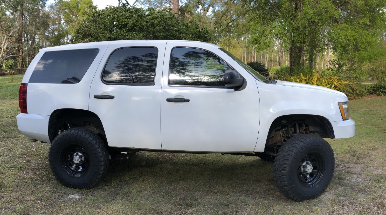

Back on the road again. Got the seal of approval from the passengers. I’ll take some more pictures when the lighting is better.
Initial impression; while the handling and ride is impacted, it’s not as bad as many lifted vehicles I’ve driven. I’ll need to play around with tire pressures and decide what to do about coilovers. The factory style Monroe struts are riding OK, but they’ll never handle these tires on a washboard trail.
Dang looks good and super tall with that front bumper cut! Lots of front approach angle :happy107:

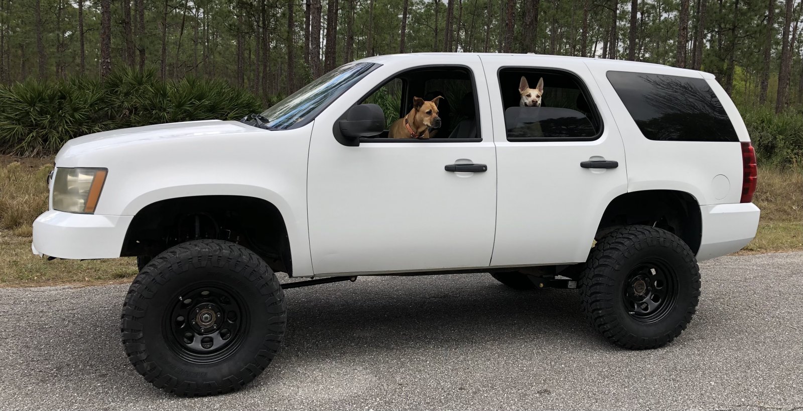

Still not very good lighting conditions, but at least it has the hub covers back on. These are a little weathered so I ordered replacements today. GM wants stupid price for a bit of plastic adornment, so I went against my usual habit and bought imitations from eBay.
I will say IMO 6” of lift or more is not a great look. Too much wheel well above the tire for my taste. I may end up dropping an inch or two from here. Or maybe not, as I DO like the clearance.

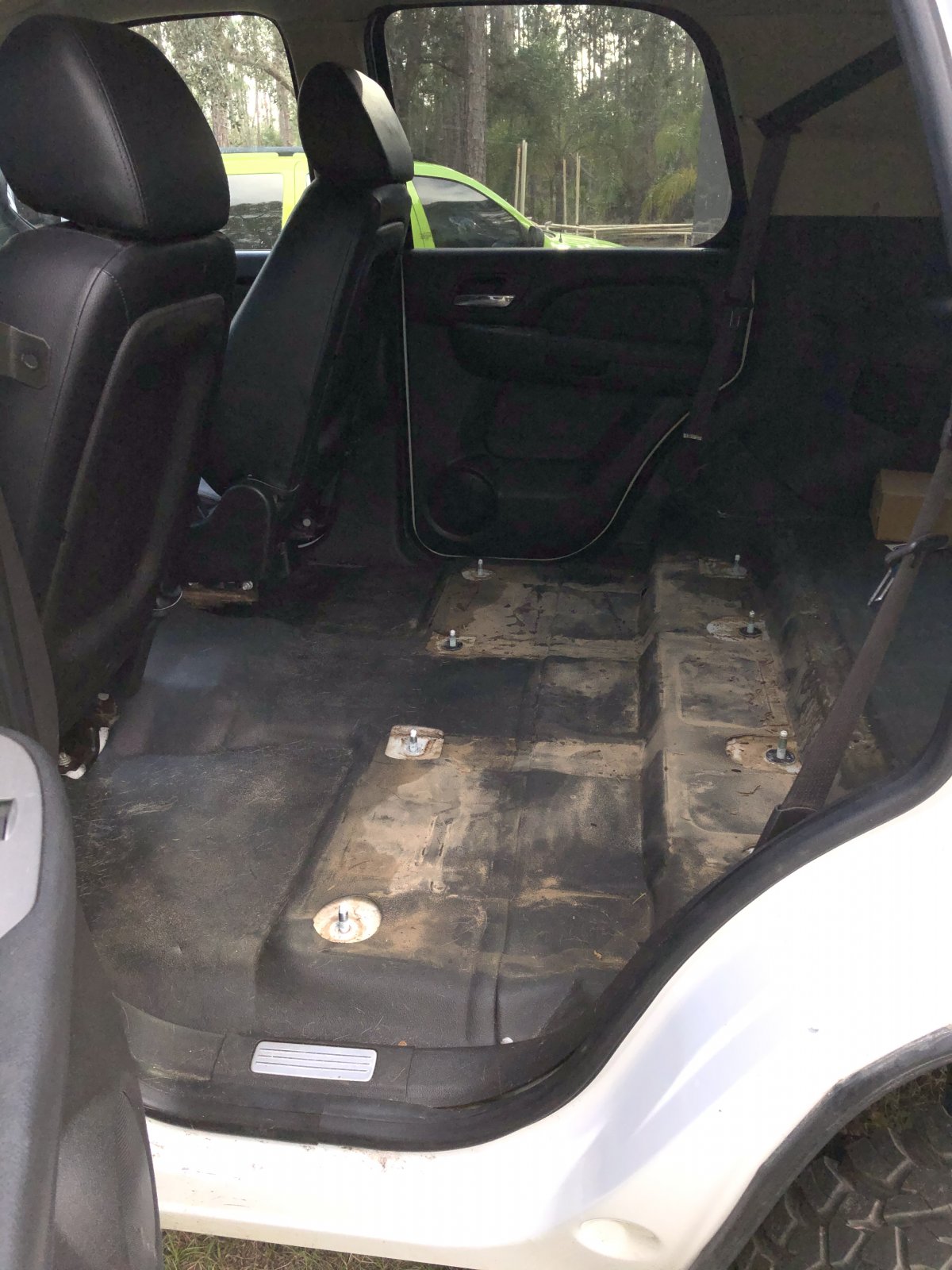

She went on a diet and became a two-seater today. In preparation for building a deck with storage.
Although I may prioritize rock rails/ steps because climbing in and out is a pain. Literally.
As you can see red Texas dust is still showing up whenever something comes apart.
@bigfootchiro I'm in SWFL. Nice looking rig in your sig. I'm envious of that 14 bolt.
Which caps are you after, the standard ones, or the PPV version? I know the PPV caps are$120 each. Between the twins I have three sets of wheels and 2.5 sets of caps.
