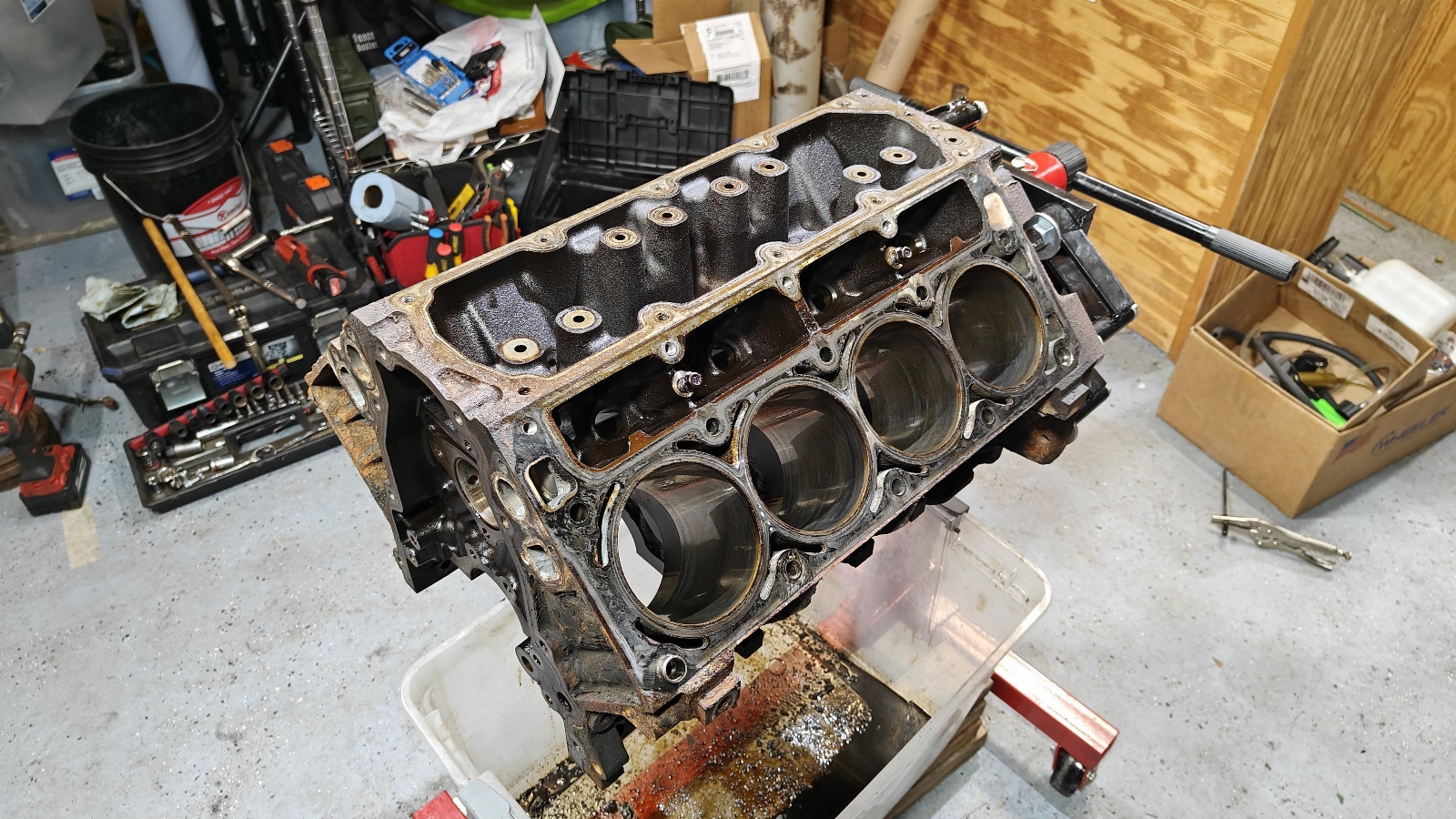

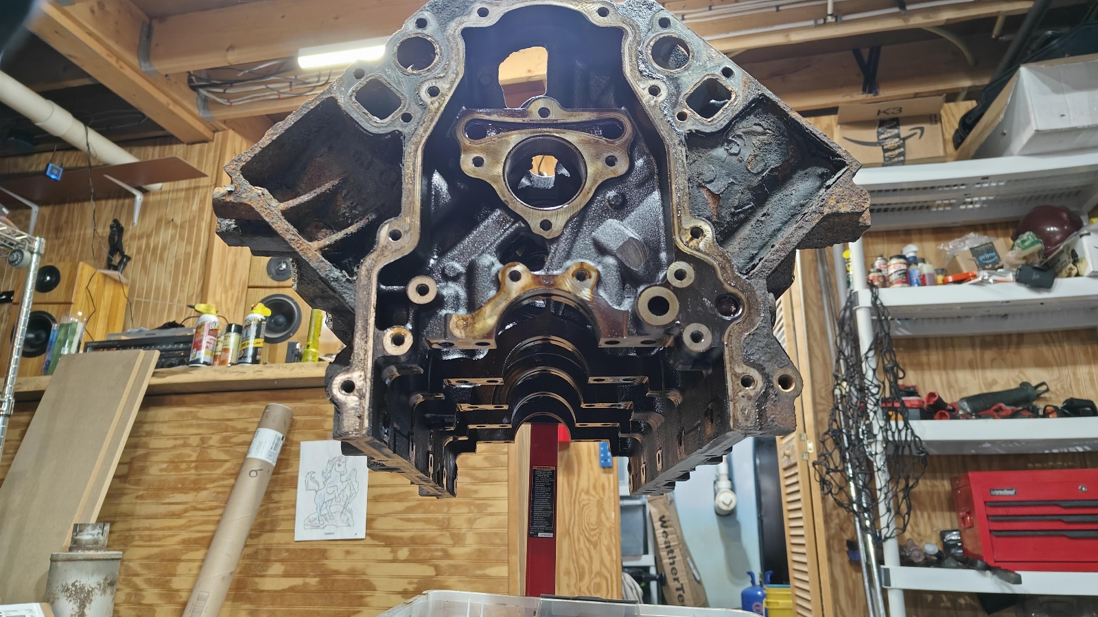

So this was a non-DOD engine (allegedly), and I was curious if there should have been AFM oil passages. That's what those are, right?

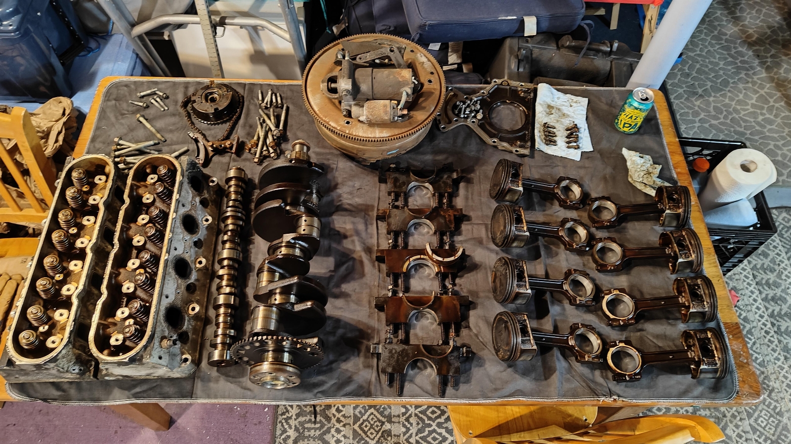

Now THAT is a satisfying picture for my OCD. Everything is in order, and you kept the rod bearings and caps together because they're neither reversible nor interchangeable. Nice.
And, after a trip to the machine shop, those parts will look like brand new.

Precision, PLEASE.
The block has Engine Half@$$ for sure.

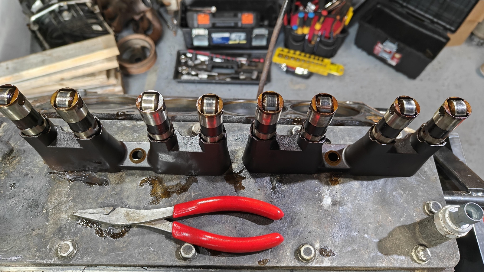

Were all the lifters the same, or were some of them Half@$$ lifters?

Here are the photos of the lifters, as I pulled them from the block:

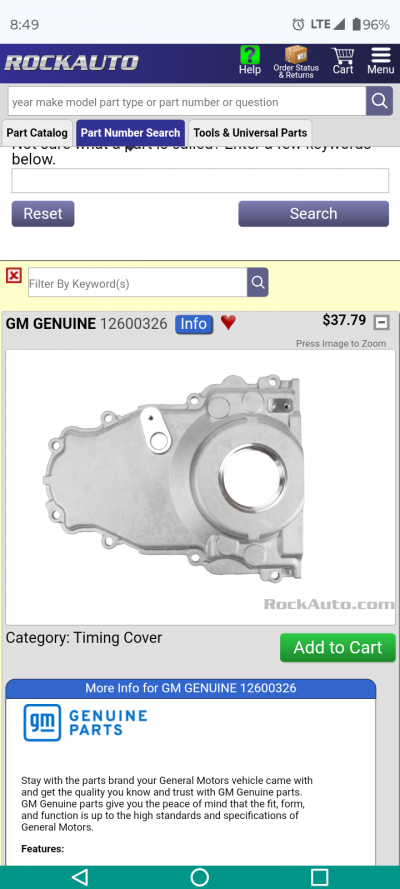

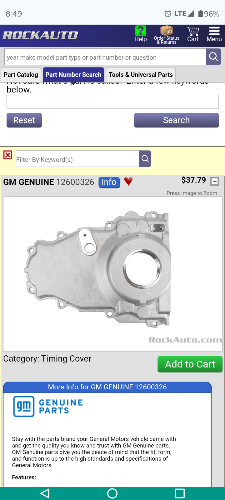

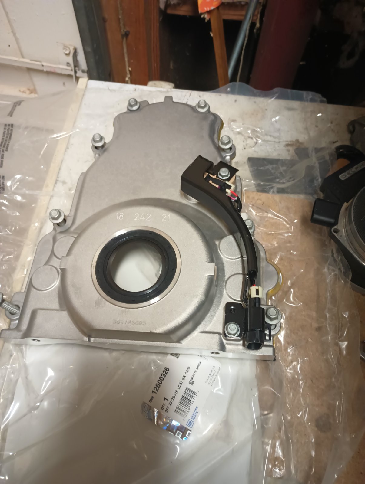

If you opt to delete the VVT: I bought a GM Genuine front cover (LS2 from a 2005 Pontiac GTO is I think what I used from RockAuto) for another engine I'm building (L96 block with 24X reluctor and Gen III electronics).
I was surprised that the cover came with bolts, seal/gasket and sensor. It was like $58, including shipping. The photo on the website only shows the aluminum cover.
Here's the part number:
I want to say the cam connection changed between the 2 generations of engines (?) I think the wires need to be repinned, but don't quote me on that. I guess you can just swap your sensor over and get a 4x cam sprocket.
Yeah, send me that part number if you can find it, and I'll take a look.

@Charlie207 The part number can be seen on that photo I posted. It's GM Genuine 12600326.
