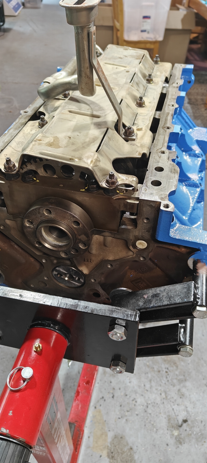

if you have time, I've heard even millings thinks adding the 2nd bolt to the pick up tube is worth while. the interview I was listening to thou it might help with all the o ring failures when they get old.
I actually bought one of those "Y"-shaped clamps to thread into the unused hole on the oil pump.

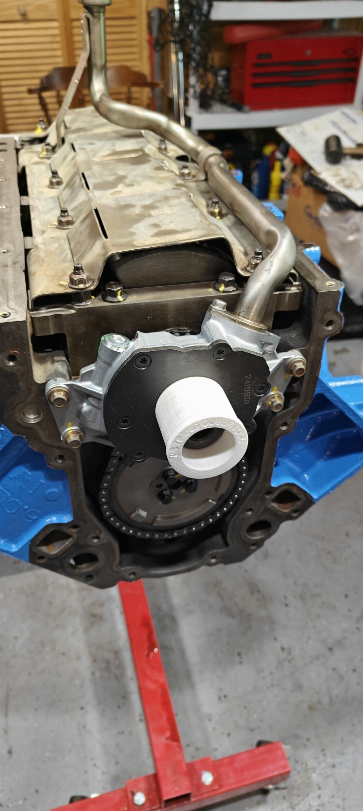

Decided to fire up the kid's never-used 3D printer, and make a front timing cover alignment tool, instead of paying $30+ for an aluminum version. I was thinking about just using the new harmonic balancer to center the cover, but this seemed like a fun little project.
It needed about 10 minutes of sanding to get the ID smoothed out (the kid's printer probably has the opposite of a high-resolution nozzle, so a couple thousand & rough) so it would slide down the crankshaft with a little lube, and not feel like it was going to break apart.
Just waiting on the additional oil pickup tube clamp, then I can seal up the bottom-end.

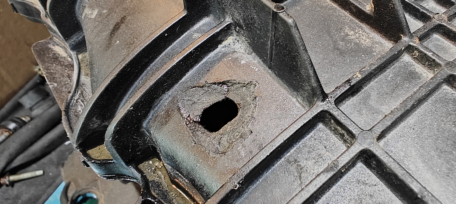

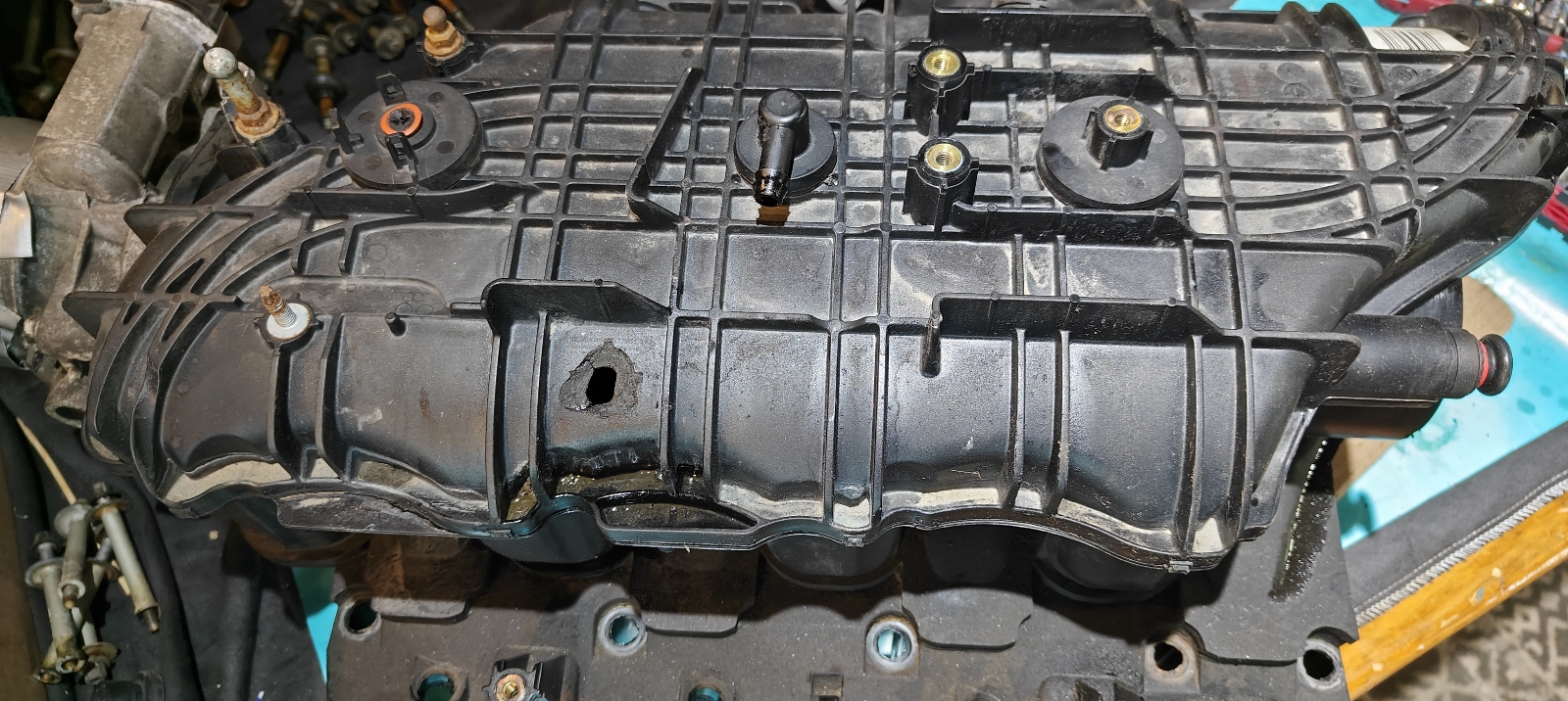

Finally started thinking about the top of the engine, and discovered this gem on Sunday... there's a hole in the top of the intake manifold that was covered up with a piece of tape. Not sure how I didn't notice it before, but in my defense I pulled off the manifold and put it in a box with the hardware when I first got the engine in my basement, and haven't thought about it since.
You can see the tape covering the hole in this photo from the middle of March.
Up close:
I spent a while reading up on how others have dealt with this issue (holes and/or cracks), and the material is glass-fiber reinforced nylon (PA6-GF30). There's some plastic epoxy that you can schmoo together and build a plug to seal it up. Or, you can buy a nylon spatula, and cut out a patch to either epoxy or melt (with a sufficiently hot soldering iron) into place. The manifold is currently soaking in a big container with lots of degreaser.

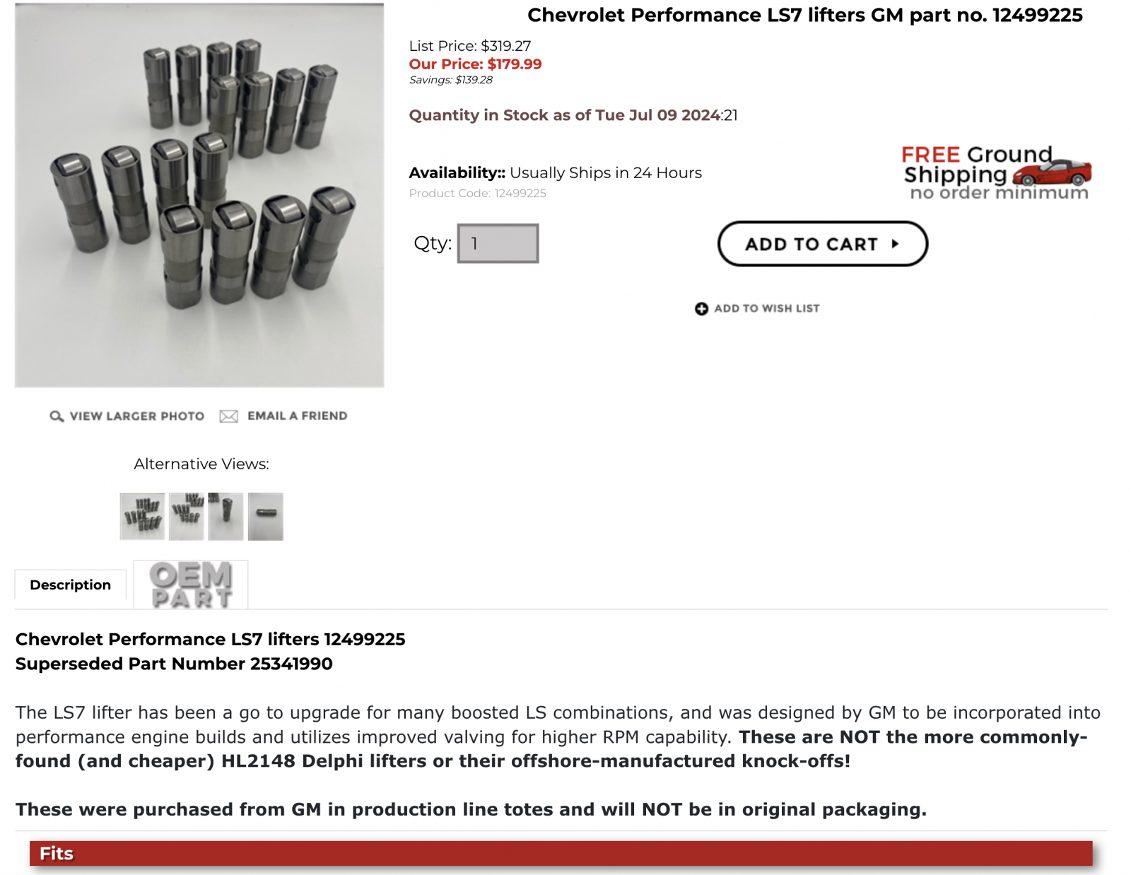

Those lifters sound too good to be true.
GM Bowtie lifters # 88958689 are $538.

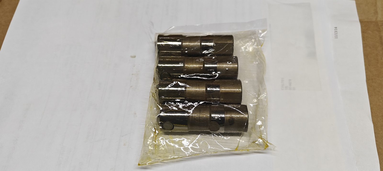

I just realized that's a totally different part#/part.
Racing vs. OEM lifters, not that it diminishes your point. I've been stalking that website/company for a while, and it seems like folks in the Corvette forums have had good luck with them.
It wouldn't surprise me if these are just "blems" (hence the "no factory packaging"). I interned at Ruger for a summer back in college, and there's an internal-only list of blem guns that comes out every month or so, that can't pass final-assenbly QC for visual reasons, so employees can buy them for huge discounts, like 50%+ off depending on the model. If I wasn't a poor college kid at the time I would have bought them all.

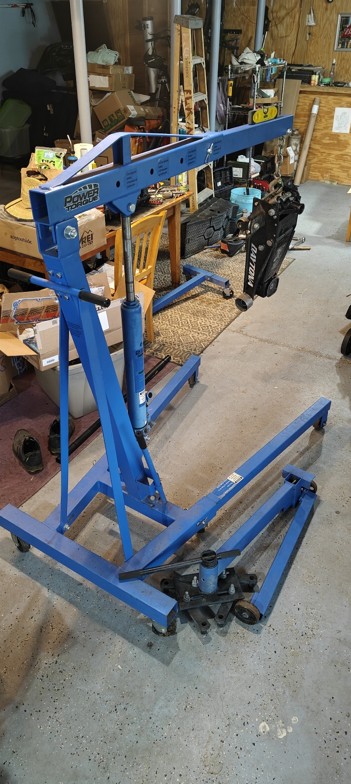

Found a once-used 4,000lb. engine hoist w/extra engine stand for $200 delivered to my door.
Sounds like it sat for a while, but after leaving an 80lb floor jack hanging all evening it only came down a couple degrees, so I'll be at least a little confident I won't fúçk something up.
