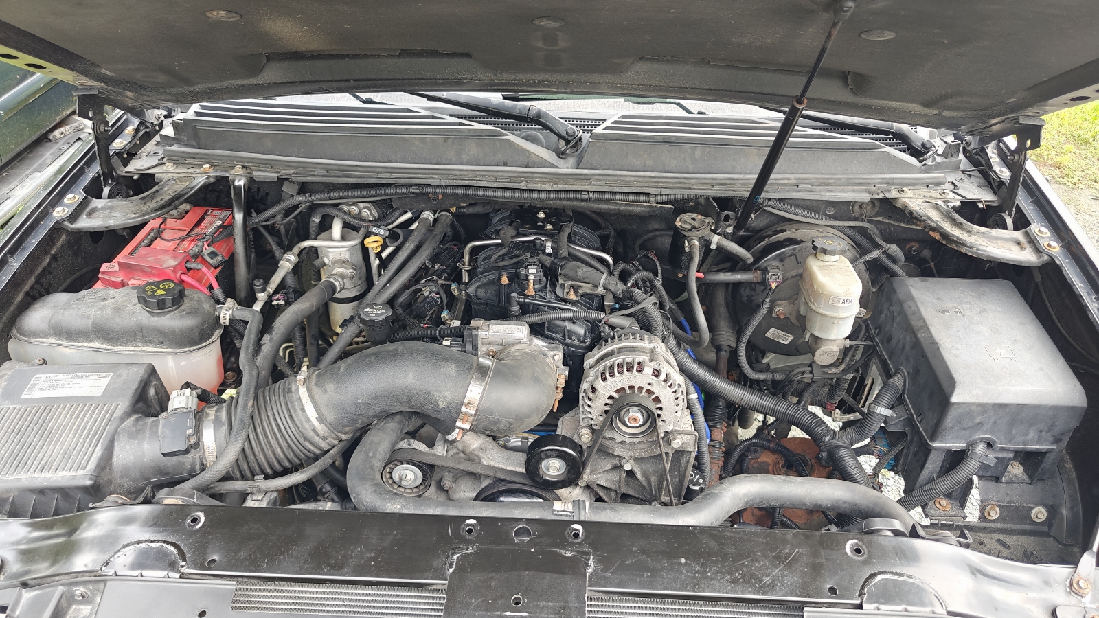

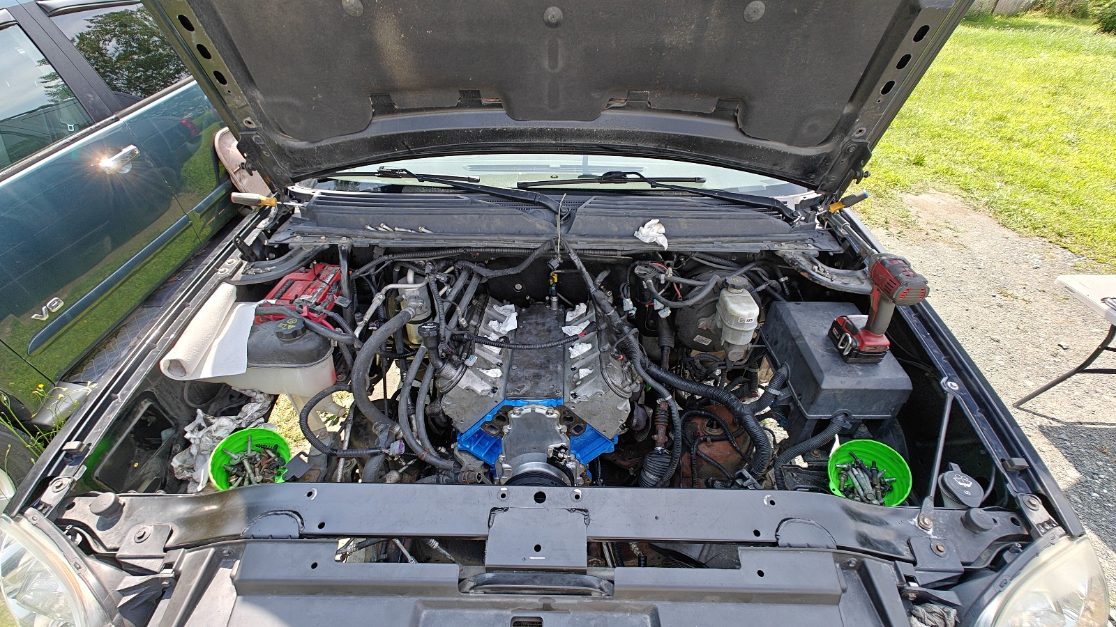

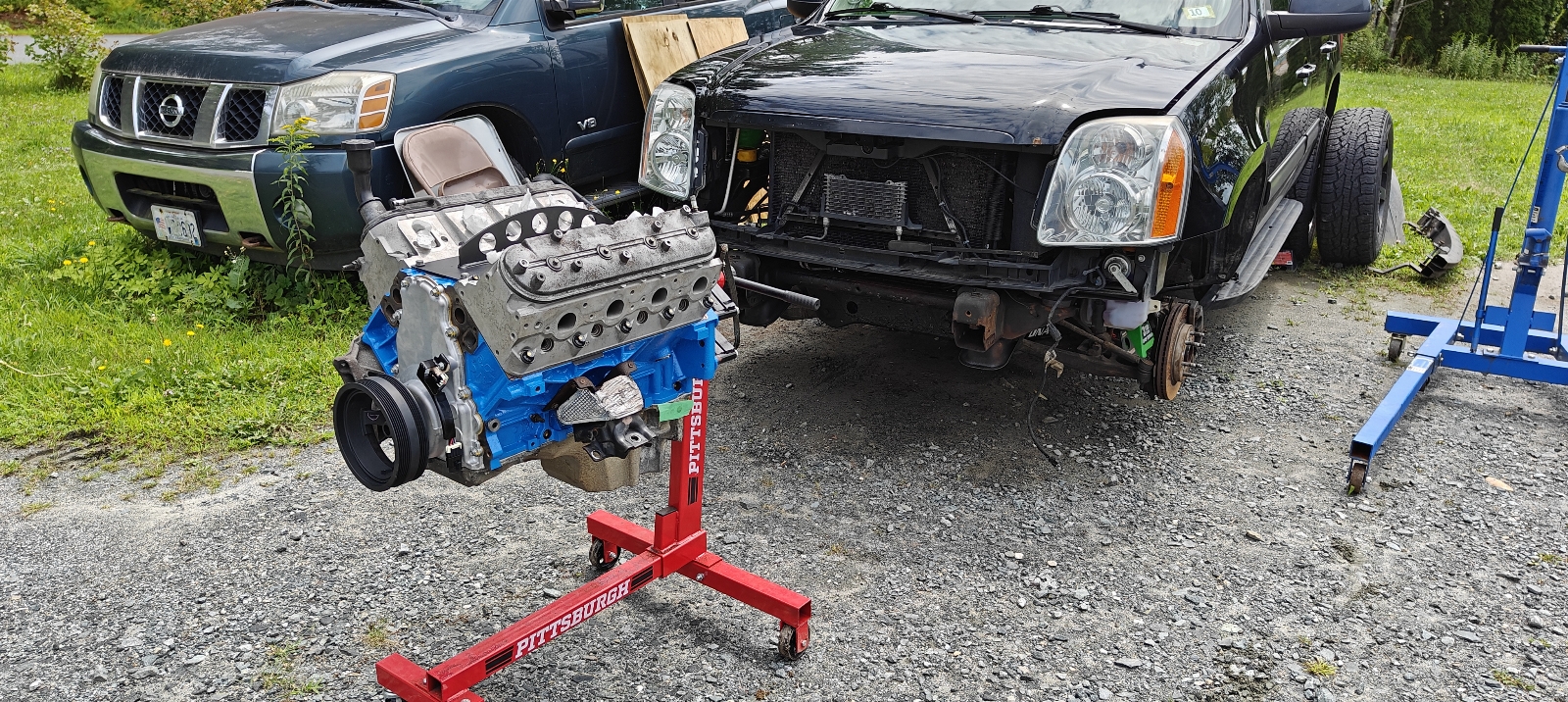

Long-block installed:
All accessories installed.
Installed updated BBP tune, but am running into persistent P0010 (cam sensor) code. Assume it has to do with the VVT-delete, and am hoping a revised tune helps deal with that. Perhaps they have to disable the CEL for a missing cam phaser error, to prevent the issue.
Also seeing ABC/TSC lights on dash. I've checked both front wheel speed sensor connectors, and they look good. Some googling has shown a common P0010 & ABS issue after a cam swap/VVT delete, so I'm not sure.
I've been able to sporadically fire the engine with the 6.0 basemap, and it's a pretty lumpy idle. However, after the engine warms up it won't restart.

Hey now... they sent the revised tune. It addressed the cam idle quality and P0010 error message deletion.
After flashing the tune the engine fired right up, and restarted every time I turned the ignition on/off, after letting it idle for a while to come up to temp, and cycle the fans.
After the only work call I have to actually attend each week at 4-5pm I'm going to button up the body panels, and go for a rip. (fingers crossed)

Buttoned most of the stuff back up (minus the splash guard/skid plates) and went for a short drive to get everything up to temperature. Nothing blew up, and everything seemed to work. When I got home the ATF was up to temp so I could check that level, and it was low enough to use up the quart of Dexron-VI I had laying around, so I'll have to limp down to the local parts store to get some more.

Current issue is that the ABS, TCS, and Brake lights are blaring in my face. I've checked the two front wheel speed sensor connectors, and they're tight.
I don't see anything obvious, and am worried that I may have inadvertently cut, crushed, or yanked on a wire or harness while removing/replacing the engines.
At least my oil pressure is higher in this engine.
