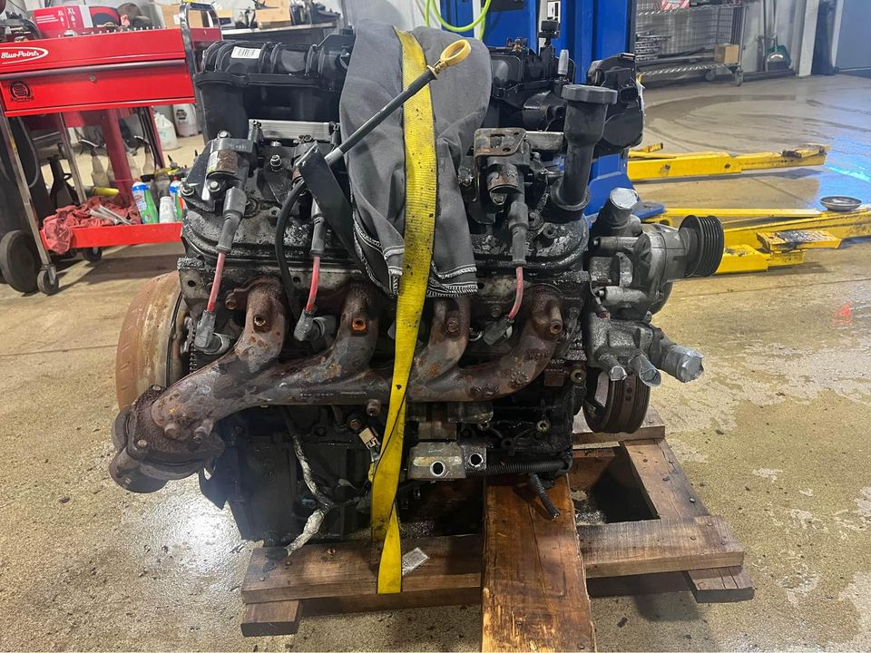

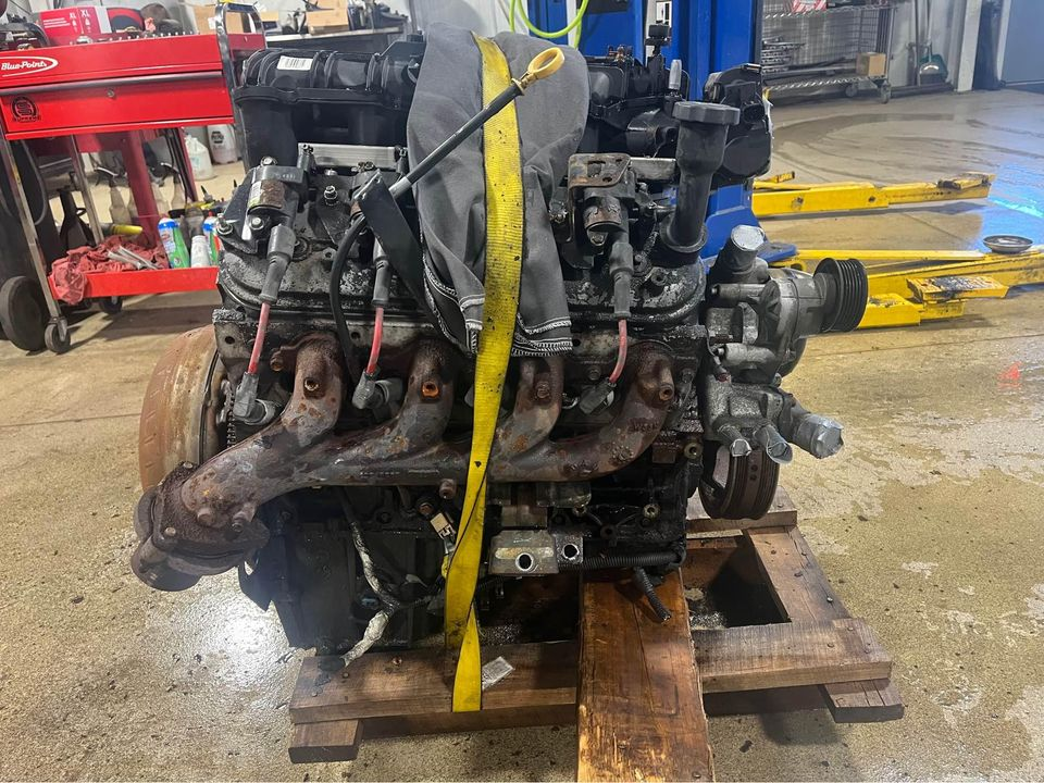

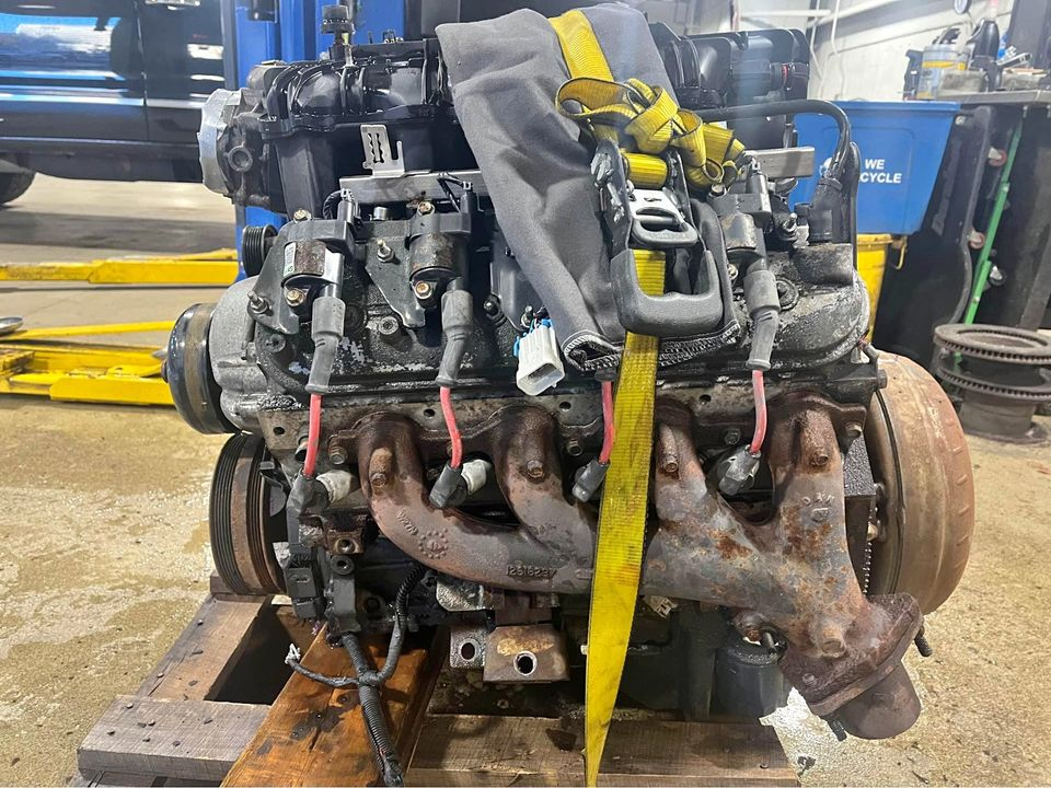

Is something like this worth it, or Scamazon trash? Unless the pistons are beat up, I don't think I'd need to replace those. (unless I do!)
It's not going to be a track/kill-mode engine... more hp/tq would be nice, but reliability as a DD is at the top of the list. Assuming it's a good candidate for a refresh, I'd probably only add a cam (and associate valvetrain) as upgrades at this point. Headers would be down the road.
Seller claims not to know the mileage, but that it came out of a running/driving 2008 2500 pickup that was too rusty to pass VT inspection. But, for $600 I'm going to take a chance that it's not too hammered to revive. (I just spend $425 on a 2008 SIG P226 PD trade-in that works great, so I'm betting 2008 is a solid year for projects*)

View attachment 423974View attachment 423973View attachment 423972
In general, I'm not a fan of all-in-one kits unless I know the manufacturer of each of the components in it, and they seem to always make some compromises somewhere. And there have been so many reports of fraudulent parts through Amazon, that I will no longer buy parts through them. Summit, Texas Speed, Rock Auto and JEGS are reliable suppliers so if I were going to buy a kit, I would only do it through one of them. A notable exception to my first concern here are transmission overhaul and banner kits because those are almost always put together by well-known suppliers and most have high quality parts in them. They're also sold through Rock Auto.
Anyway, that looks like a good find that you'll have a lot of fun working on. Then the next question is: do you really want to do all of that work and put it into a rusting body and frame? Or could you also find a $3000 Yukon or Tahoe in Arizona or even North Carolina, with a bad motor and have it shipped home first?

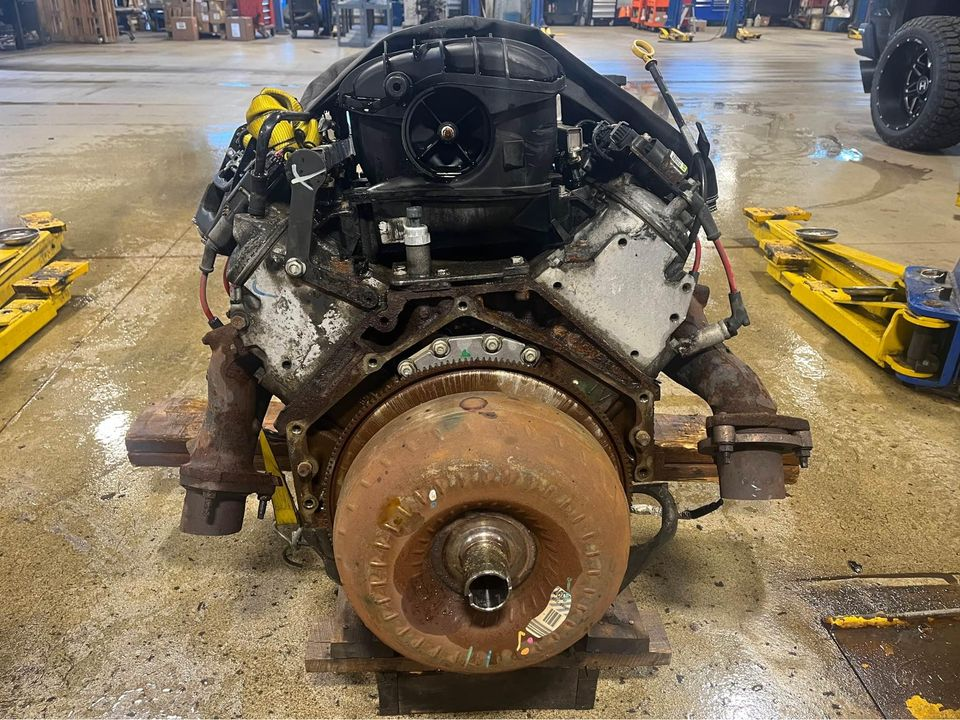

Progress.
Story is that the transfer case in the 2500 donor blew up, and the frame was too rusty to throw money at. Truck was a daily driver until that, with ~154,000 miles on it. [Allegedly] it ran fine with no oil burning issues, no weird noises, yada yada.
