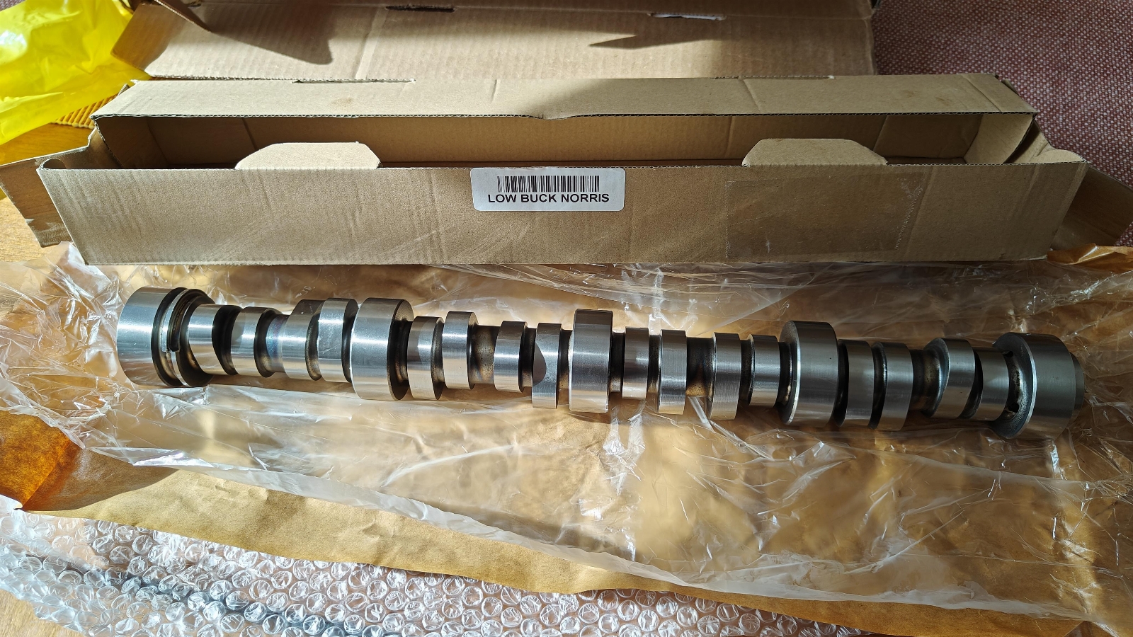

Low buck truck cam arrived today. The UPS tracking info said it came from BTR, but the label had Richard's name on it.
After watching a ton of his videos and live streams (tons of good info there) I assume he's got a good relationship with Brian Tooley Racing. The specs on it are pretty similar to the actual BTR Truck Norris cam.
He did say the the price on his cams will be going up soon, but I think he still has some available for $169.
I still have a ton of work to do to the block, and parts to buy, but progress is slowly happening.

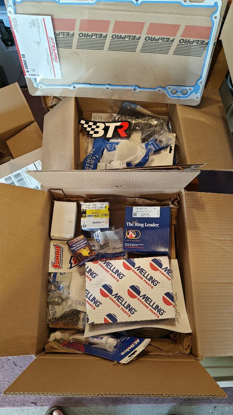

Ordered some new parts from BTR: valve springs, valve seals, crank bolt, lifter trays. Basically enough to get over the $200 threshold for free shipping.
Also talked to the local machine shop about services & rates. He's going to take my block, heads, pistons, crankshaft, and clean them all in the hot wash tank. He'll service the heads and install the new seals and valvesprings, hone the cylinder bores and install new cam bearings, install new piston rings, and polish the crank bearing journals for me. His initial estimate is $600 assuming everything goes as planned.

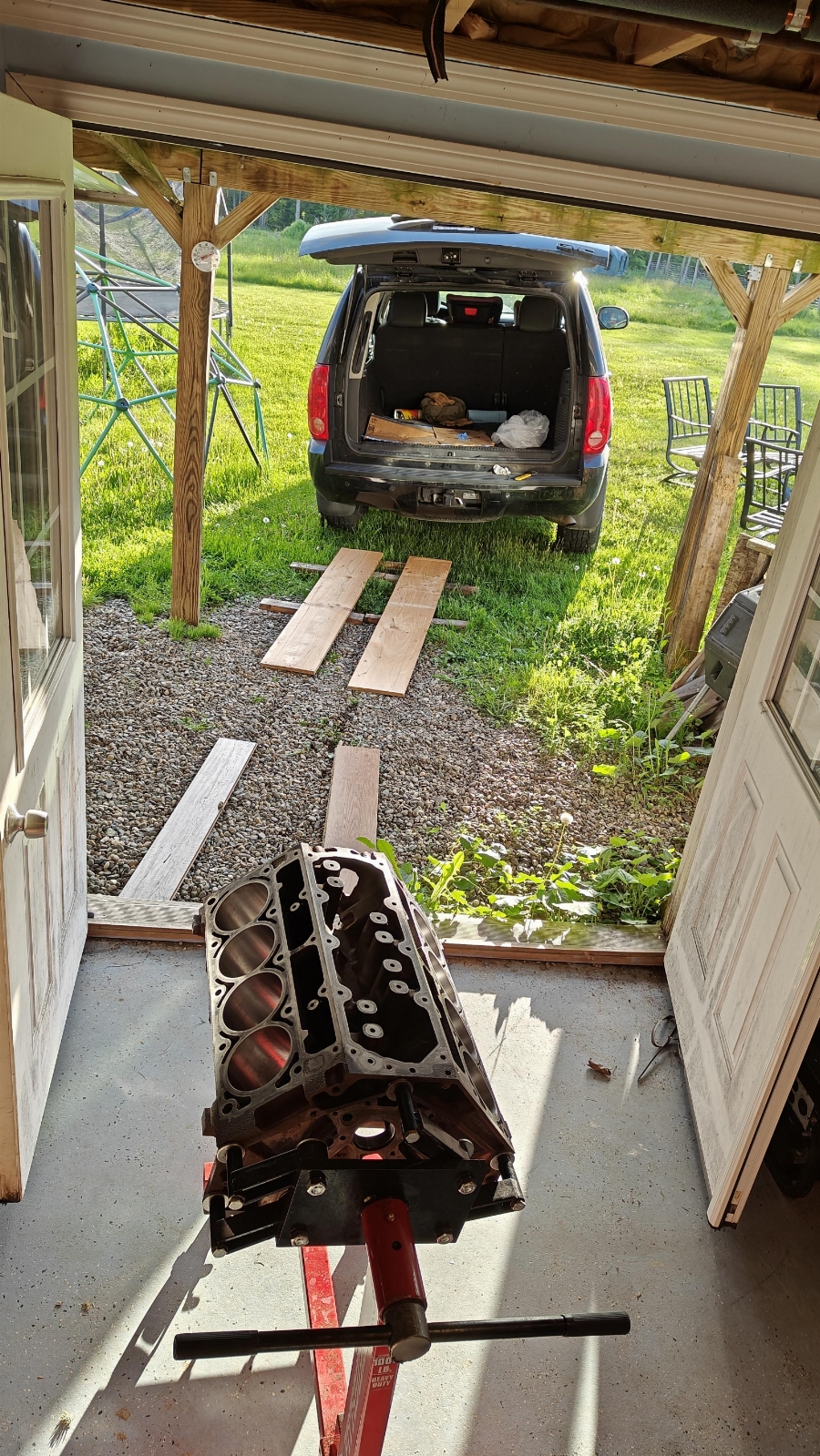

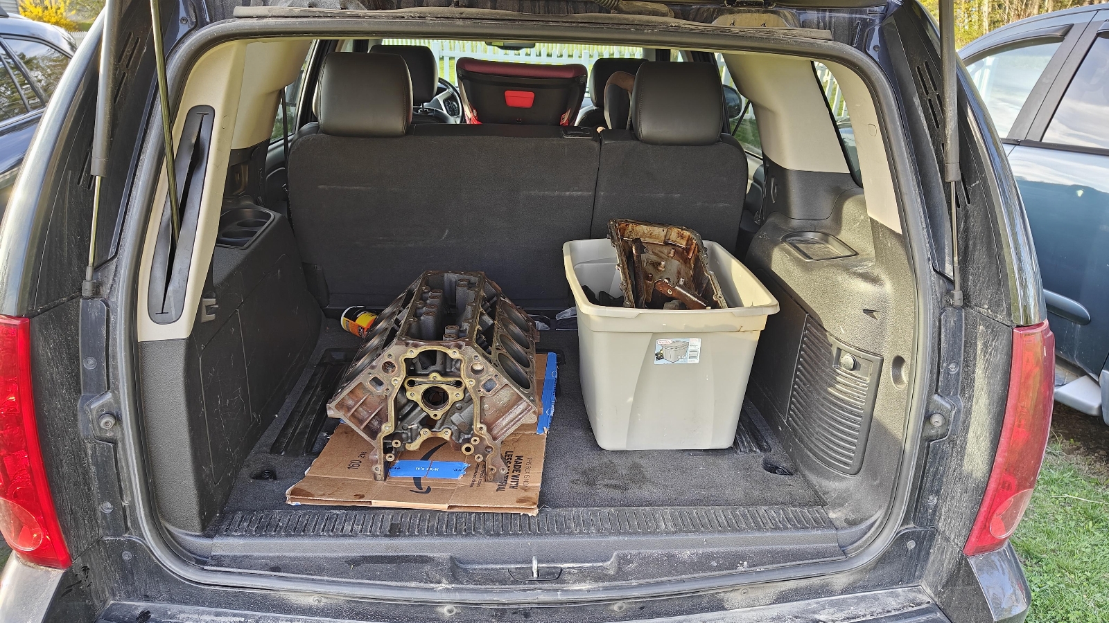

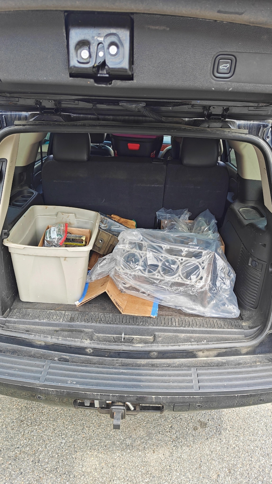

Just got home from dropping off the cylinder heads w/new springs and seals, crank, and pistons at the machine shop to be cleaned and serviced.
The block was too heavy for me to carry on my own...need the neighbor's big muscles to help load it in the back of my car.
The machinist looked over the rod & main bears, and crank journals and said they looked to be in really good shape, and unless he spotted something egregious later on (he only looked at a couple) that he'd probably just clean them up and suggest I reuse them.
He did show me the wildest thing on a separate 6.0 LS iron block, how cylinder 2 had rusted through from the outside, and that I should tap on the block with a hammer to check mine. That's how miserable the road treatments are here.
And also how a iron LS block weighs more than an older big block that is physically larger. I picked up both off the ground to see for myself, and yeah that LS wants to stay on the ground if you let it.

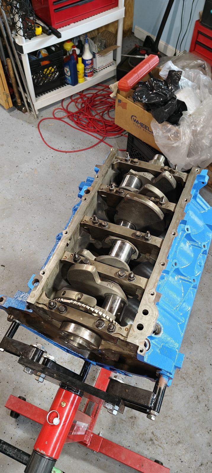

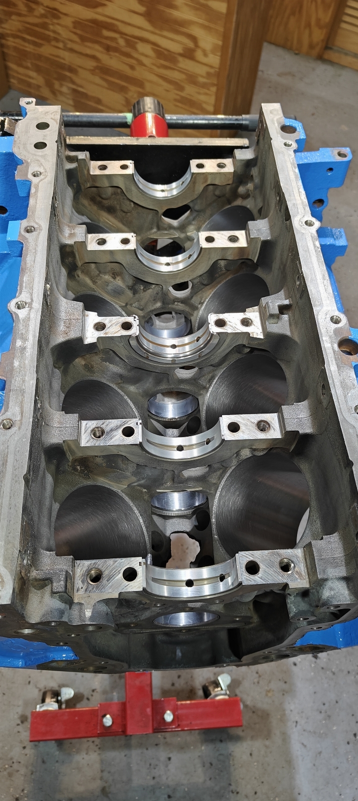

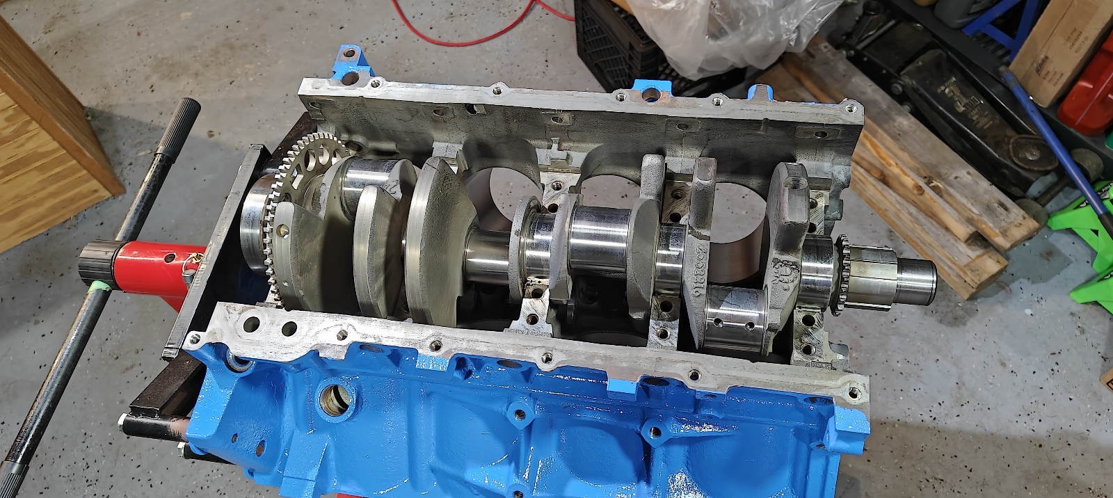

Was out of town for 10 days or so travelling to MT and UT to see some friends and national parks. Finally was able to resume the slow rebuild.
Installed the main bearings, crankshaft, and main caps. Forgot to clean the old shmoo off the bolts so I'll have to resume after a cleaning.
