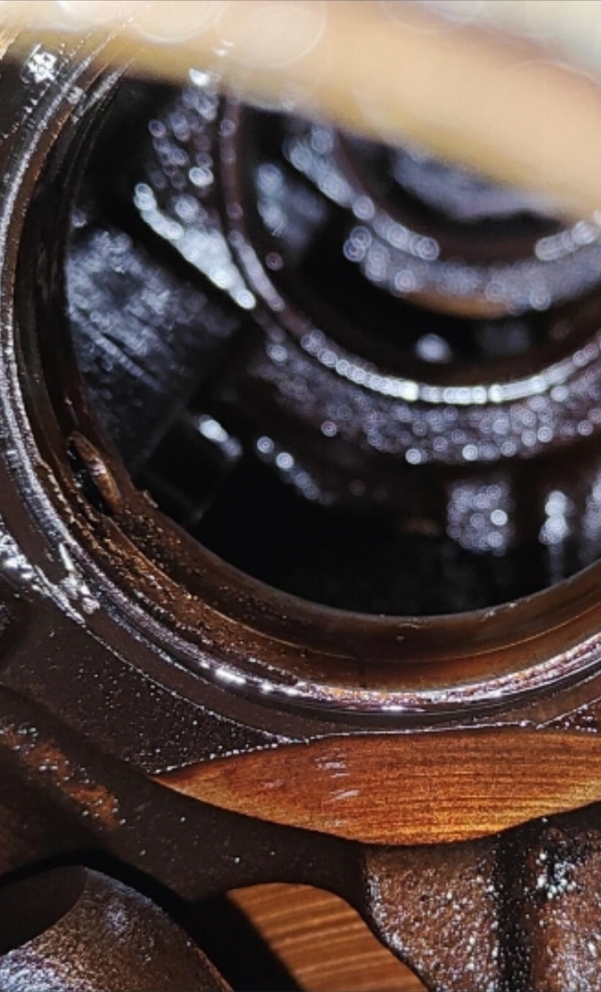

Ah, frig... that cam bearing looks bad.

that old girl was pretty full of sludge huh.
I will say when they joke about all ls cam bearing being bad of you look at them.. this might be the worst Pic I've see.
might be worth having that block cleaned and no bearing at that point. you can buy the tool and install them yourself if you want to thou.

Yeah, I was scouting out the tool on Scamazon last night. It doesn't look like AutoZone rents it, which is a shame, but it's only like $60 to buy.
As far as sludge, yeah... kind of gross, but the pickup screen was at least totally clean. The top of the heads are sludge-free, so.... yay.

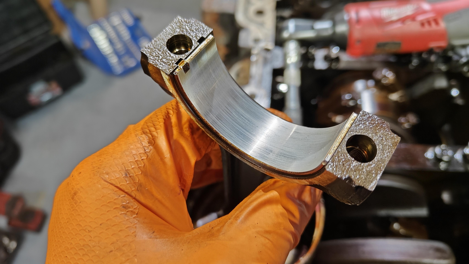

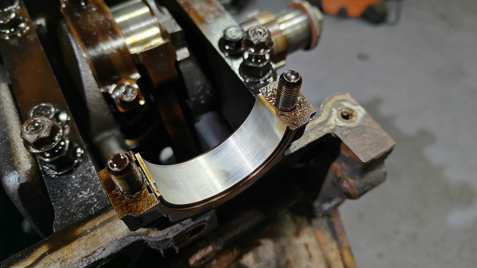

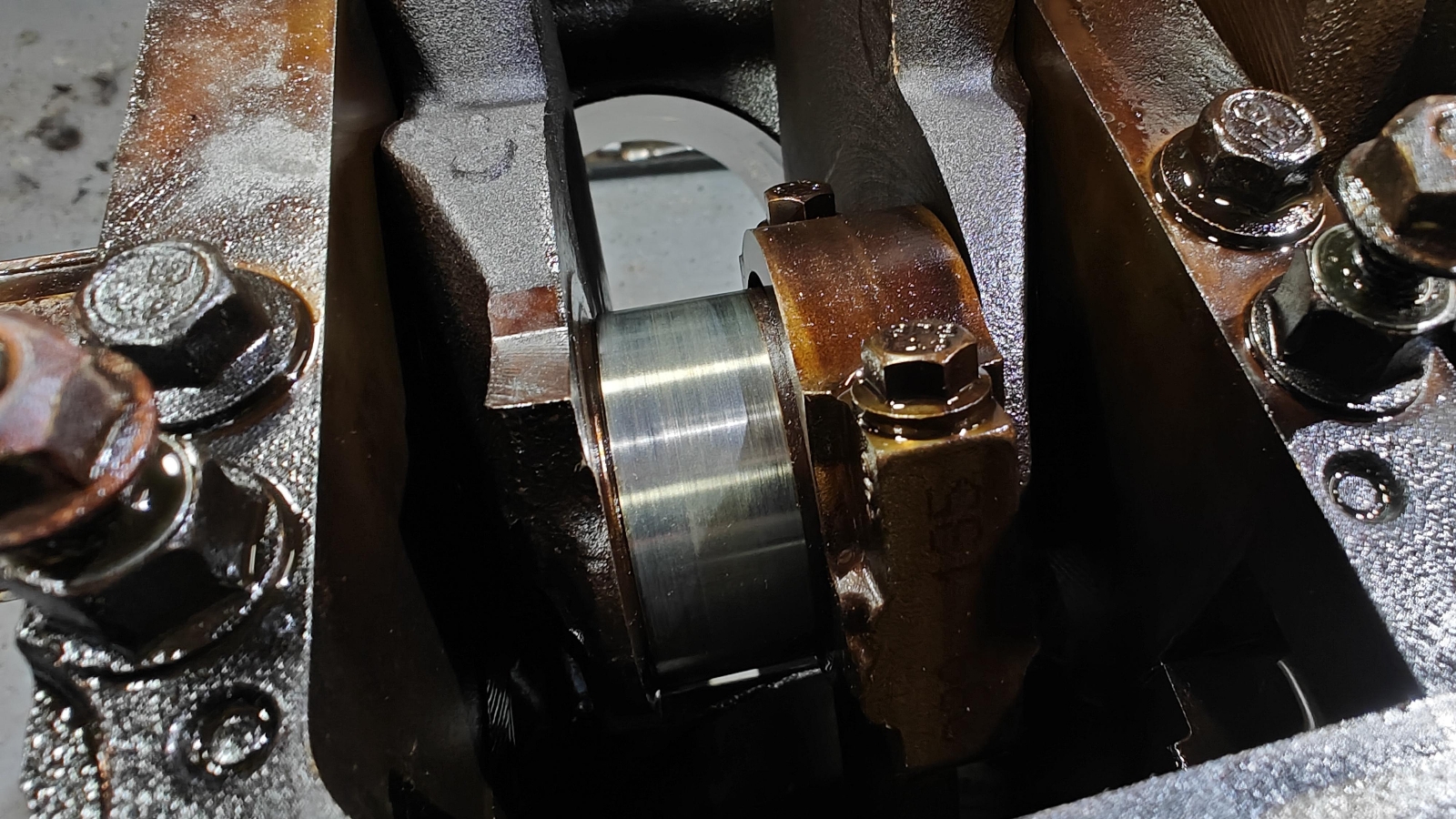

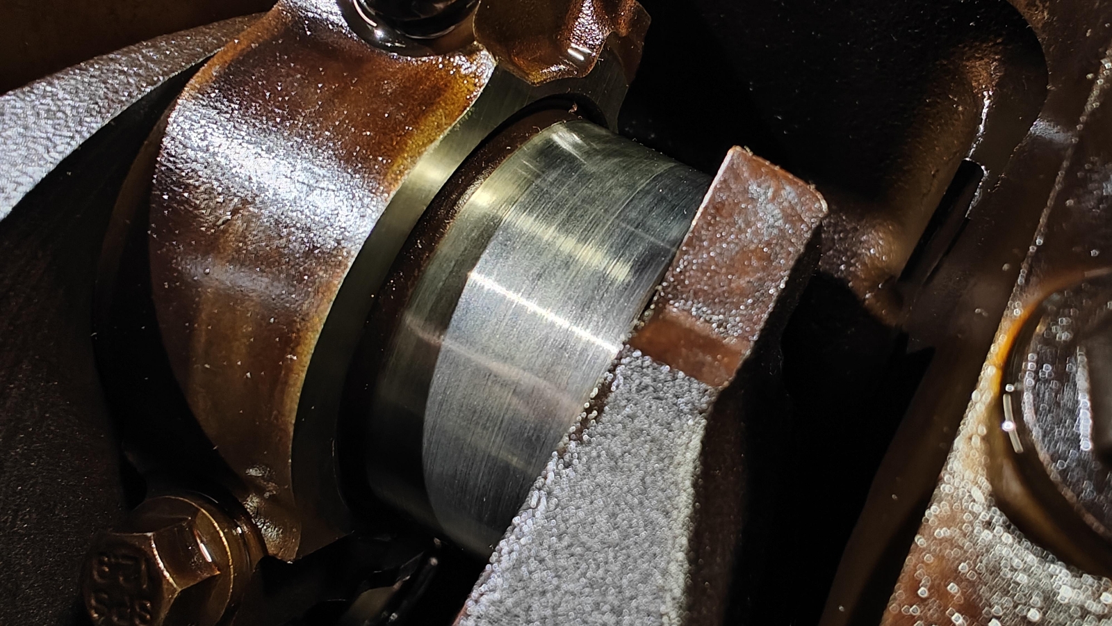

Pulled the #1 rod cap and piston to glimpse at the bearings and crank surface. Rod bearings look to have some wear, but I'm not sure how bad. Crank doesn't look terrible, but again, I'm no LS expert. The surfaces felt smooth, with no gouges.
Cap #1
Rod #1 bearing n
Crank

The bearings don't look too bad to me, I'd slap it back together.
The crank, however, seems a little more scoring than what I would like to see. I think if you can't catch your fingernail across it, you can still run it...
I'm doing a DIY rebuild on my LQ4 right now. It had 262k. My bearings looked a bit worse, but the crank journals looked pretty good. I just put the bottom end together with new bearings. I wish I would have taken a picture of the crank journals.
You can check clearances with plastiguage. My local AutoZone carries it, but I have to give them the part number. The parts counter guys always tell me they didn't know they carried it the times I ask for it. Go figure.

definitely had some trash pumped thru it. by the looks of it, this poor thing didn't get a lot of oil changes and cheap filters.
my 2 cents is are you in a hurry? while I would have no worry about those going another few 100k also what's the point. if you're all ready having to deal with a machine shop to have the block cleaned and new cam bearings, not much extra to have the crank polished and toss some new bearings in it.

After seeing the condition of the cam bearings, they will need to be replaced as well, which would make sense to have the shop do it (still haven't found a shop yet) since the block is filthy, and would need to also be hot washed at the least. And, I assume they'd need to mic the crank journals to recommend any undersized bearings, if needed. Or, does polishing the crank typically let you run standard sized bearings?
How much (if anyone knows) does it cost to have the crank journals polished?

My local machine shop recommended another local guy that polishes cranks, very small one-man shop. It was $50 to polish my crank, like 2 years ago.
They should be able to tell if a polish should be fine or if you need to turn it down.
