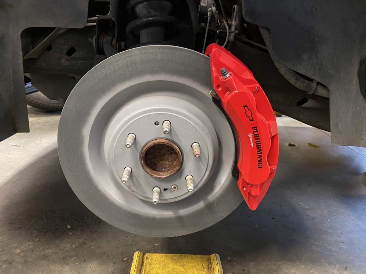

Brembos installed. As expected the kit literally fell on with no BS. Took an hour from start to finish including bleeding. I didn’t get crazy with it yet but it definitely stops better than the EBC Yellowstuff pads (which are still on the rear and still ugly). The Brembos modulate better than the EBC pads which are grabby because they’re so aggressive. The pedal also feels better. So far I’m very happy.

Nice. Factory designed radial mount Brembo calipers that drop right in are a real treat.
Tha Centric rotors went on sale for $110 ea. shipped w/ the “save10” code. It shows they’re in stock for a brief moment too. It’d be a good idea to have a pair handy as the GM parts counter will rob you on these if needed in a pinch.
Dude that's a dope set up!

Does this setup come with braided SS lines from the caliper to the hard line?

No. I'm using the factory hoses. If you wanted stainless steel hoses you can just buy a kit that works with the factory brakes and it'll work with the Brembos.

dont know how i missed this picture. did you also do the rear? you up for compiling a list of what you boought? im really contemplating this upgrade. hoping i can run this set using my oem 22" escalade wheels

The rears are stock. I just changed them to the Power Stop reman red calipers to match the front. The front I just bought the K2 GM Brembo accessory kit. It comes with the rotors, calipers, and new banjo bolts. I wish they offered other colors because the bright red was not my first pick to go with my Infrared paint but I'm hoping to buy another kit at some point and have them powder coated and I'll swap this kit over to my Yukon since bright red will look awesome behind black wheels on a silver Yukon. Even the wife said they'd look better on hers so it will be happening! I just bought a clutch for my SS so it'll have to wait.
