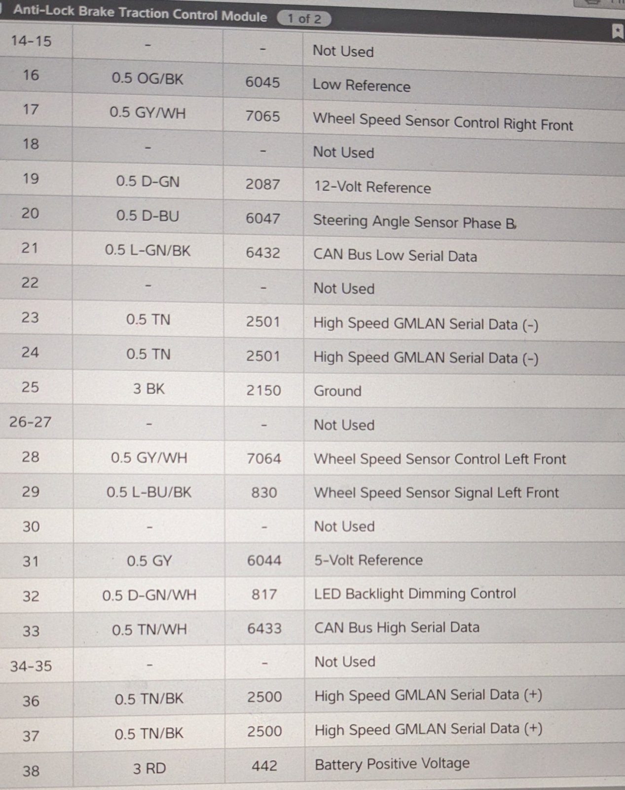

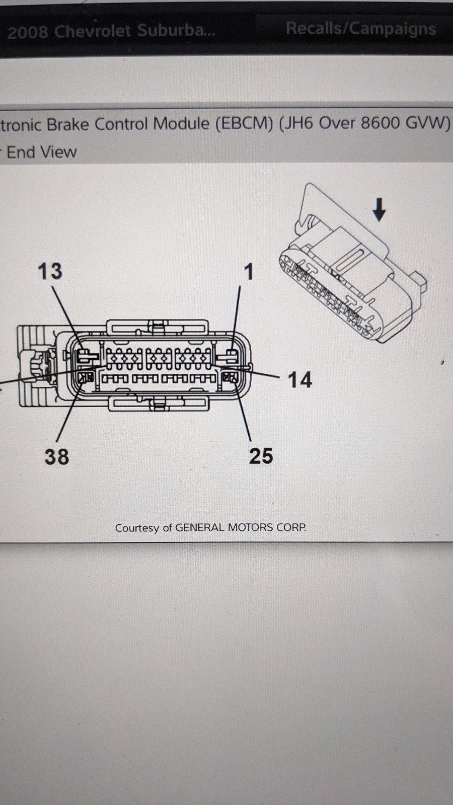

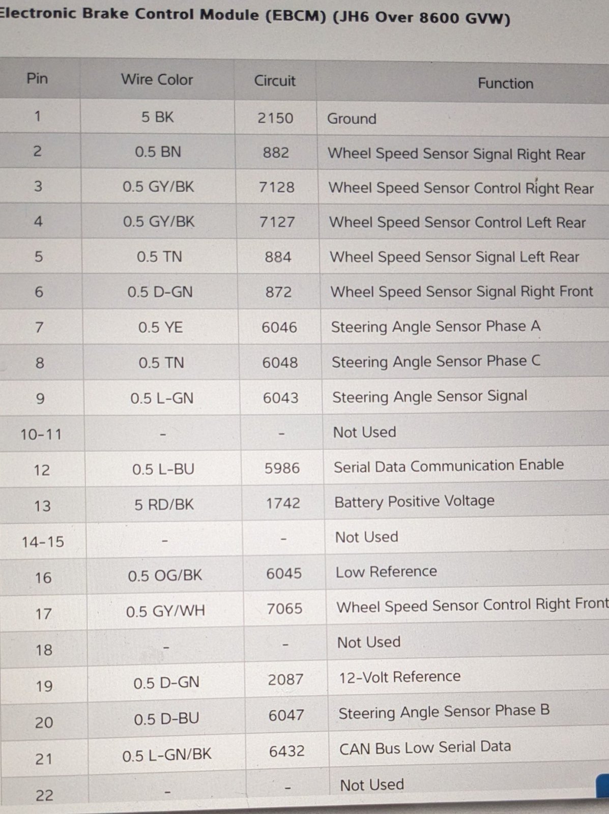

Hey, does anyone by chance have access to the full factory service manual and could share any diagram they might have for the EBCM pinout? If they have it, a diagram for the board itself but I doubt they have that. This needs to be the 2008 suburban 2500 specifically.
52,954
You can have access to the service manual with a subscription to alldatadiy. You won’t find a diagram for the board anywhere, it’s proprietary GM.

hopefully you can download and zoom in to see it.
