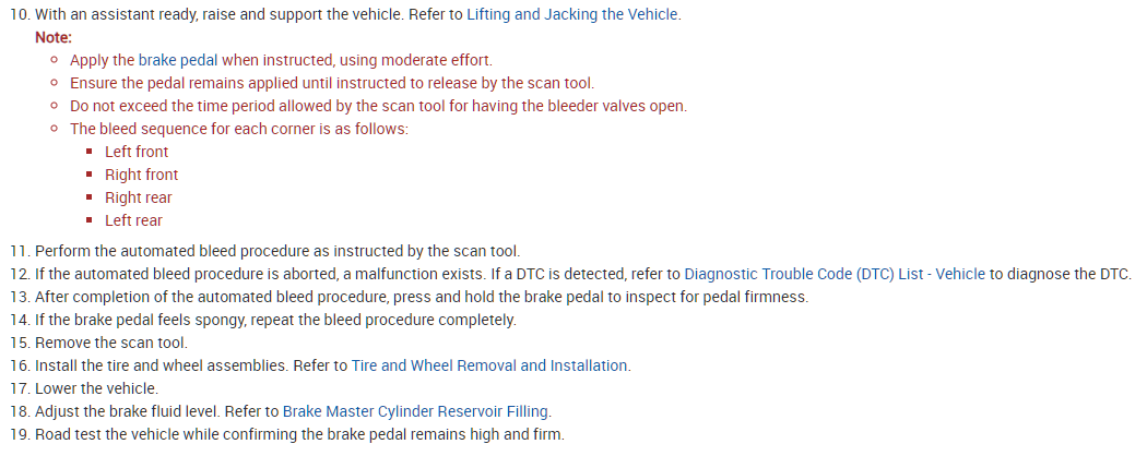

Did you follow this exactly? How many quarts of fluid did you go through? I use 4 to 6 each time.

I also use the Motive pressure bleeder... Never an issue with it. And always follow up by commanding and abs bleed with an aftermarket by directional scanner.
