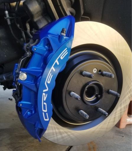

That kit is for 15> unfortunately. It’s due to the offset of the brake carrier to the disc. There’s a clone kit made by CTSV.com. They make the adapter for using Brembo C6 ZR1 calipers with the rotors in the kit you referenced.
https://ctsvbrakeswap.com/collectio...6-piston-c6-zr1-caliper-big-brake-bracket-kit
I pieced the parts together for $1.4K last year and have yet to install it. You’ll need 20” rims min. The discs are huge at 16”

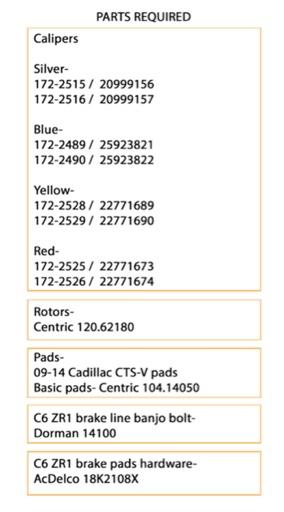

Last time I priced it, the Centric rotors were finally back in stock but the whole kit all in was still far too much in my opinion to be worth it over the Wilwood or Brembo kits.

$1,442 ain’t bad for 6 pot Brembo monoblock BBK complete, No?

Timed most of the purchases for the 16” rotor kit to holiday or flash sales after getting on their mailing lists.
* $195.00 Caliper carrier / adapter kit. CTSV.com
* $170 ($85.00 x 2) 16" OEM each shipped (2) Centric Rotors 120621.80 Stoptech via BuyBrakes.com
* $994 Shipped New (for both) GM / OEM Brembo 09-13 Corvette ZR1 Front 6 Piston Brake via eBay.
* $66.68 Shipped (for both) POWER STOP Z231405 (Premium) Z23 Evolution Sport; Carbon Fiber-Ceramic w/ Hardware via Rock Auto
* $17.06 shipped (for both) Caliper Bolt to Hose Dorman 14100 via eBay

I thought you were talking about Wilwoods. You got a good deal on the rotors and calipers. The calipers especially are much higher than that now. The other thing that raised the cost for me is I would only use the OEM Brembo pads to get the best performance but either way they ought to stop better than the stock 2 pistons. I pulled the trigger on the GM Brembo kit.

Is the corvette logo cast into the caliper? I'd want the caliper to be plain.
That $994 price on the calipers is crazy. They are selling on eBay for $1200/pair and up right now.
