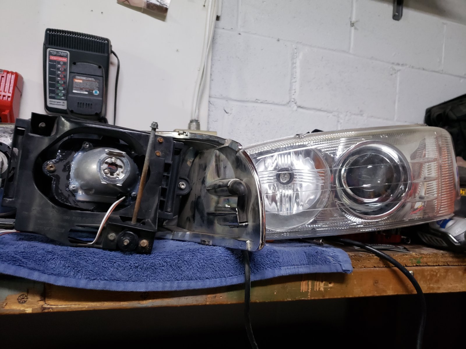

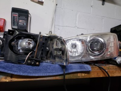

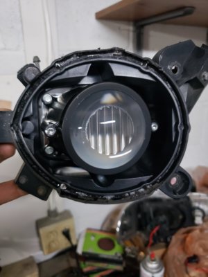

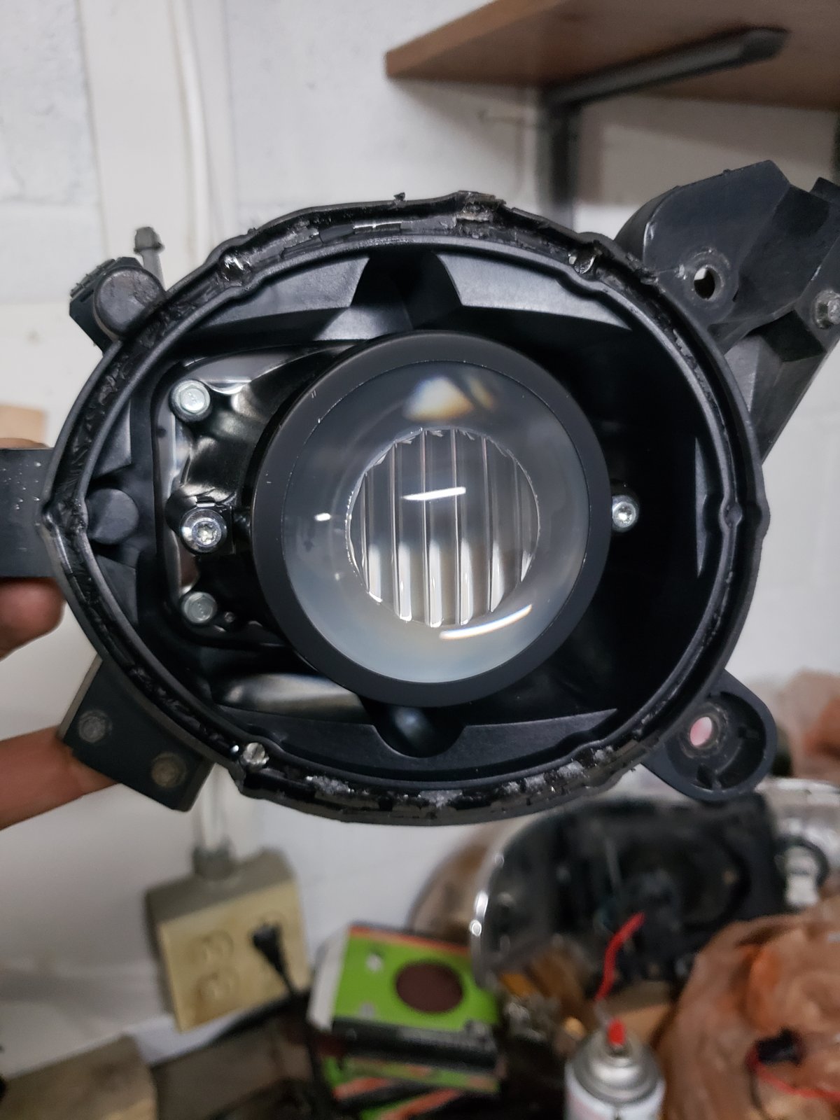

Just followed this video to do the 4hi mod. Super easy and free! It took me 10 min and that was because I kept pausing the video and comparing his wires to mine. Now I shouldn't have any issue with the bixenon projectors

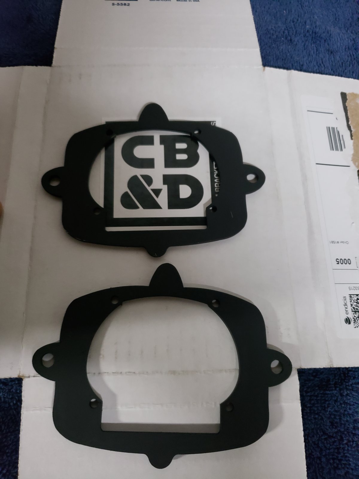

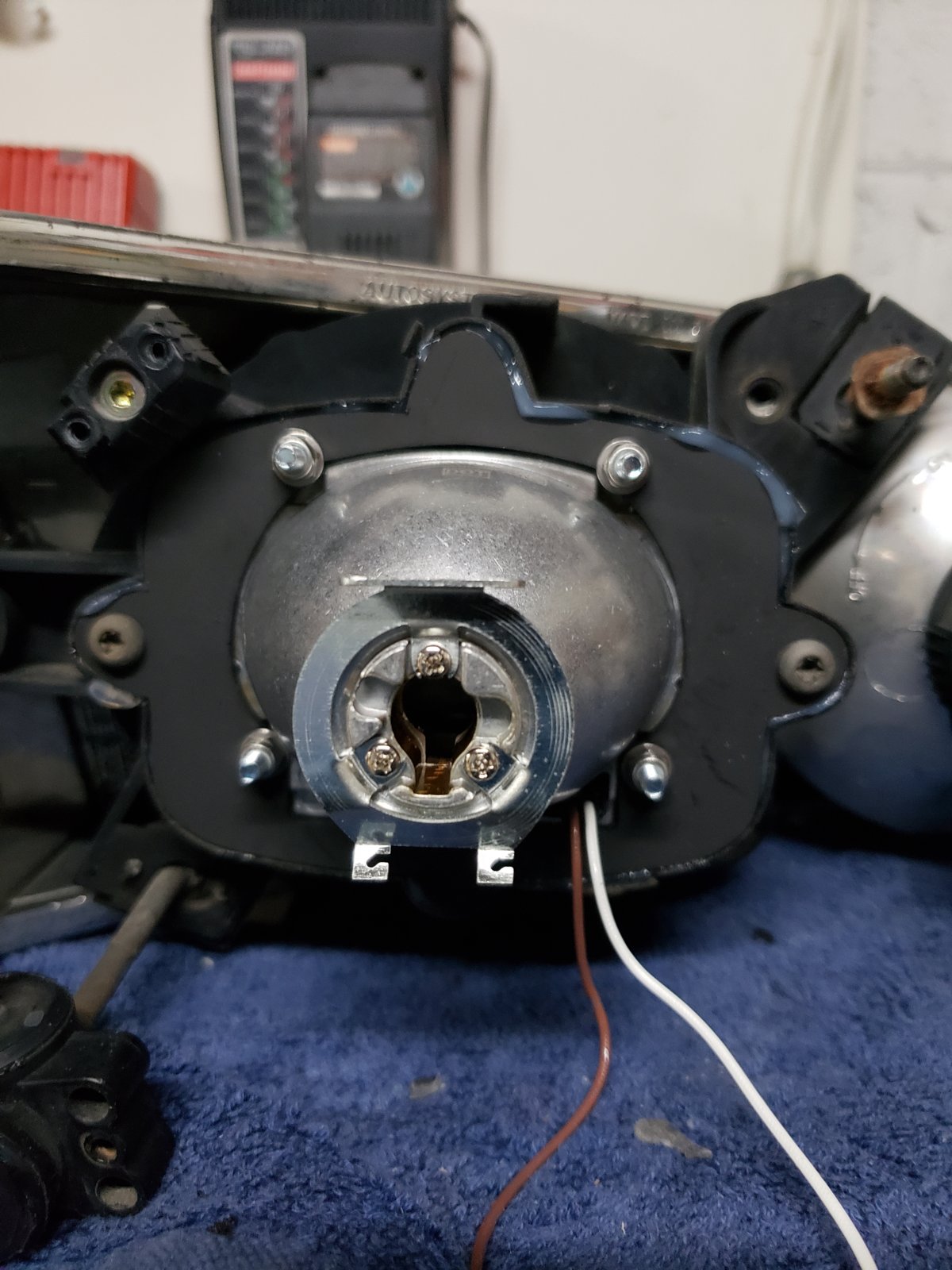

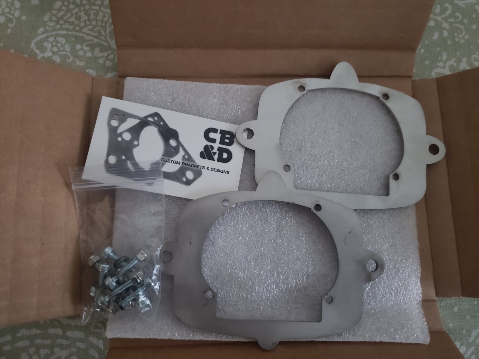

Painted the brackets flat black with high heat paint so they dont rust the rest of the retro has been ordered possibly here tomorrow or the next day.

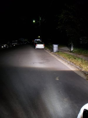

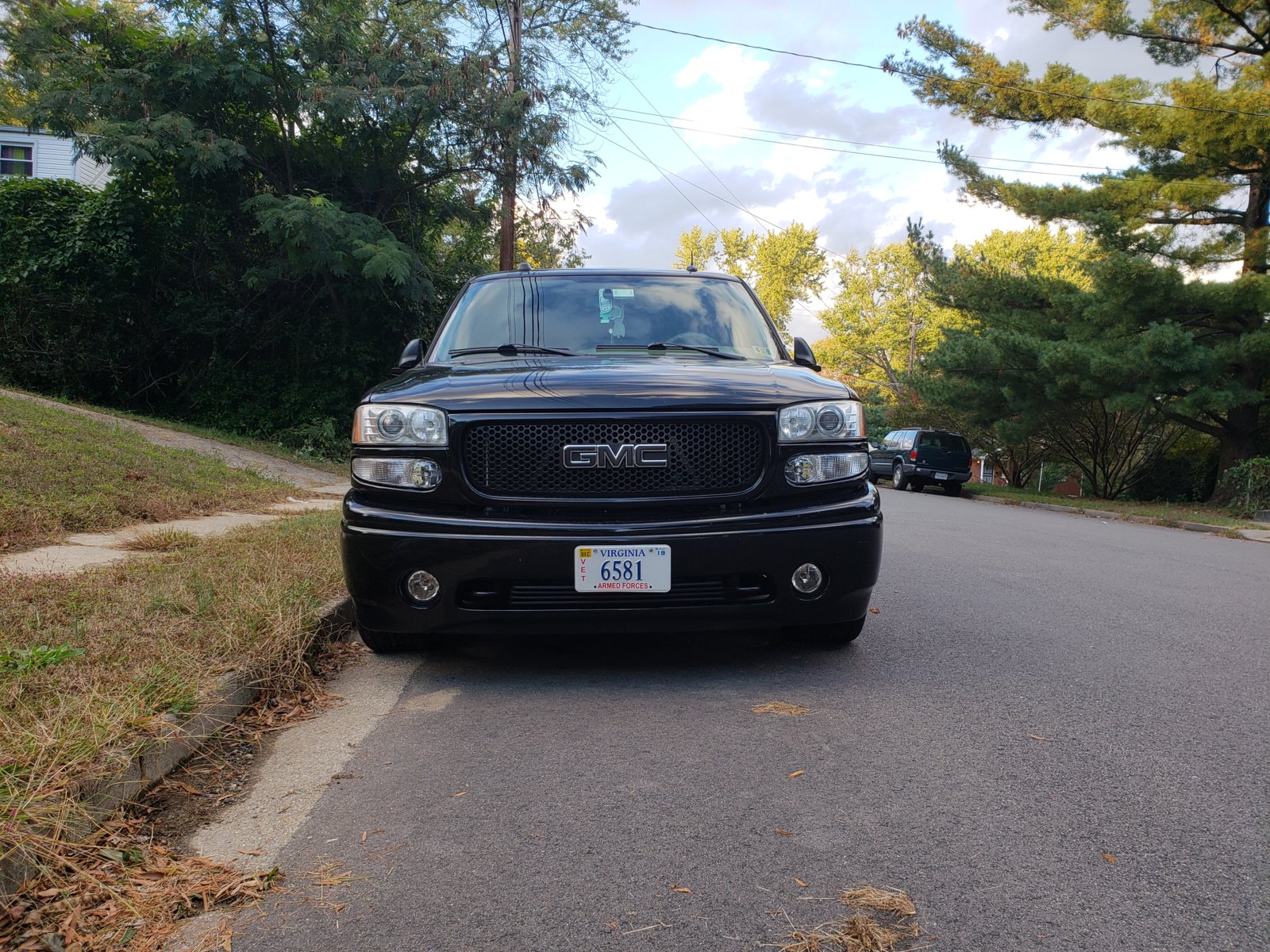

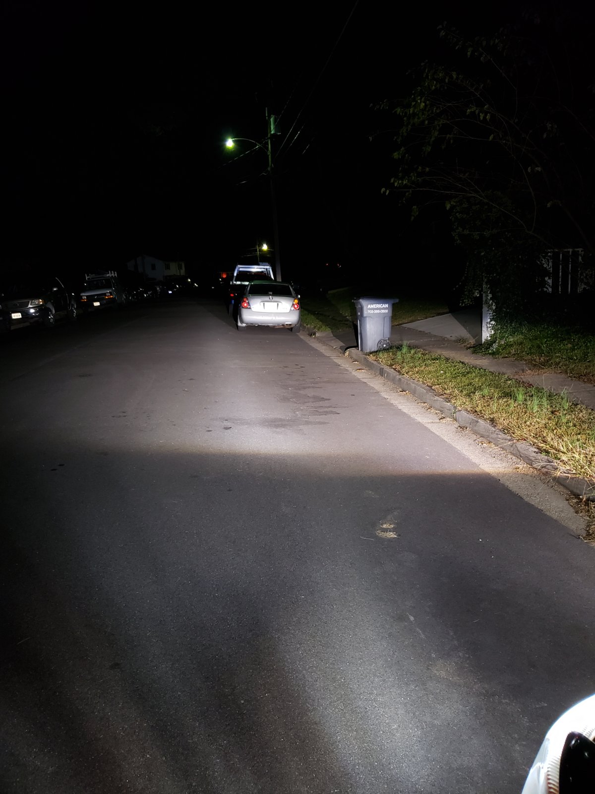

I'll get output shots this weekend most likely. I do need to find some stock adjusters since mine are frozen
52,954

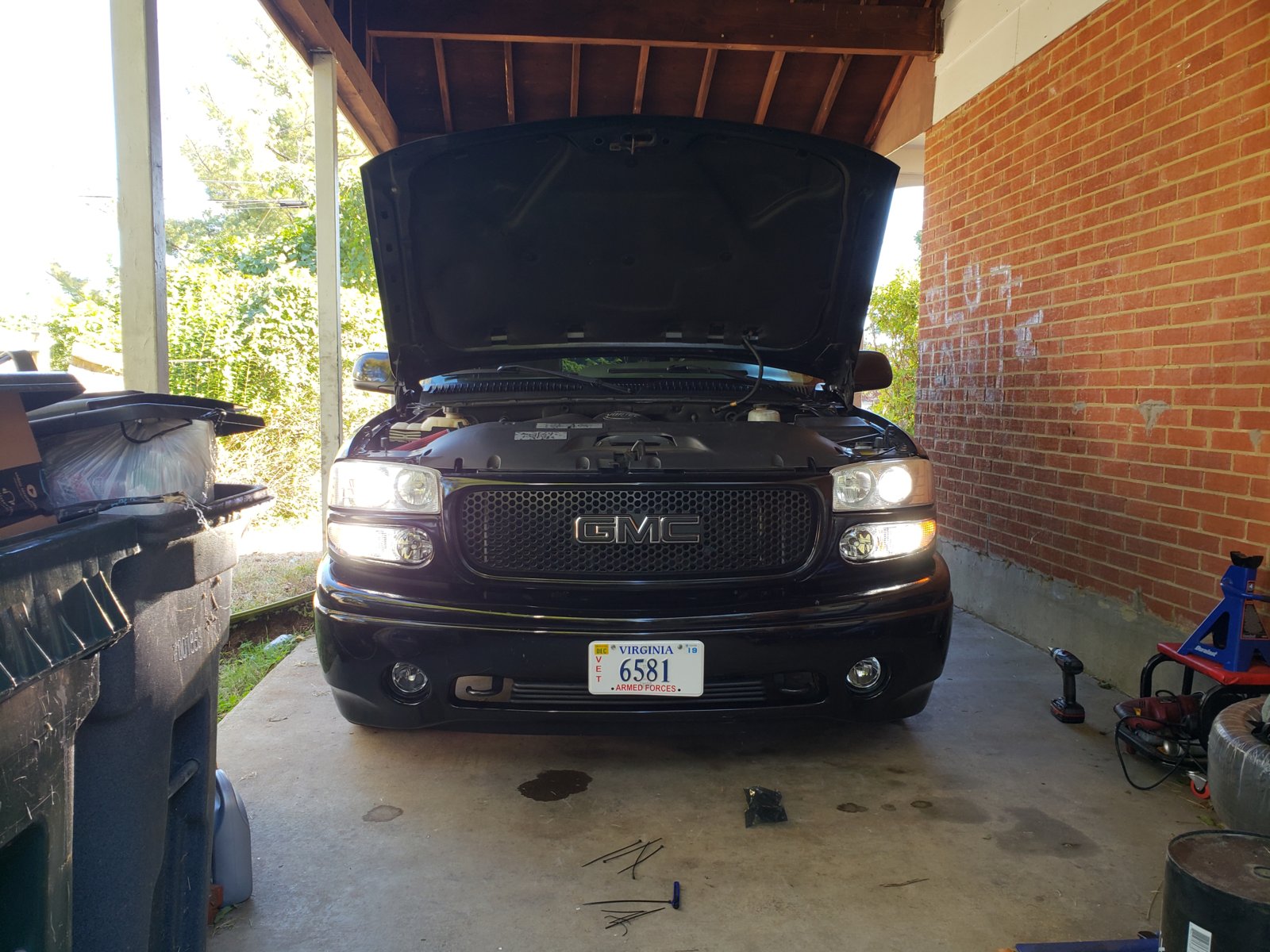

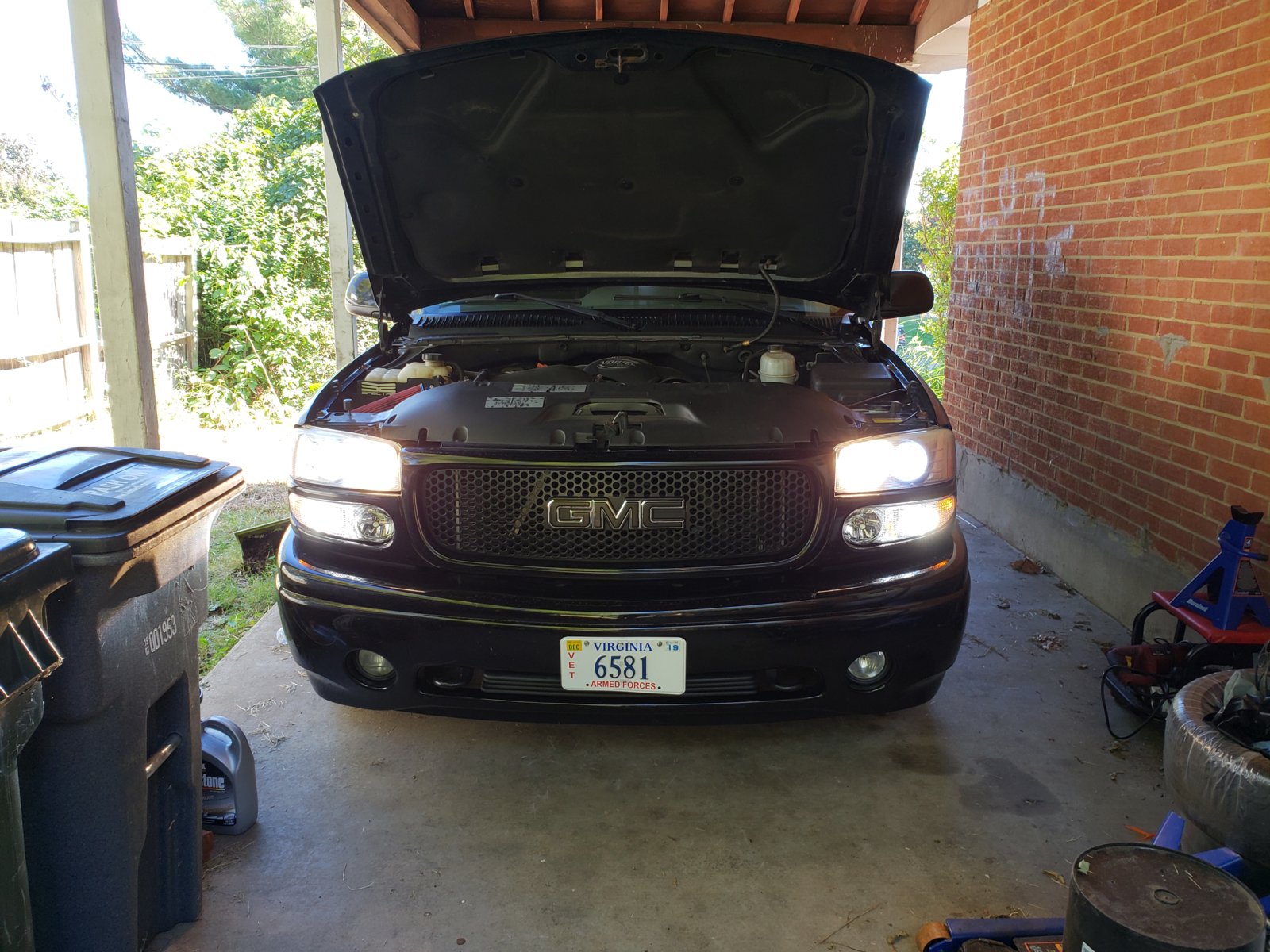

Well it looks like I dont need a new adjuster. Vice grips do wonders..I was able to adjust the light and install my new bulbs.
Night shots later.
I also wired the factory halogen highs to come on along with the bixenon for more bright!
They make a splitter/ pigtail so you can just plug both together into the vehicle plug.

I didn't order it when I got the rest of my stuff. I went back to order it again and shipping would have been more than the item. So I made my own. Still somewhat plug and play. I tapped the high beam solenoid into the harness for the headlight, cut the nub in the female connector then plugged the other end int oll the highbeam bulb and the connector to the factory input. Easy and removable and free.
