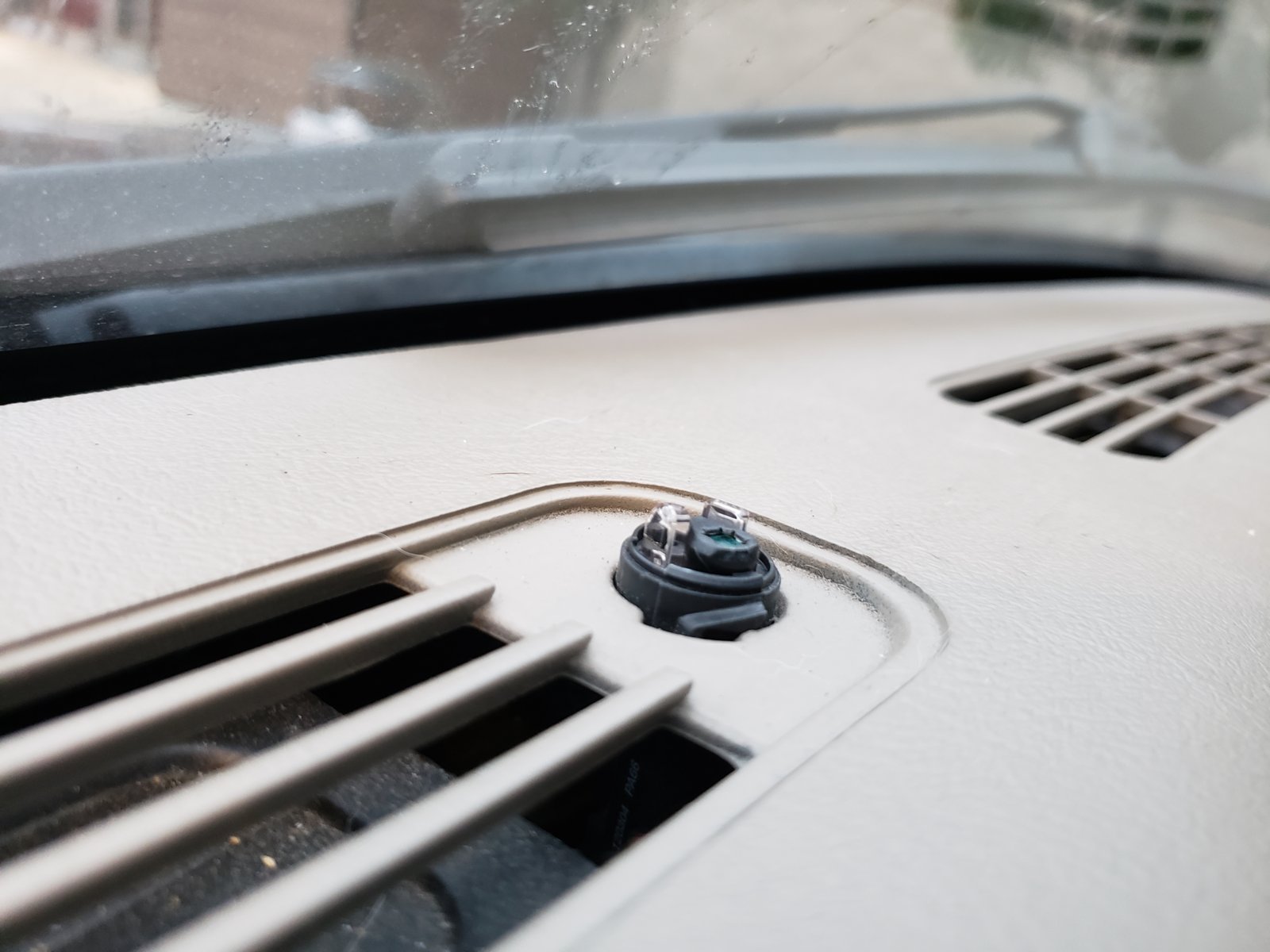

Well I constantly tell my wife to stop putting stuff up on the dash. And today she points this out to me..... hmm I wonder how this happened.....
Just be real careful when pulling that panel off to gain access to the underside so you can replace that sensor. The plastic can get brittle and getting the clips to release can break the damn thing. Pry REAL careful at each clip. The panel is $200-$250. You can also break the dash itself where the panel snaps into it. And the dash is even more $$$ than that.
So I can't twist it from the top? Ugh.....
