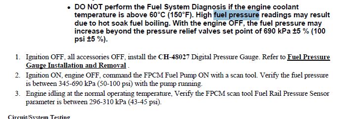

My fuel pressure increases to 55psi only when I hit 4700+ rpms..
(and on coast down or engine shutoff but that's different)
heat also increases fuel pressure
per the oem service manual

Actually found another log it was hitting 55psi by 3900 rpms,
And usually on cold start, sometimes hot start...
