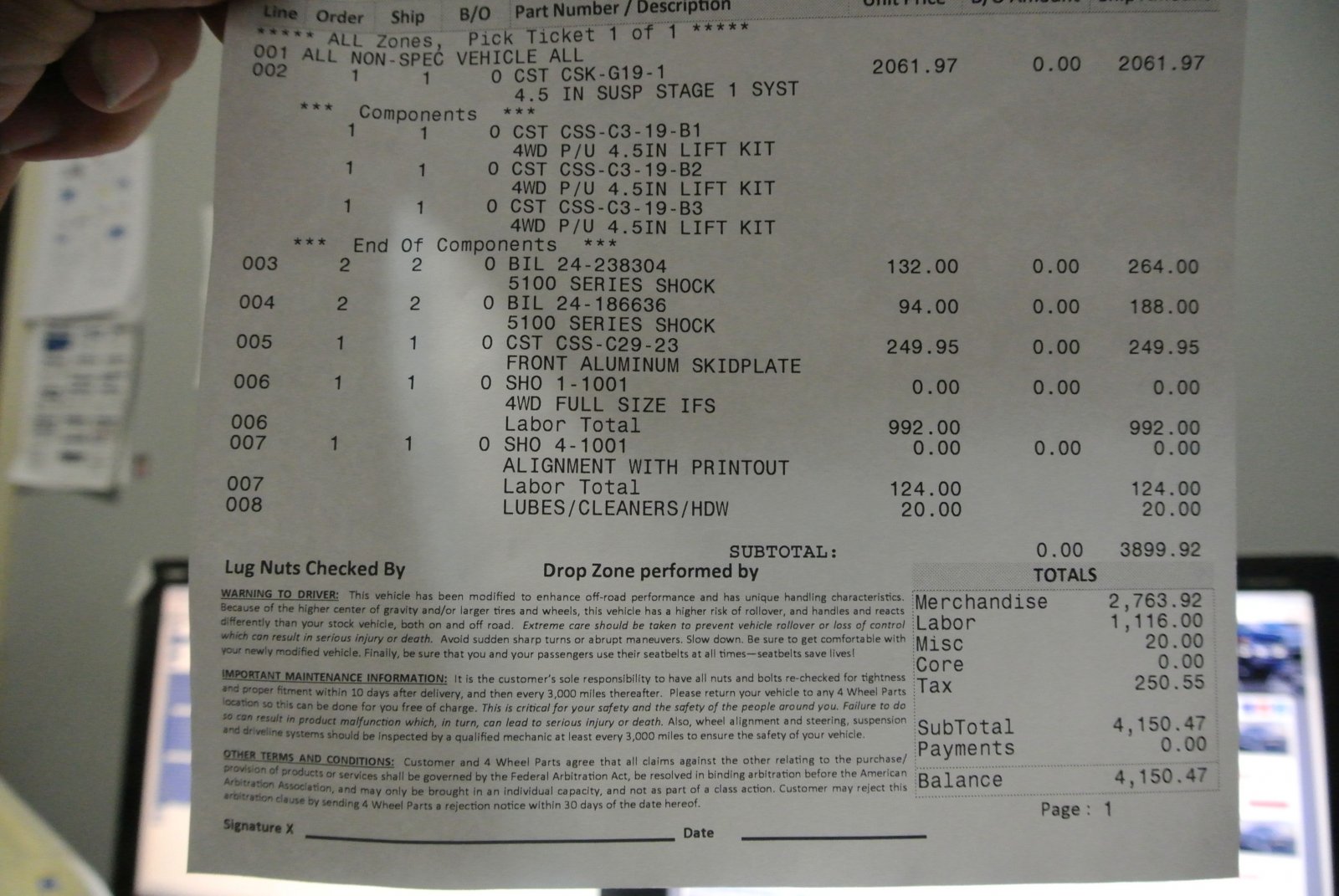

went by 4wheel parts and they quoted me $4100 for the 4.5" lift install and alignment with bilstein 5100's all the way around

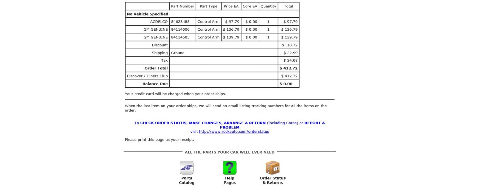

I need to source the oem control arms both sides upper & lower because the drop kit had it's own arms and the oem's are gone

Any particular reason you didn’t get them all from same place?

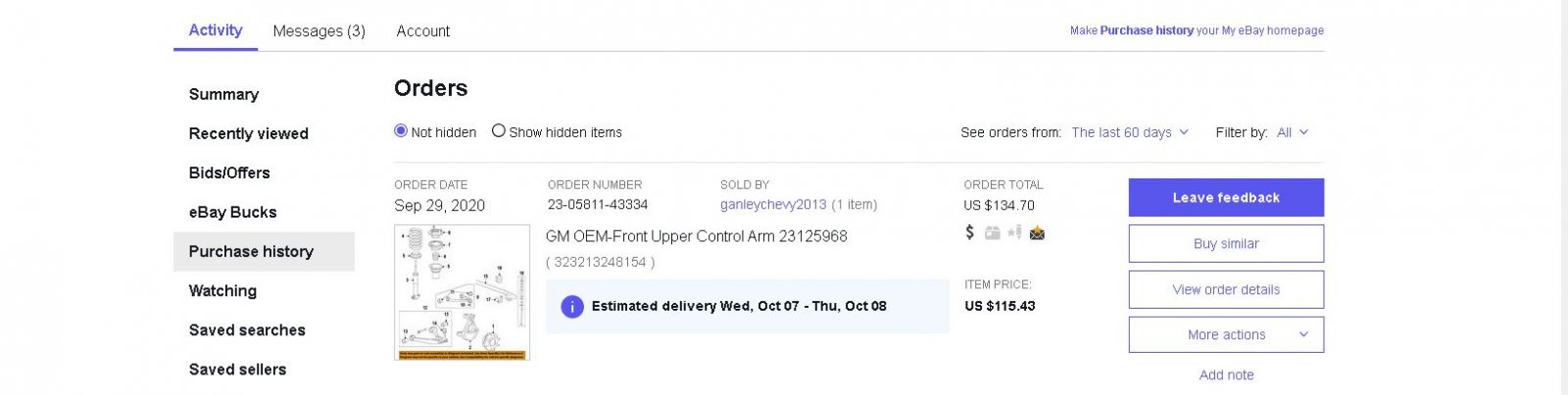

rockauto didn't have the upper left in stock, so I had to order elsewhere, picked ebay and the seller just canceled the order a minute ago so I just bought a clean looking used one out of Texas instead $99 shipped

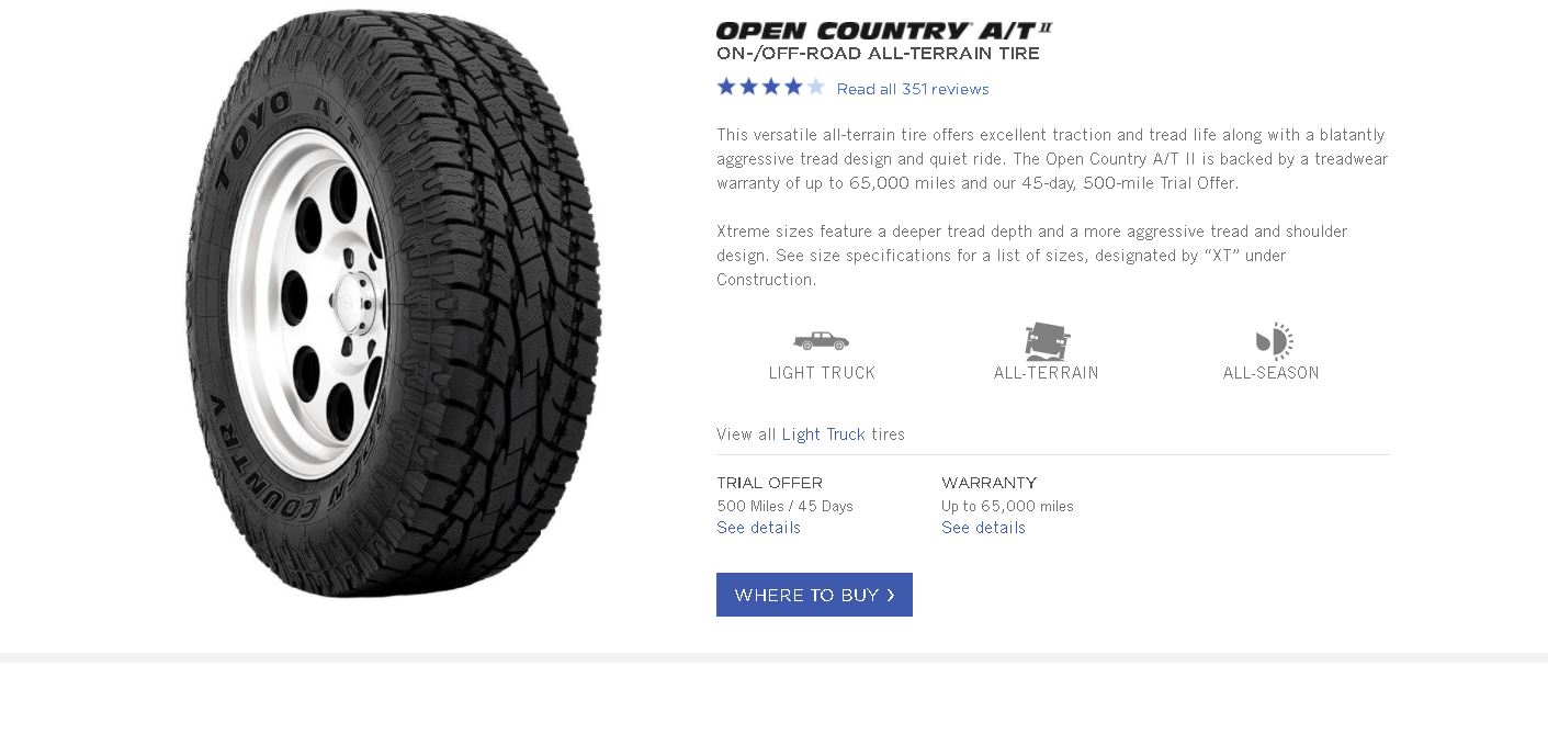

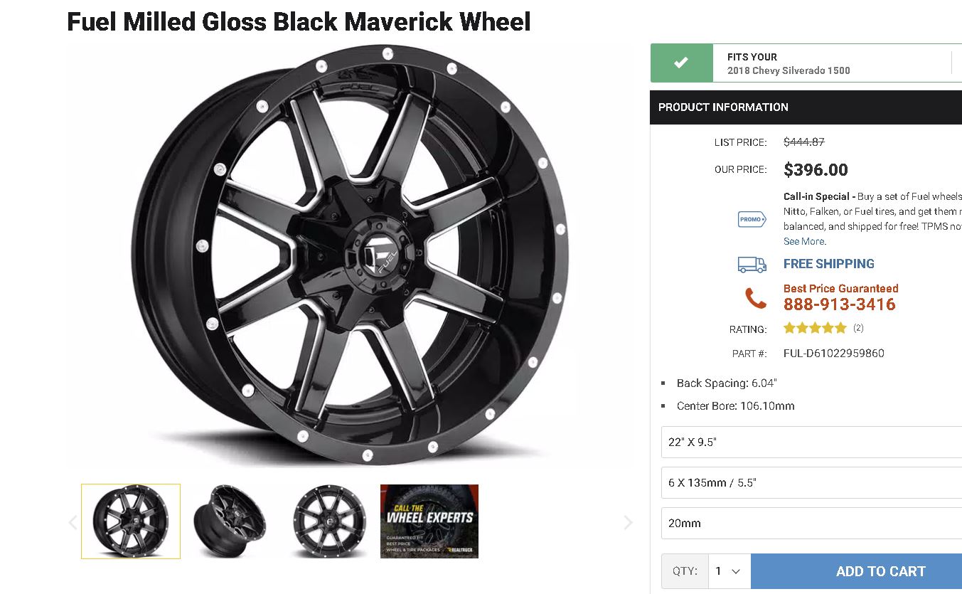

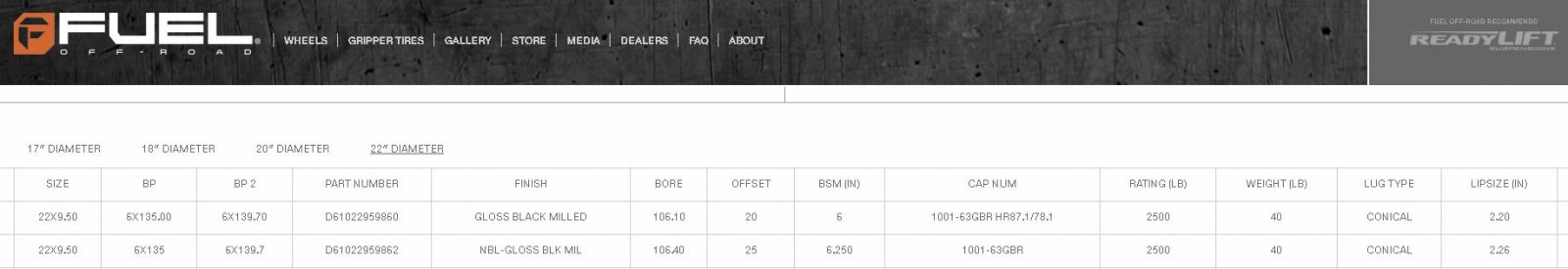

So I am looking at trying to do these wheels and tires, who's good at math @swathdiver any idea what tire height that would give me
FUEL MAVERICK D610 GLOSS BLACK MILLED
22X9.5 6X135MM/5.5" 20MM
TOYO OPEN COUNTRY AT II
285/45R22 114H

Mathematically, 32.10 inches on a nine inch wide wheel. Wheel offset is 11 mm less than standard GM so the wheel will reach 5mm less into the wheel well compared with a GM 22x9 and extend 17mm past the same wheel on the outside. Nice wheels. Those Open Country tires are well thought of too.

okay what about a 325/55r22 ? looking at the pirelli scorpion atr
and that wheel I think comes in a offset of 25 also
