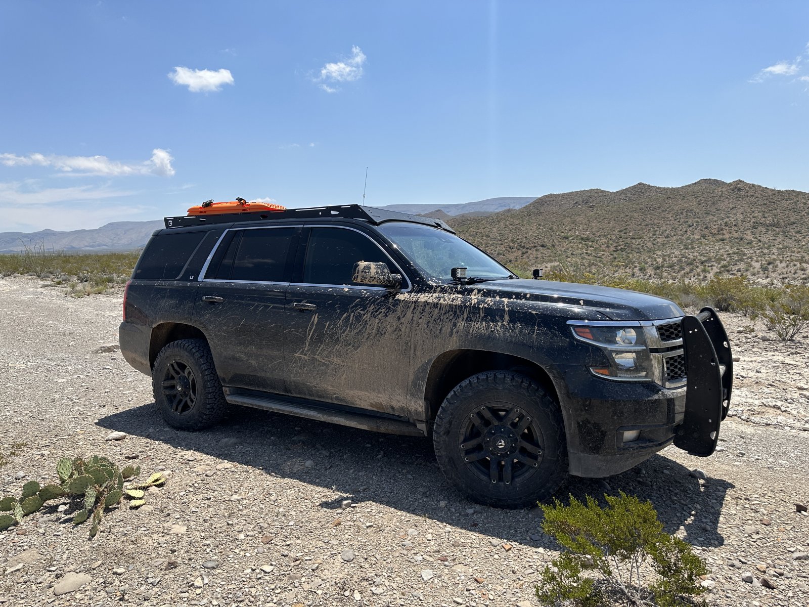

went up with a few people to try out a trail and got hung up on the 1st obstacle, mainly my steps but the frame scraped a bit as well, will have to try again with 35's and sliders instead of steps, backed out and let the rest go by then we went up the mountain a few more miles and went on some roads I could go on spent 3-4 hours exploring so it wasn't a wasted trip, never mind the screaming kid, lol

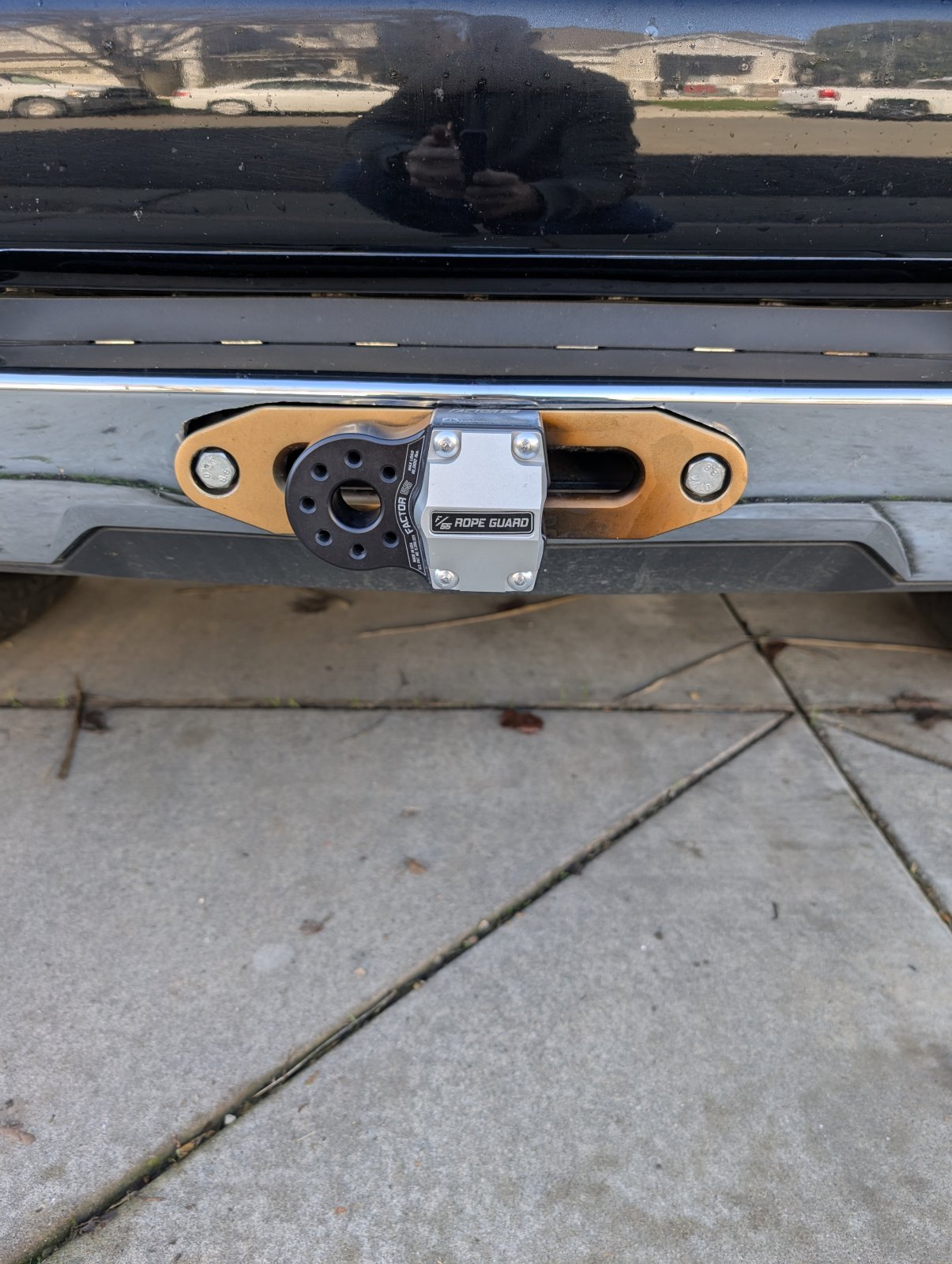

this morning I did install a rope guard on the flatlink to help keep the rope from getting deteriorated by the sun it has to be riveted on, the sun has already faded the rough country fairlead to a golden color it was
Black.....
so I also ordered a new factor 55 fairlead in gunmetal, should be here in about a week

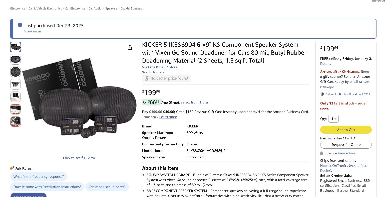

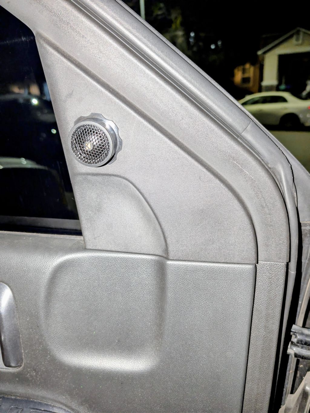

installed the new kicker 6x9 speakers, managed to break one in the process so had to go grab another set of 3-way
so now it is a 4-way component set lol. Actually sounds pretty dam good, certainly louder and I didn't even adjust the amp (yet) not sure if I will need to, the kickers may be more efficient than the infinity's were. Took longer to do than i expected and ran out of sunlight, the kicker set came with 6x9 adapters and they almost fit but the magnet was hitting on the guide for the window regulator so used some metra adapters (they are a little deeper) and it all worked out.
