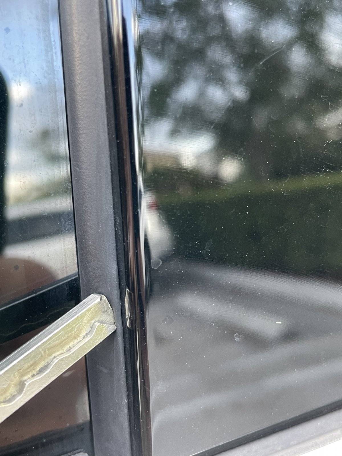

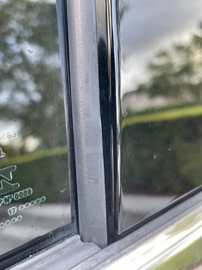

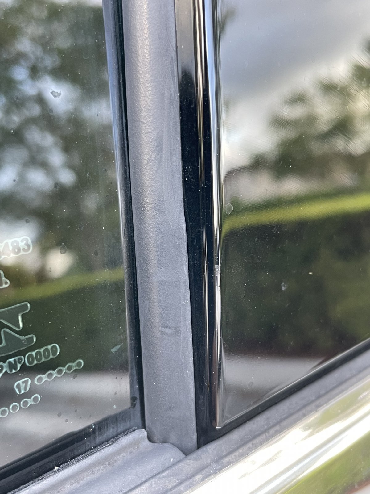

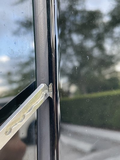

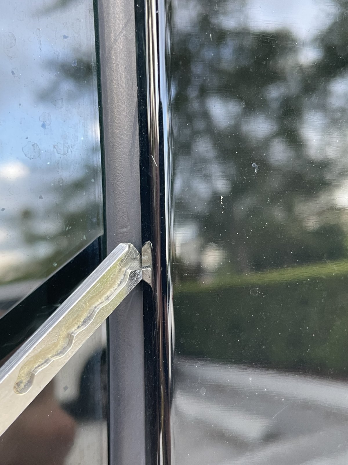

So I searched a bit and only found one thread that came close to my issue.
I noticed the rubber trim between the glass and the plastic trim isn’t “sealing” correctly and it seems it comes up short letting in the wind at high speeds causing the rattle. Anyone else have this issue?

Yes I had that issue. I solved it by applying 3M double sided foam tape, meant for auto applications, onto the interface between the door and the trim.

How difficult is it to remove the trim?

These trim pieces are horrible!!!
+1 on the 3M auto tape. I've used that on 2 of my pillars and that has helped. New trim pieces are $40+ shipping...
Yes, you can remove. DON'T break the clip on the middle back of the trim piece, or it will be worse than when you started fiddling w/ it.

Get yourself a set of plastic trim removal tools. Take your time and work around it with the tools.
