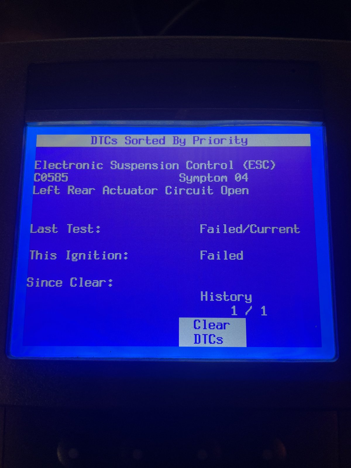

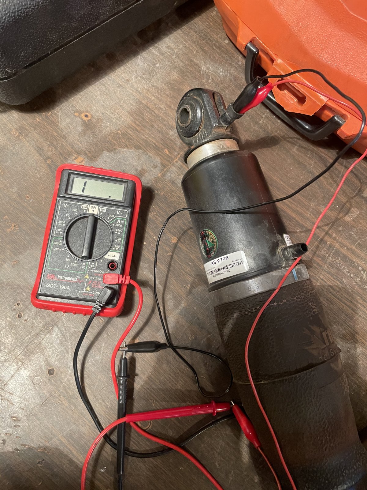

Ugh! C0585
  • Checked the plug > Good
  • Checked the resistance of the shock > Open
  • Plugged it back in and drove to work > No service suspension message anymore.
I suspect a faulty shock.
Going to check the code again when I get home.

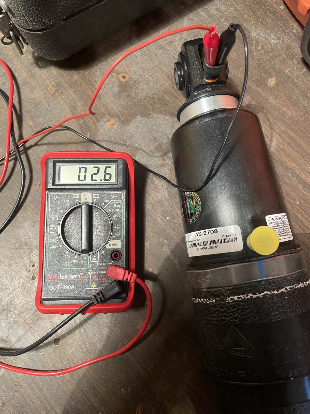

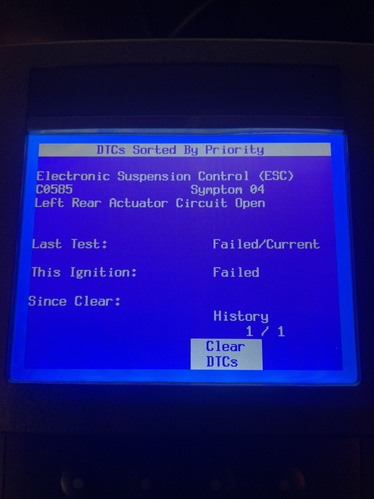

Chasing my C0585 for the left rear. I measured the resistance of the right side and got 2.5 ohms. The left side is open for all practical purposes and requires me to be in the 20k or 200k range to see any resistance. Replacement shock on order from RA.

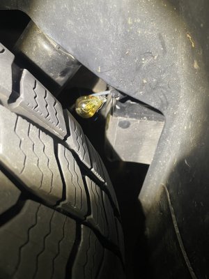

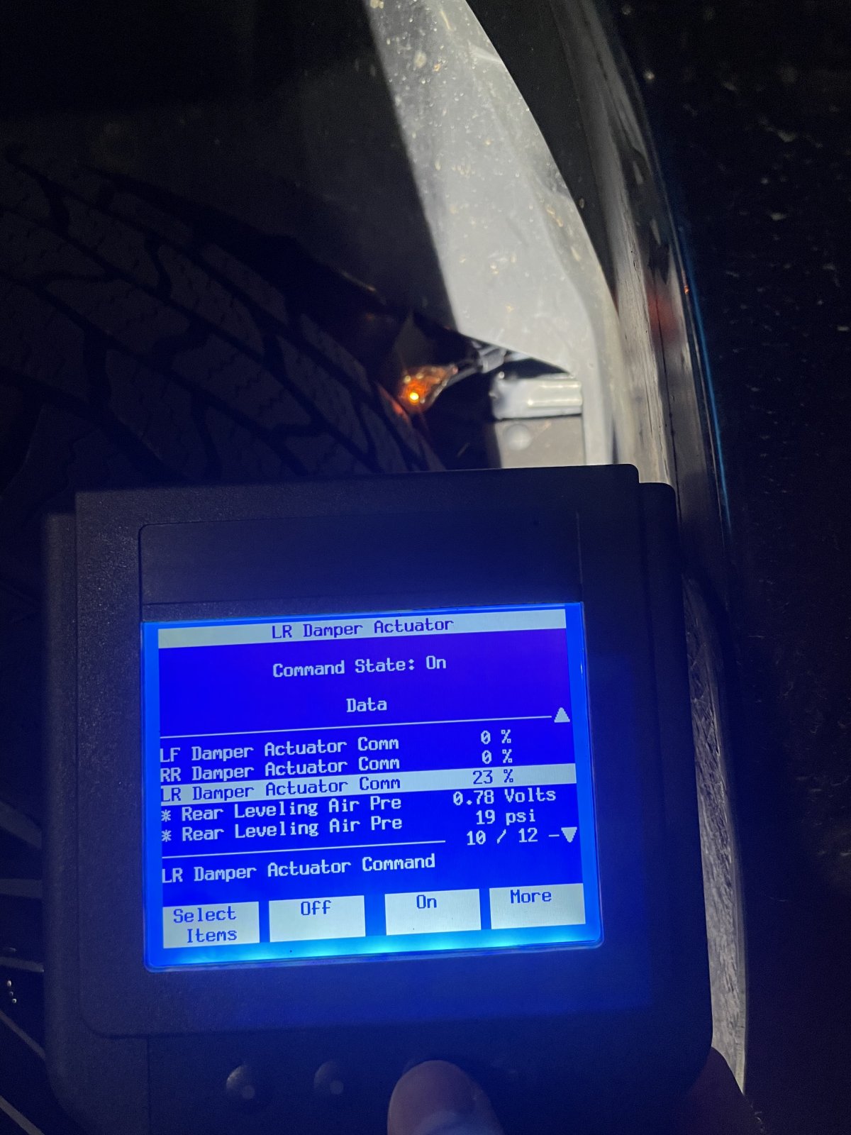

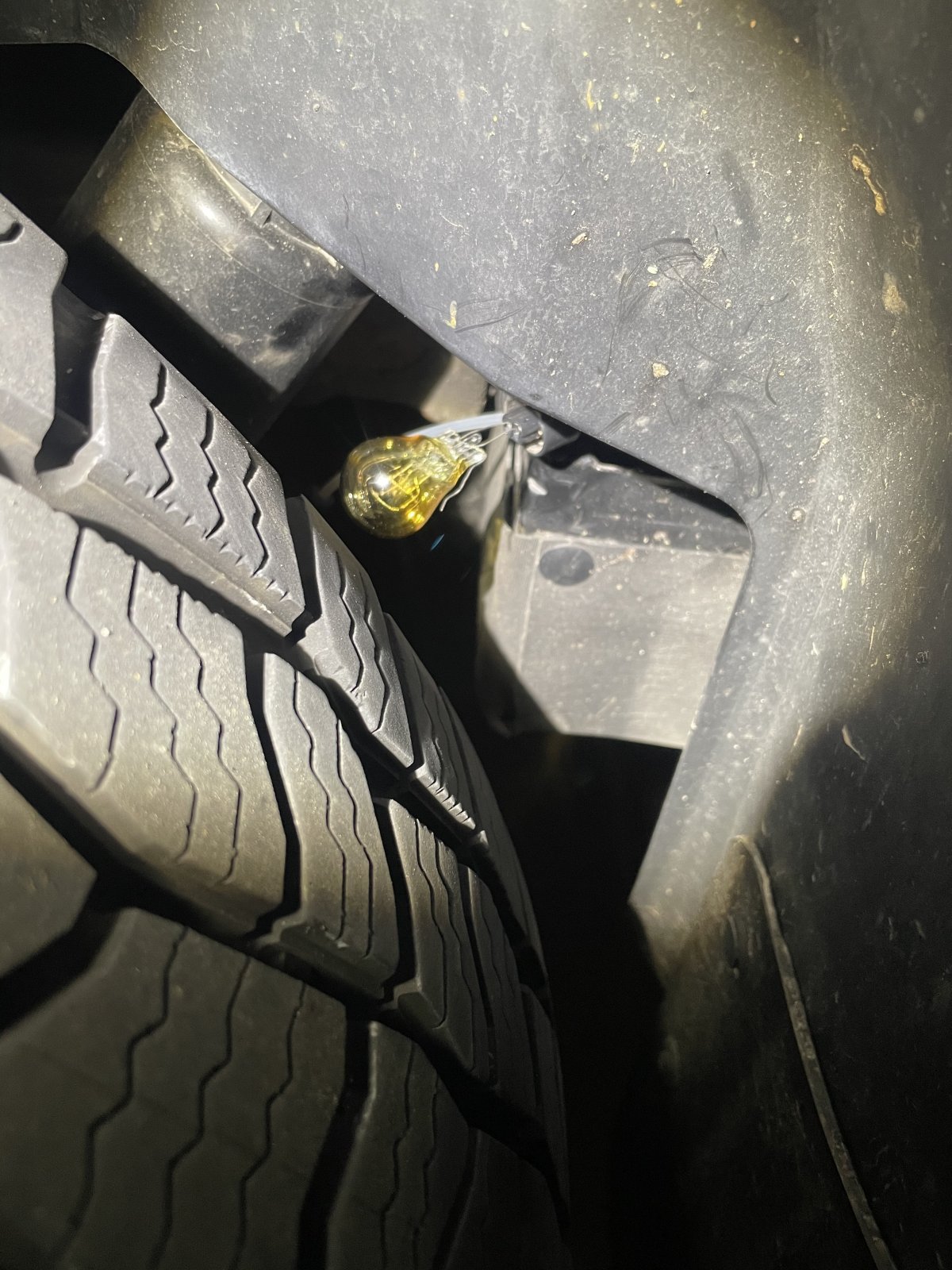

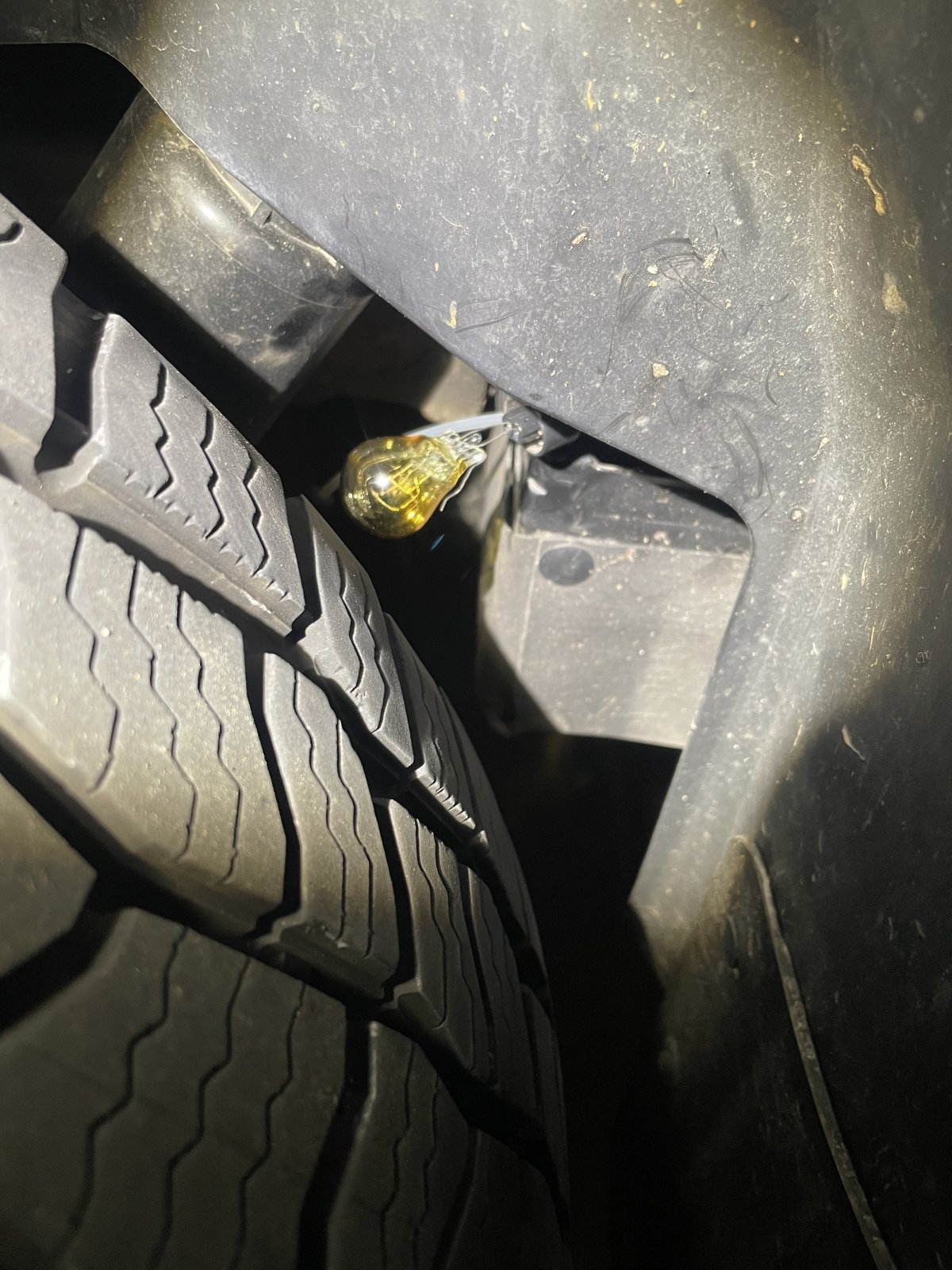

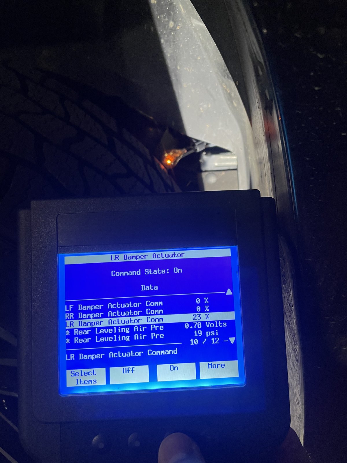

Did a little troubleshooting tonight. When I clear the code it sets again immediately. Since the right side shock measured 2.5 ohms I found a light bulb that measured the same. I plugged the bulb into the connector for the left side and used my tech2 to clear the code and then command the actuator. The light comes on and the code doesn’t set.
New shock is on the way.
View attachment 278417 View attachment 278418
*light bulb goes off in George’s head*
