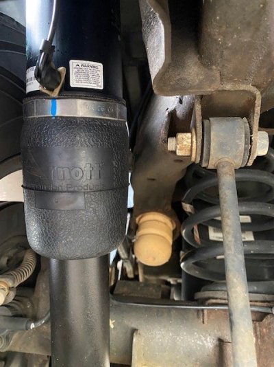

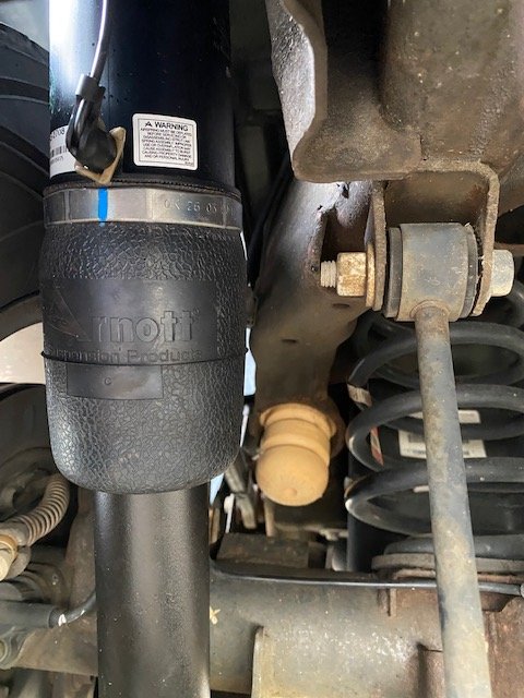

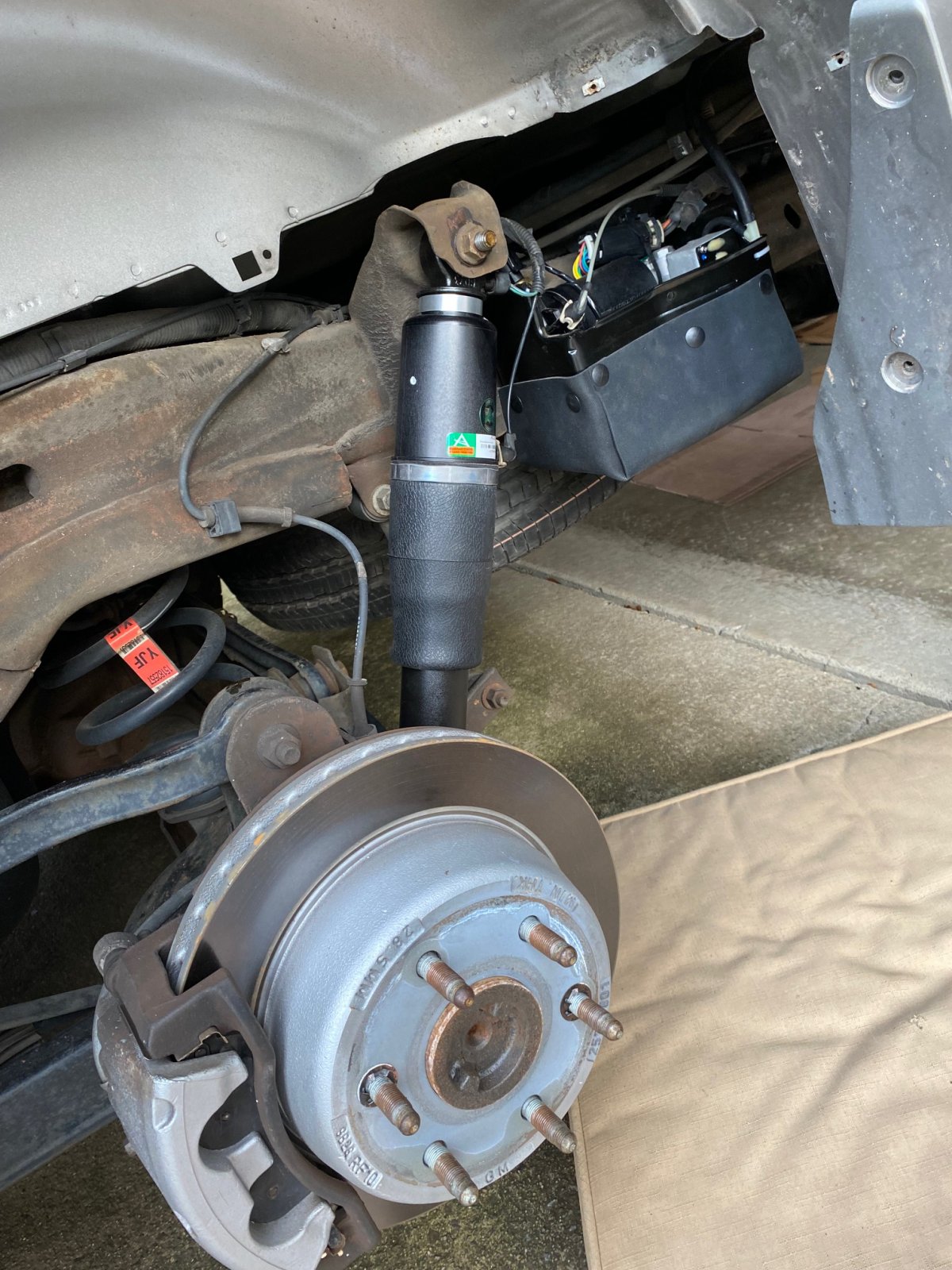

Finally rebuilt my rear Z55 suspension to as near OE as I could afford with Arnott Reman/Original Shocks & P3242 Air Compressor.
Ride is solid in just around town driving so far. The compressor kicks on and fills fast but I haven't loaded cargo or towed yet.
