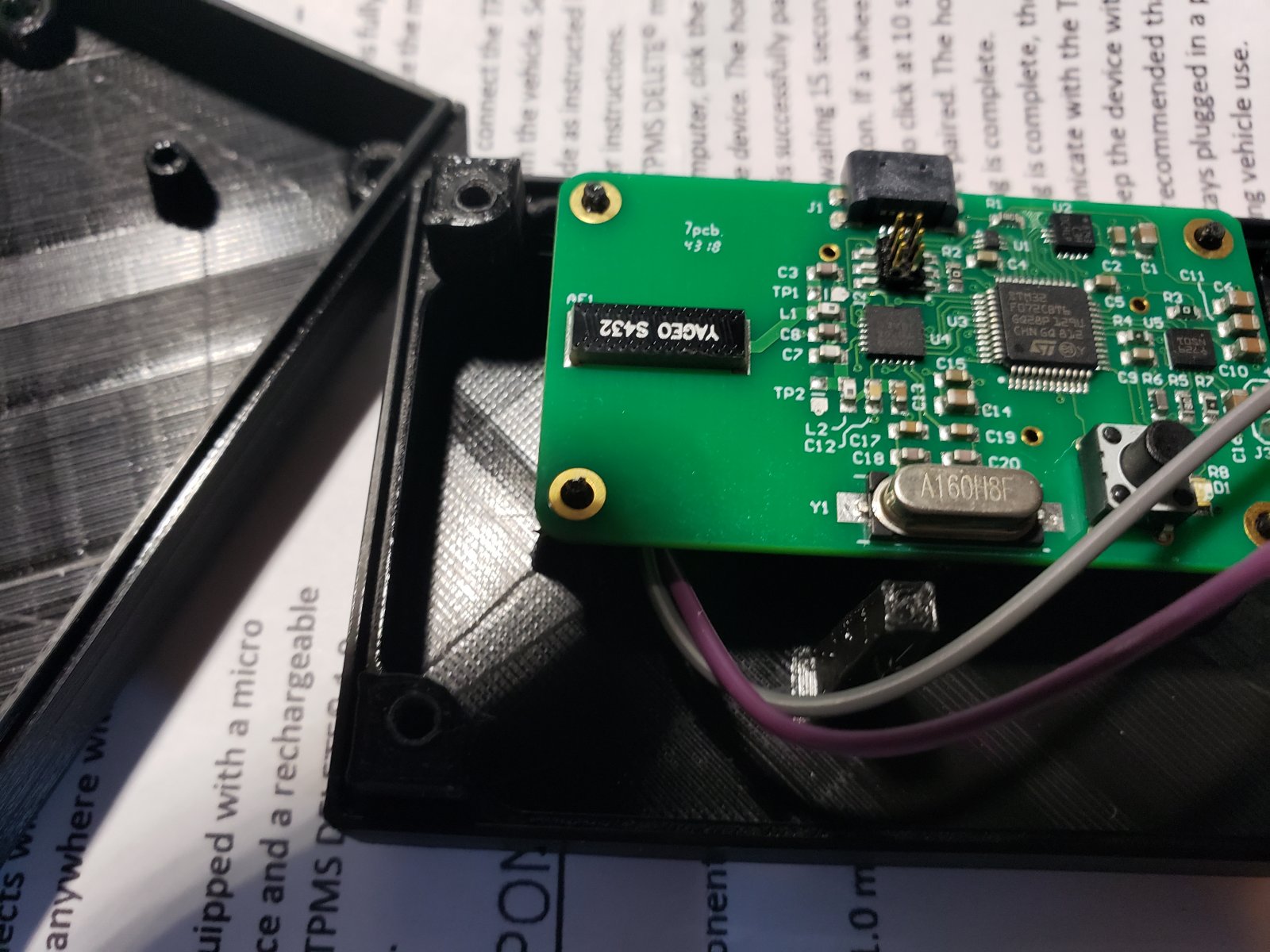

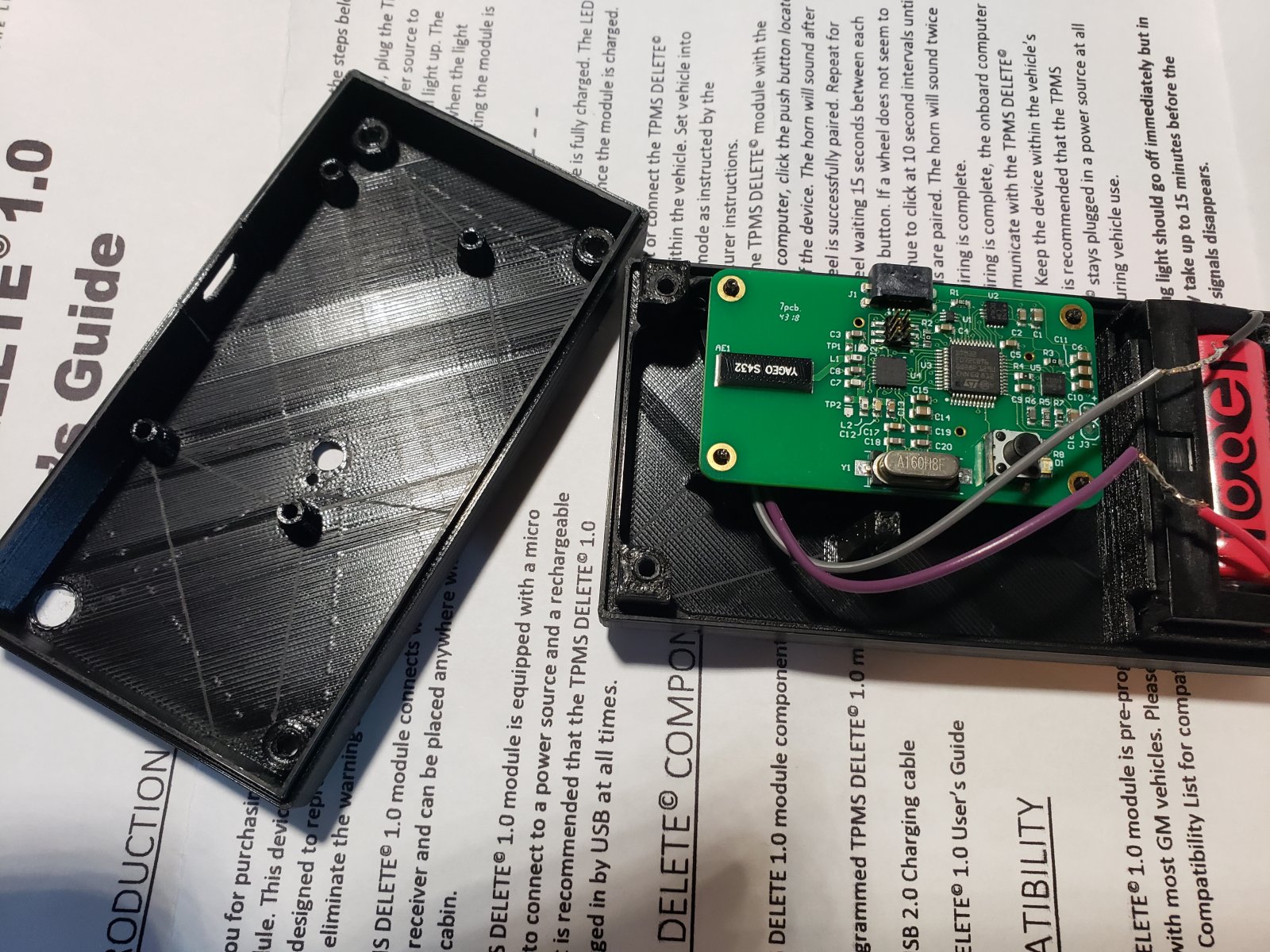

...and here she is in all her glory, open and exposed..;) (now I feel all dirty inside)..
The 3D printing is even more evident, one of the screw barrels fell off when taking out the screws. I would have been more impressed if there was shrink tubing on the exposed wires, but at least there soldered and not just twisted together. Removable battery sled, housing a single rechargeable 16340. Wires are plugged into the back side of the board. PC board actually looks to be well made.
Ive been questioning the use of a 3D printed box until I recently tried purchasing the regular/standard electronic project box from local sources...nope! All gone, not a single box on the shelf due to the China tariffs, and maybe this is why?

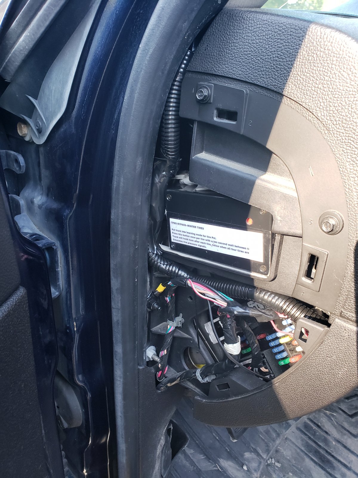

I just installed my box here...
