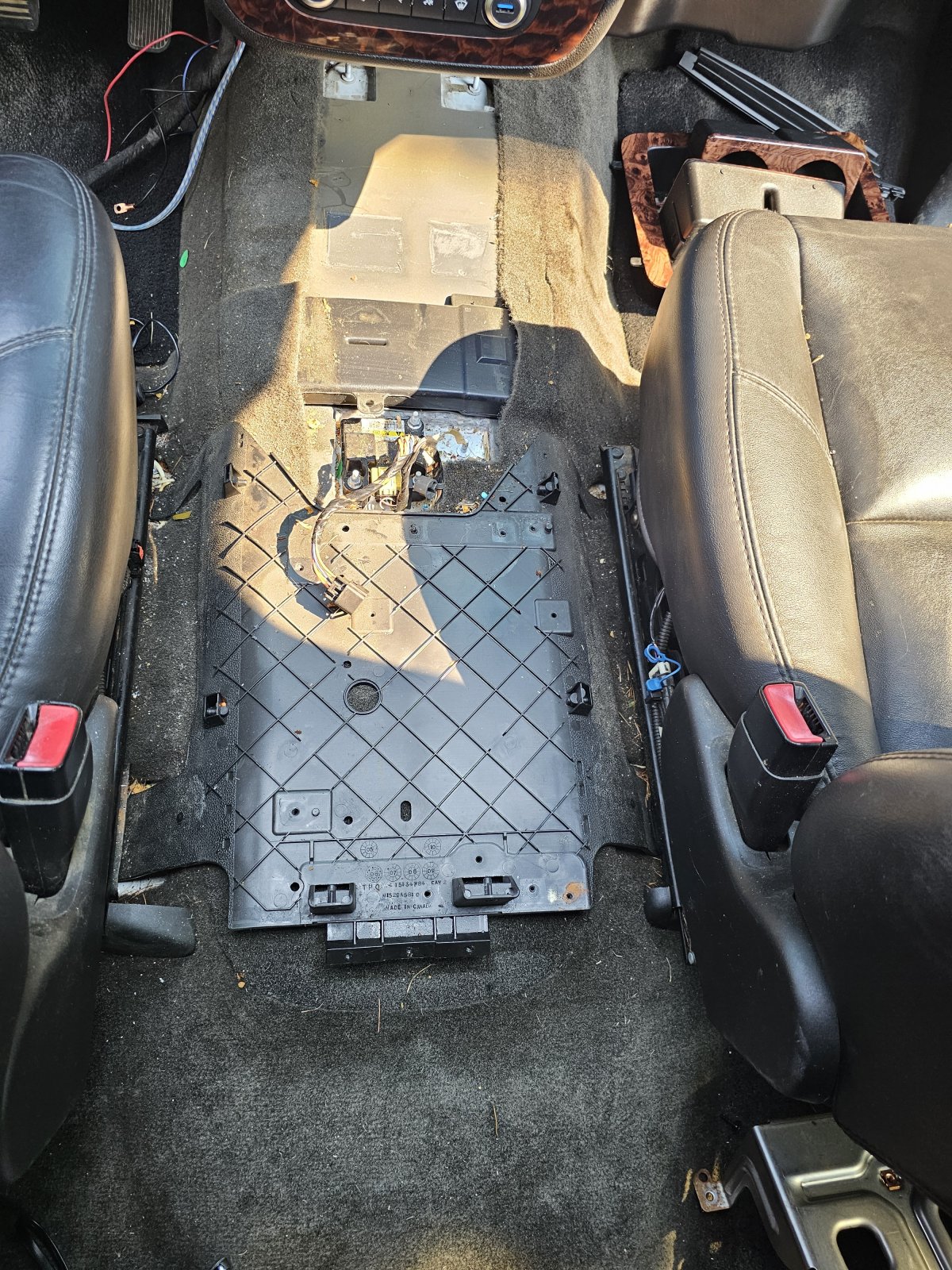

I removed the center console and Bose amp/sub in preparation to install the Pioneer amp.
Little disappointed though as i only found 22 cents and some kinda noodles along with plenty of pine needles. Cleaned it up some and called it good enough.
Now i need to figure out the speaker wires i will need to tie into for the amp.

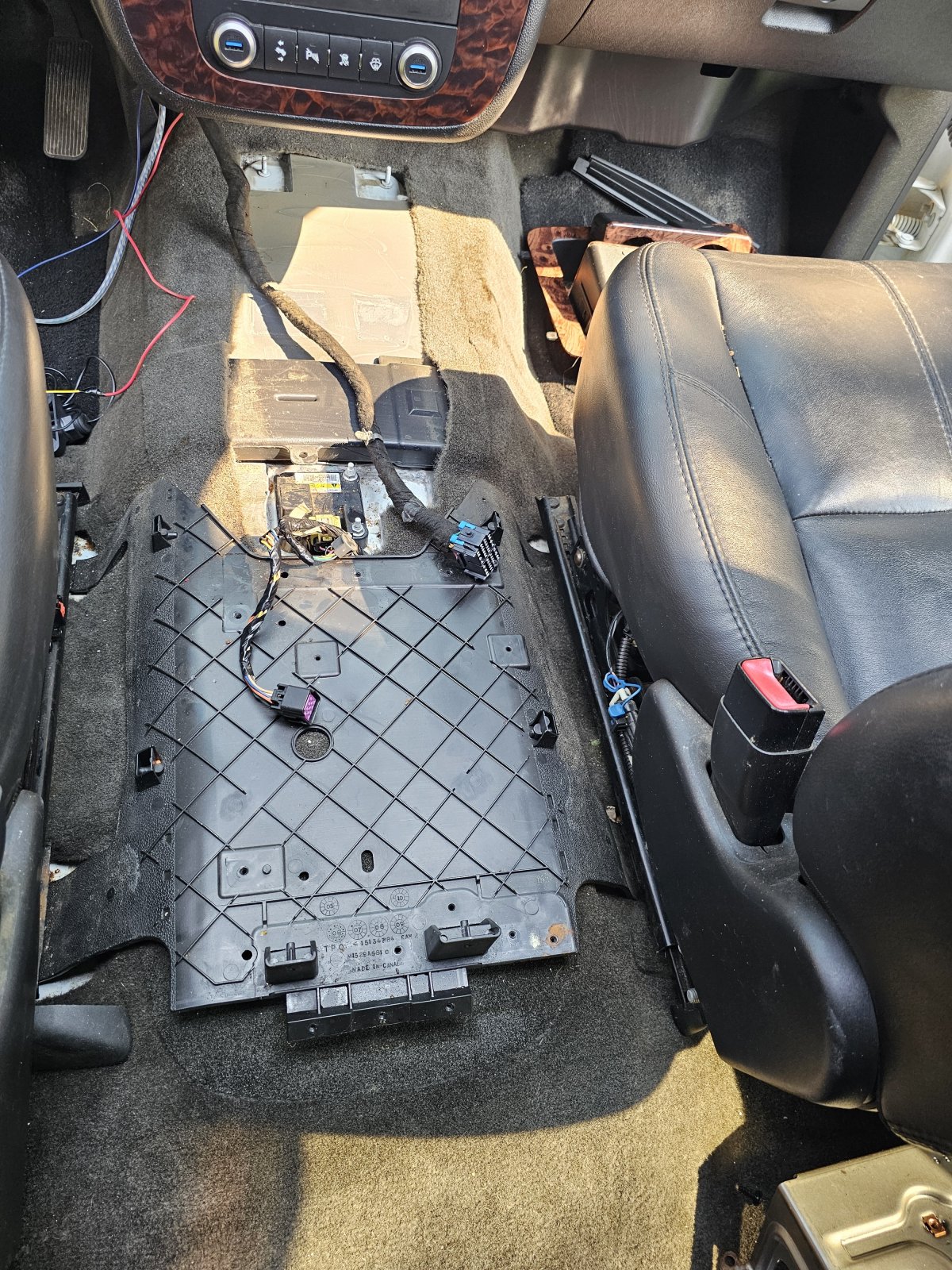

Got the amp installed. Never as easy as you think it gonna be.
Front speakers wiring was no problem. Rear speakers however were.
The wires at the plug for the rear speakers would not power the speakers when testing with a 9V battery. Found them under the dash and still nothing.
I did not have time to trace em out any further as i needed to get it done today. Need Cracker tomorrow and was running out of time today.
Finally ended up just running new wires to each rear speaker.
Before i shoved it all back together, i tested it and everything working as it should. Now that it is all stuffed back in the SWC stopped working and i did test that before buttoning it up.
At least running new wires to the rear saved me from taking the back apart to unhook the D pillar speakers so i guess kind of a bright side.
I did not have time for wire management either so that's all a mess.
Ill take it apart next week. Clean it all up and post a few pics of how i did everything.
So.. Now i have it in i have the amp gains turned all the way down to 0.2v and the output on the radio turned down almost to 0. Plus both front and rear filters are set to band pass as i think i should be able to adjust that with the stereo? Volume sound about right for what a person would expect.
Sounds like crap though and now that all 4 speakers are working it is going to take weeks to get it sounding good again. Im sure when i get new rear speakers ill need to do it all over then also.
Anyway, it's all in and mostly working.

The rear speakers are routed through the audio control on the back of the center console so that you can turn the rear speakers off and listen to the overhead entertainment through the wireless headphones. I'm not 100% sure on the routing but would imagine you could have found the correct wires at the rear audio control... not that it really matters at this point since you already ran new wires.
30,478
47,826
ya if you have the rse panel disconnected the rear speakers will not work
also how did you get the center console out without removing the seats?
To late now. But good to know. And yes, it was unhooked.

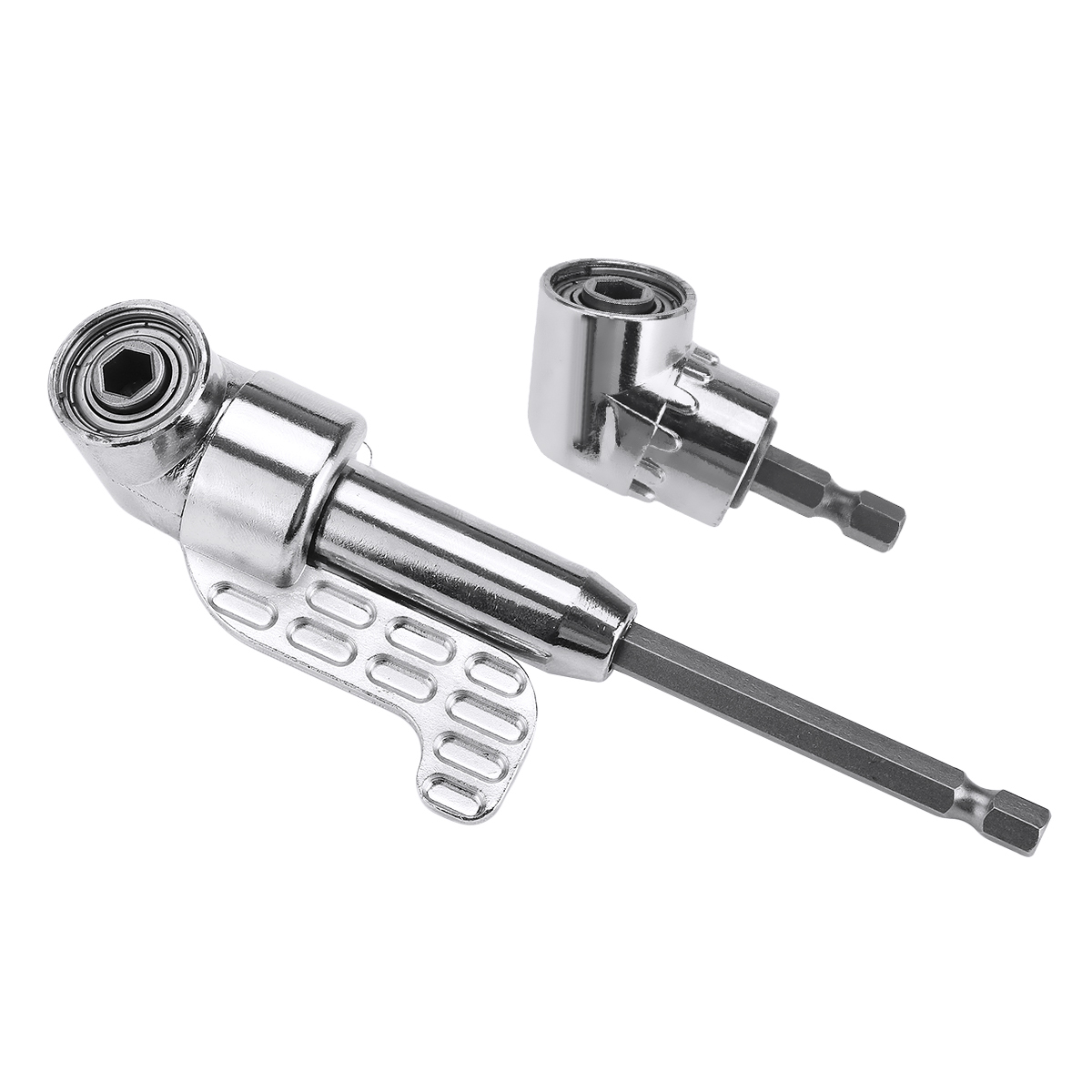

Something very similar to this. Seats all the way back get the two front screws. Seats all the way forward get the back 2 screws.
Aircraft tools for the win!!

I went and checked the RSE plug. Sure enough, the wire colors match the wires at the rear doors. The lt rear colors are Yellow/Brown. rt rear are lt blue and dark blue.
I knew there had to be something going on when the colors were not matching up at the doors.
When i have the console out next week i need to put that amp rse harness back in so the rear heated seats will work. Doubt anyone will be back there but ya never know.
