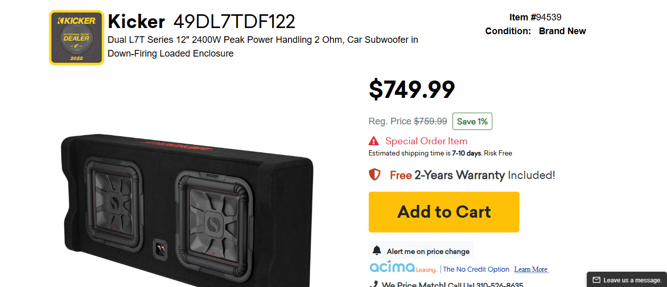

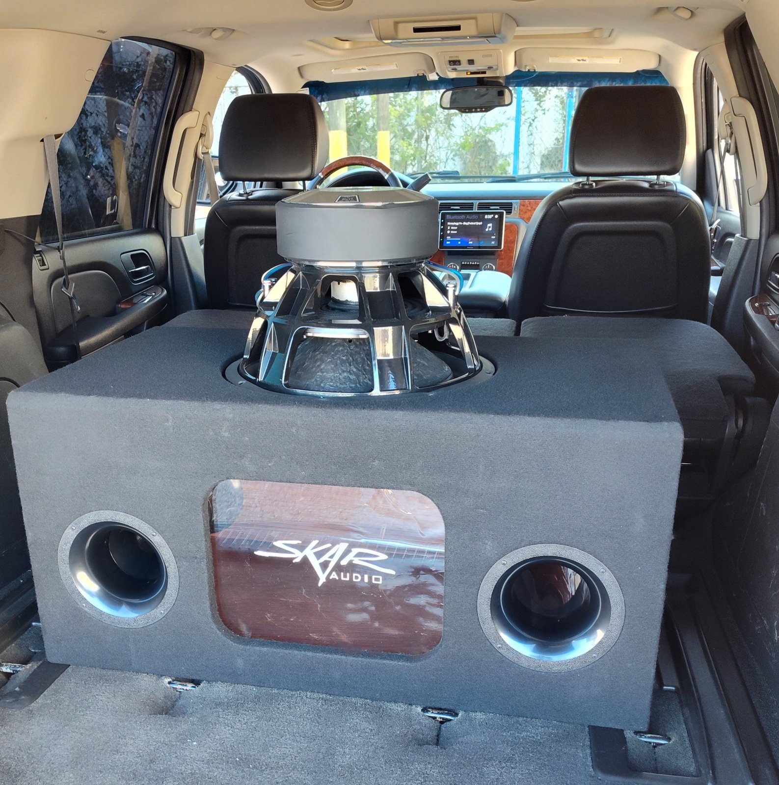

I have been playing with the idea of downsizing my stereo without losing bass output. Might need the space in the future. Although I don't do it as much anymore, I do like the capability of setting off alarms or doing demos for fellow enthusiasts. I have a single Skar VXF-15 on 2500 watts and it definitely gets the job done. If anyone knows how comparable the output of these Kickers are to the Skar please let me know.

Skar gets a bad rap sometimes but i've been running an Skv 2500 for some years now and never had a problem. Doesn't even get hot when i'm pushing it.
View attachment 466448View attachment 466449
You’ll almost never achieve what you have now and it will always leave you craving more bass.
I cannot for the life of me get a slim box behind my seat to hit as hard as a single 12 in a 2.5 cu box in the trunk.
I tried a single 12 in a long slim box. 4 8” subs in a slim box and now a 12” JLw6 in a wedge box.
The jl is pretty good but I’m still not getting that gut punch that I really am seeking.
However at your price range it may be worth while to look into a sub woofer named stereo integrity sql. They apparently pride themselves with great reviews to be a highly capable subwoofer in a small sealed box. They go for about $500 a piece though without the box.
