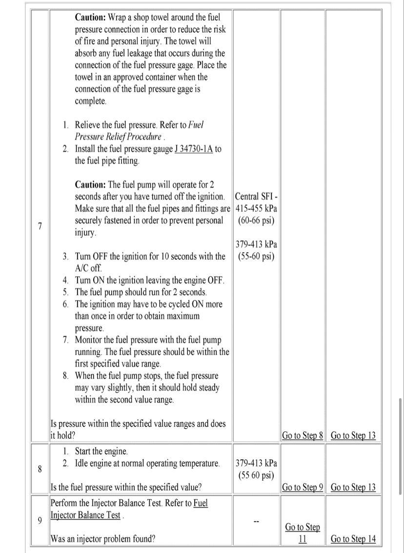

GM’s fuel pressure spec is 60-66 psi, so you’re technically there and any variance within a pound or so could just be an inaccurate gauge.
If you can hear it run and have no further codes or issues when starting, then I’d probably leave the pump alone unless something else comes up.

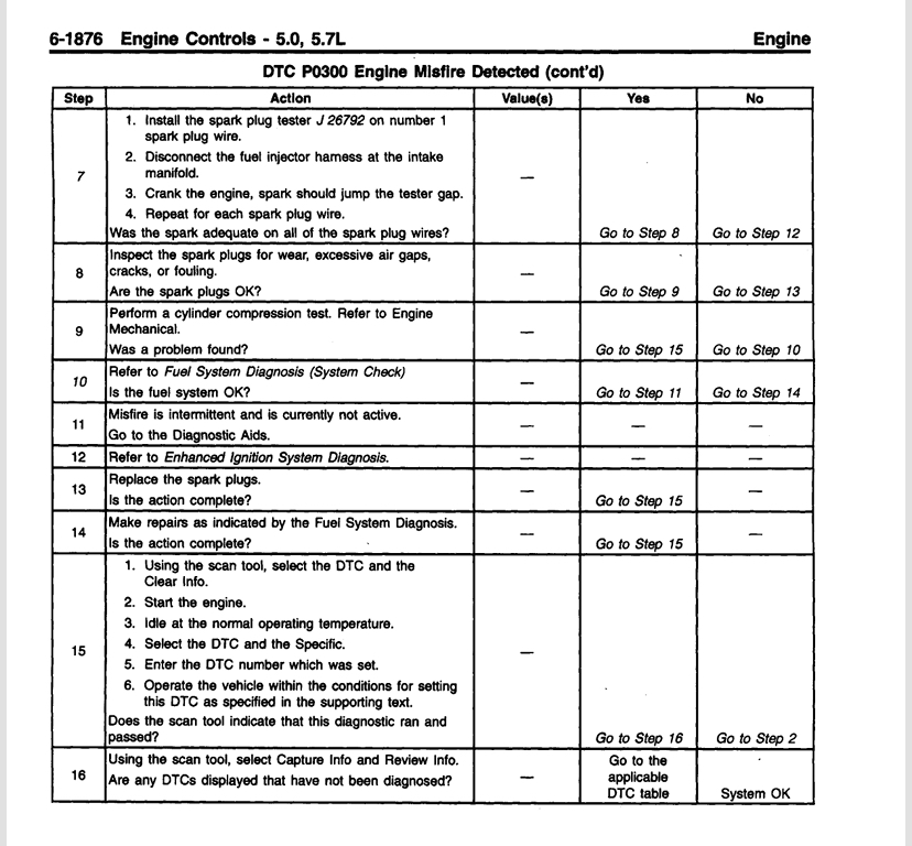

I got the new distributor and cap installed. I verified the CMP retard is at -1.4°, so it's within the +- 2° allowance. Still have the misfire on cylinder 2.
In trying to determine the cause of the misfire, so far have done compression check, fuel pressure check (results a few posts back), swapped the cylinder 2 plug with cylinder 8, swapped the cylinder 2 plug wire with one from cylinder 5 with no changes, replaced distributor/cap (partially because it was the original and the screw tab had broken so the cap couldn't sit tight). The fuel injection system had recently been converted from CFI to MPFI. Everything ran great for the first 400+ miles, until the cylinder 2 issue popped up.
Thoughts on what to look at next?
Besides, those things only fail when you’ve just filled the tank up. Murphy’s Law.

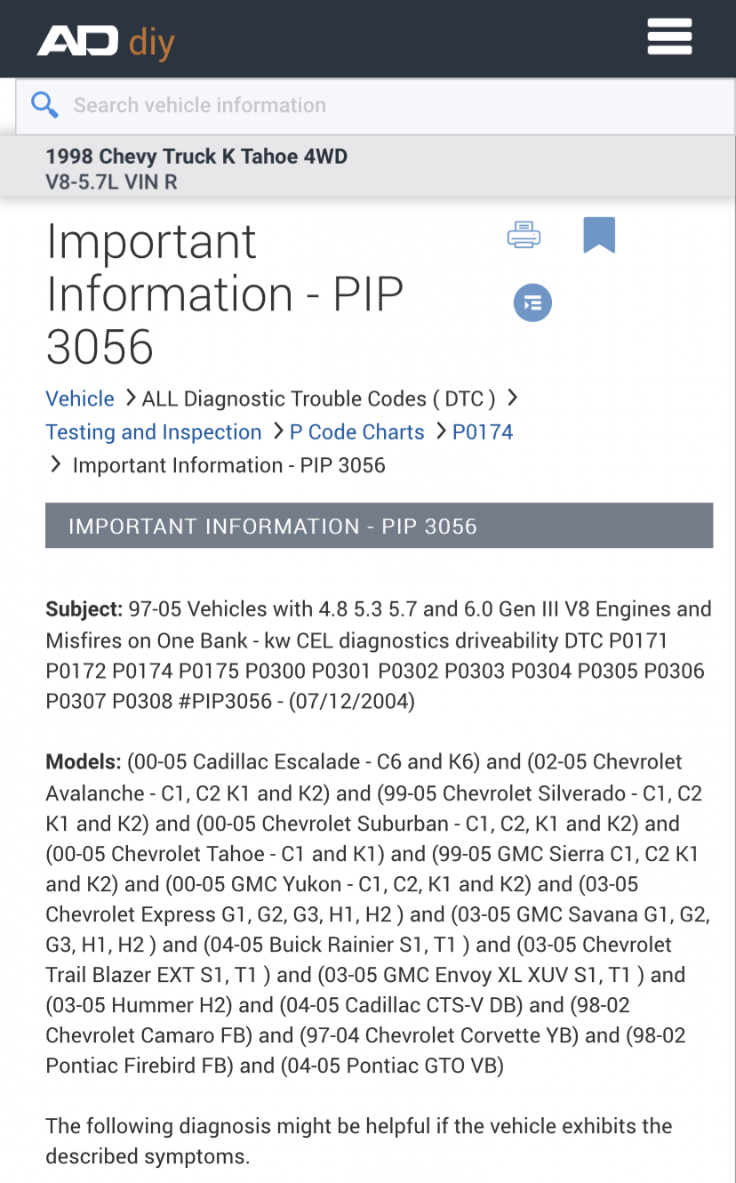

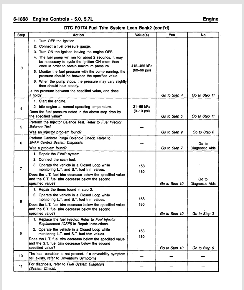

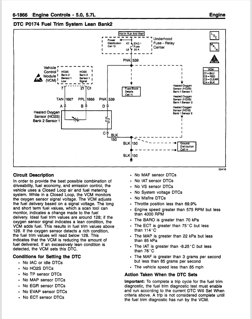

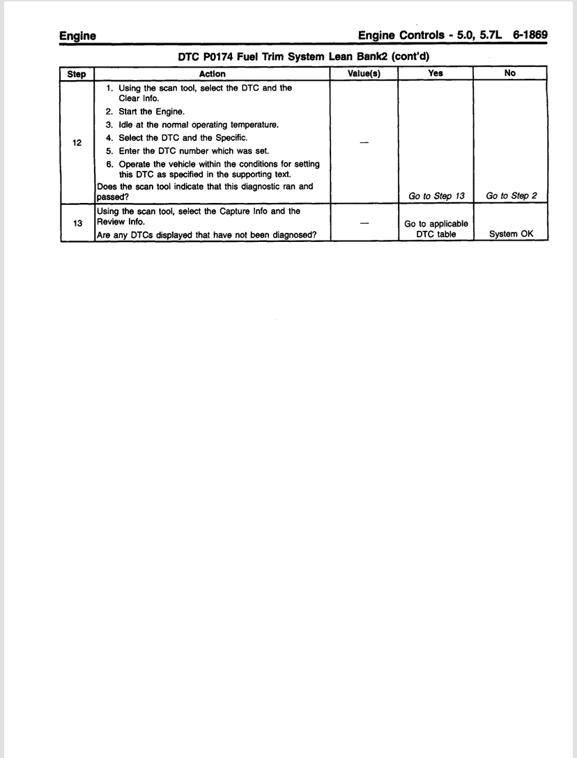

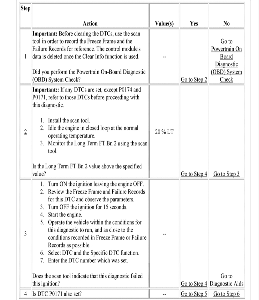

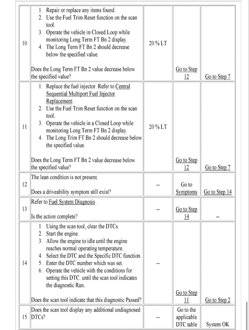

Update: So after replacing the fuel pump, intermittently I am getting P0174 (System too lean - Bank 2) and P0302 (Cylinder 2 misfire). I haven't seen a pattern to it yet. But, I have randomly scanned for codes a couple times while driving and either both codes show up or no codes show up.
I will try to get a log of fuel trims, I have to refresh myself on how to set up the app to log the data.
east302
Dec 21, 2016
1,688
1,688
Mississippi
And last is alldata’s P0174, apparently revised for use with a Tech2 (fuel trim percentages)
