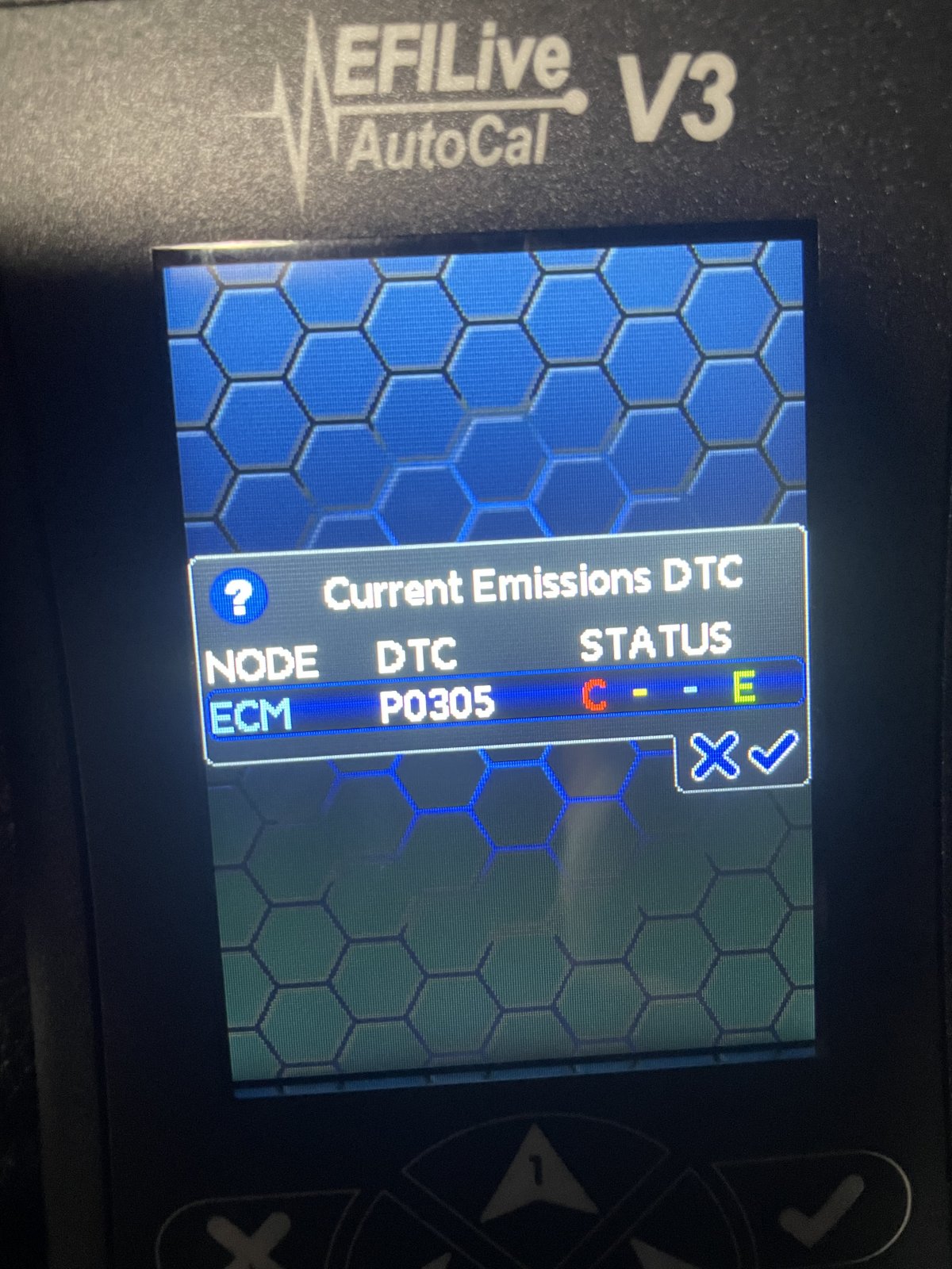

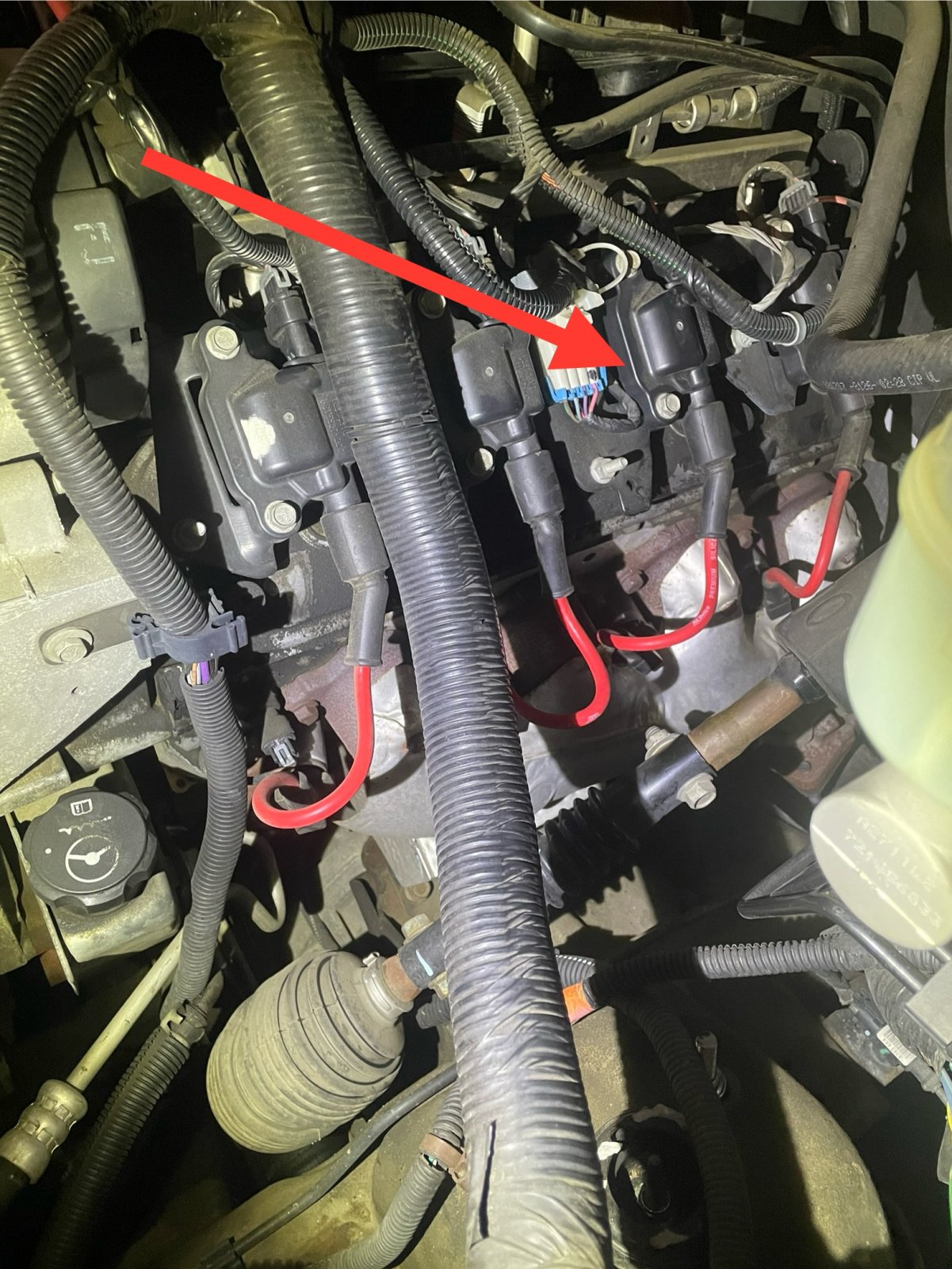

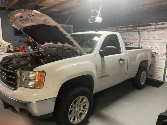

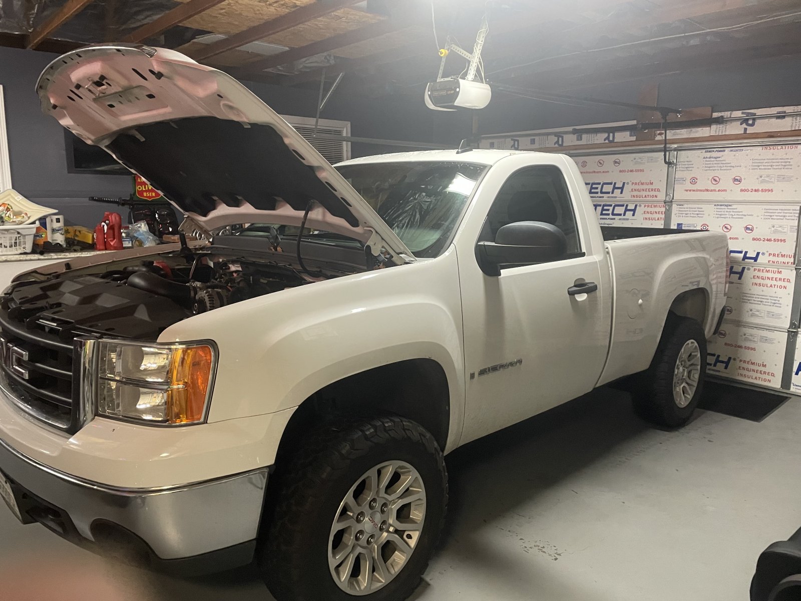

2008 GMC Sierra 1500, 5.3 Vortec. On the clock about 180k miles. Started running a little rough then check engine light comes on. Run the scanner, po305 misfire cylinder 5. I pulled the plug and it looked ok. Replaced it with a different one, no change. Moved some wires around, no change. Replaced coil pack, no change.
Any thoughts on the next move?

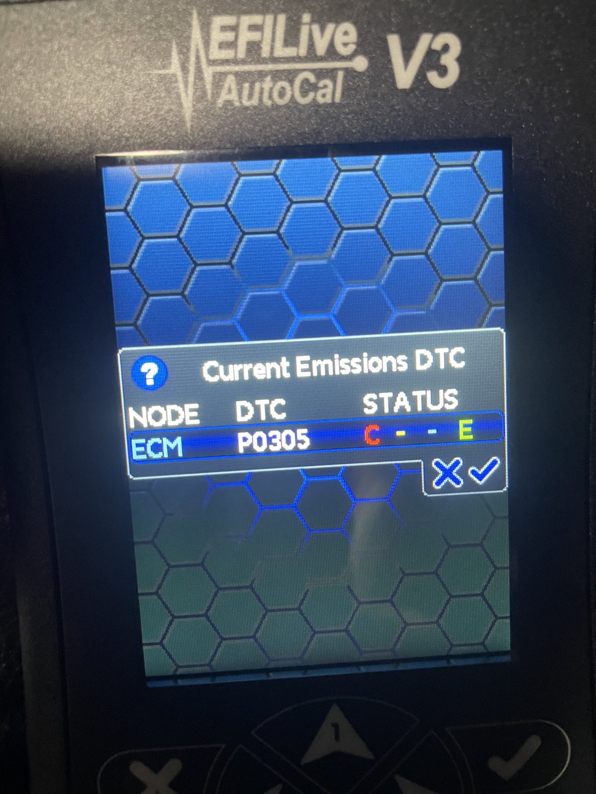

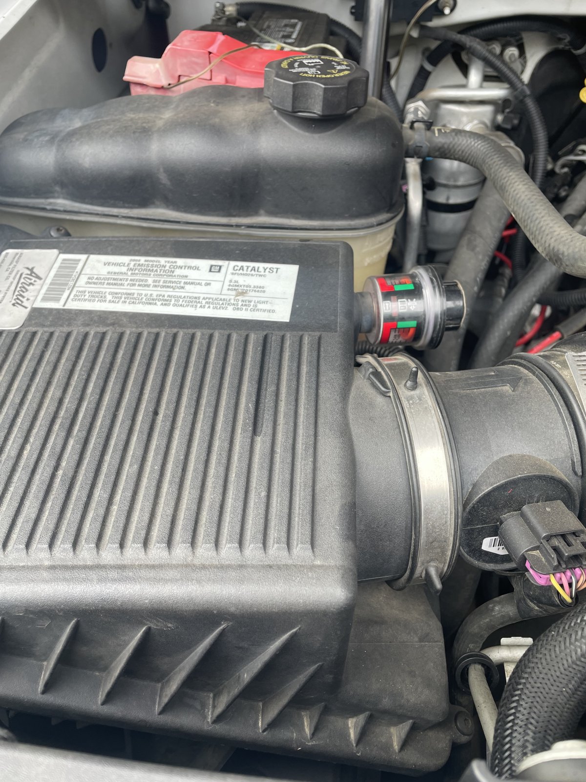

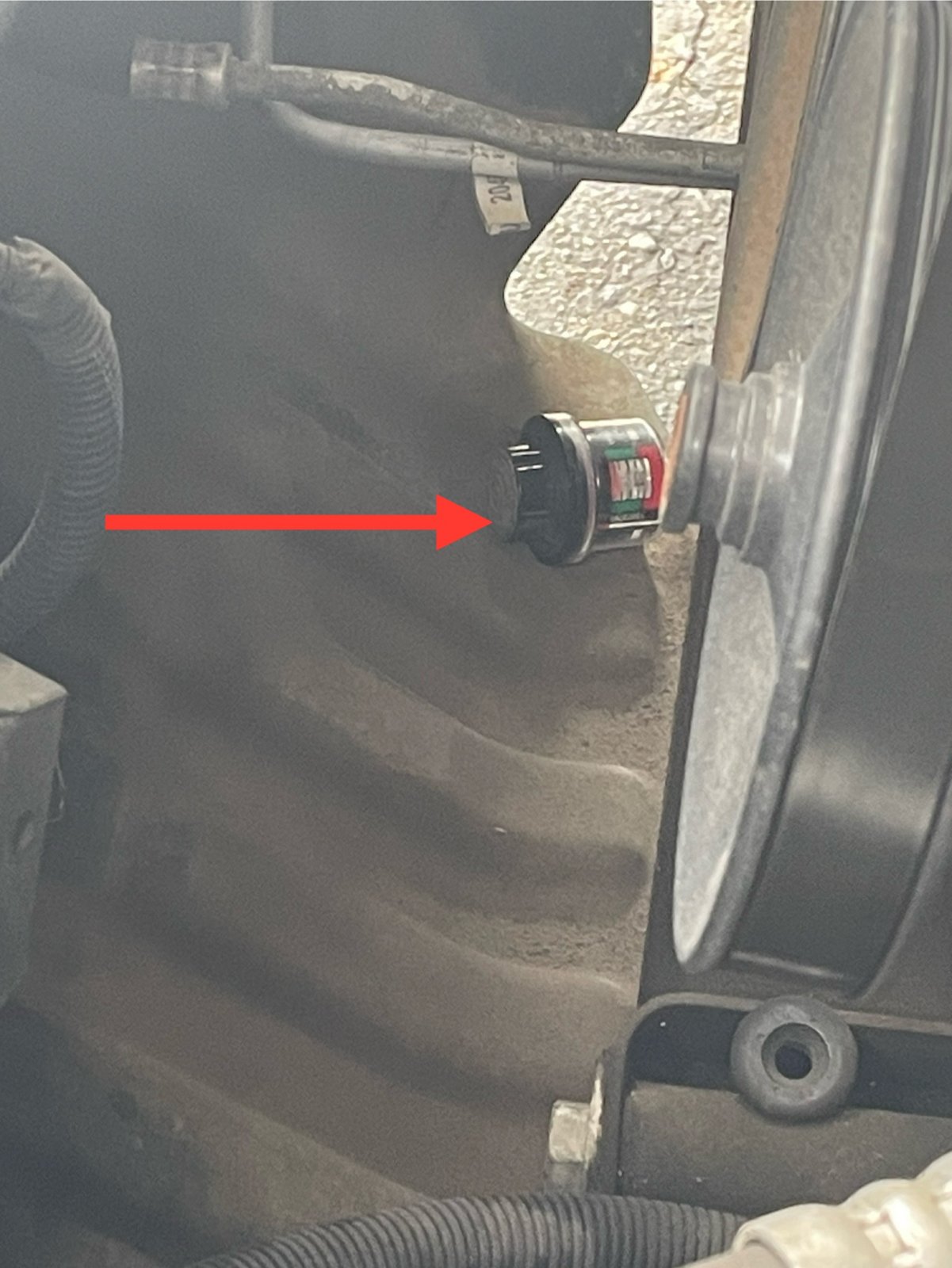

UPDATE: I hope someone can find some humor here. I’m standing there over the engine bay contemplating my next move. Compression test first? Or fuel pressure test? Maybe start swapping wires and coils?
I’m ready to pull the trigger, coveralls on and all. So I look down and at a glance see my air filter indicator laying there at the bottom of the engine bay! WTF? Anyhow… all fixed now. Smooth operator all codes cleared. Back on the road.

UPADTE 2: Yes this is weird. So I put that stupid thing back on, CEL turns off with no codes. Drive it for a minutes and rough rough idle and throttle. CEL back on. I’m leaning towards vacuum leak or MAF sensor bad. My question is, that little air module in there pretty good. How did it just pop out?
Thoughts?
Thoughts?
I have leaned in to look at things and hit that and pushed it out. That should have not caused a misfire. That is why I said what I said.
Maf effects all cylinders. You have a one cylinder misfire. At least that is what you have said. Vacuum leak or plug, IMO. The plug is easy to check, switch like I said.
