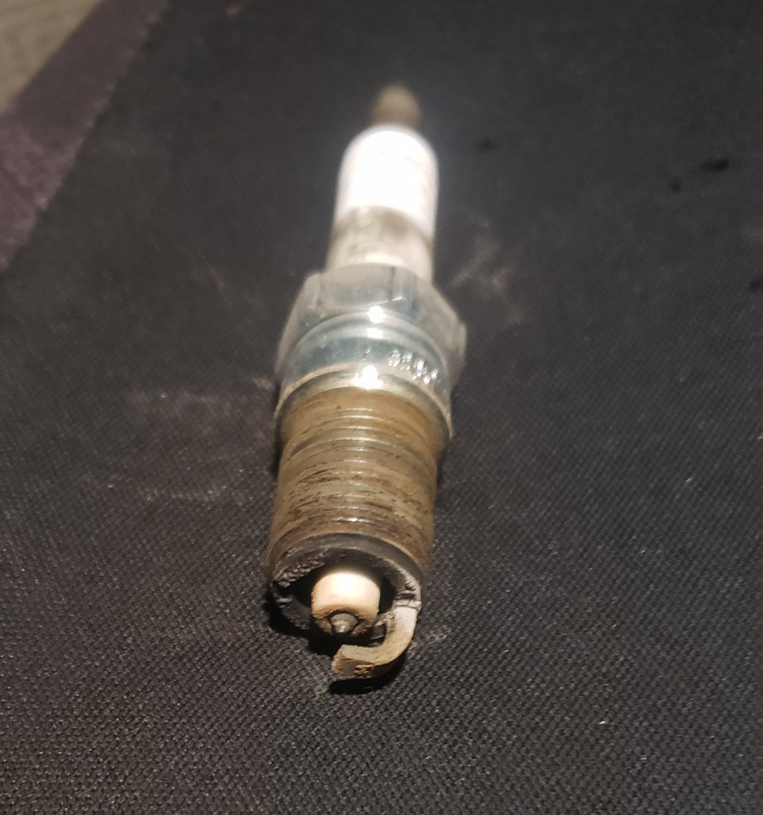

What do the plugs on 5 & 6 look like?
How old are your plug wires?

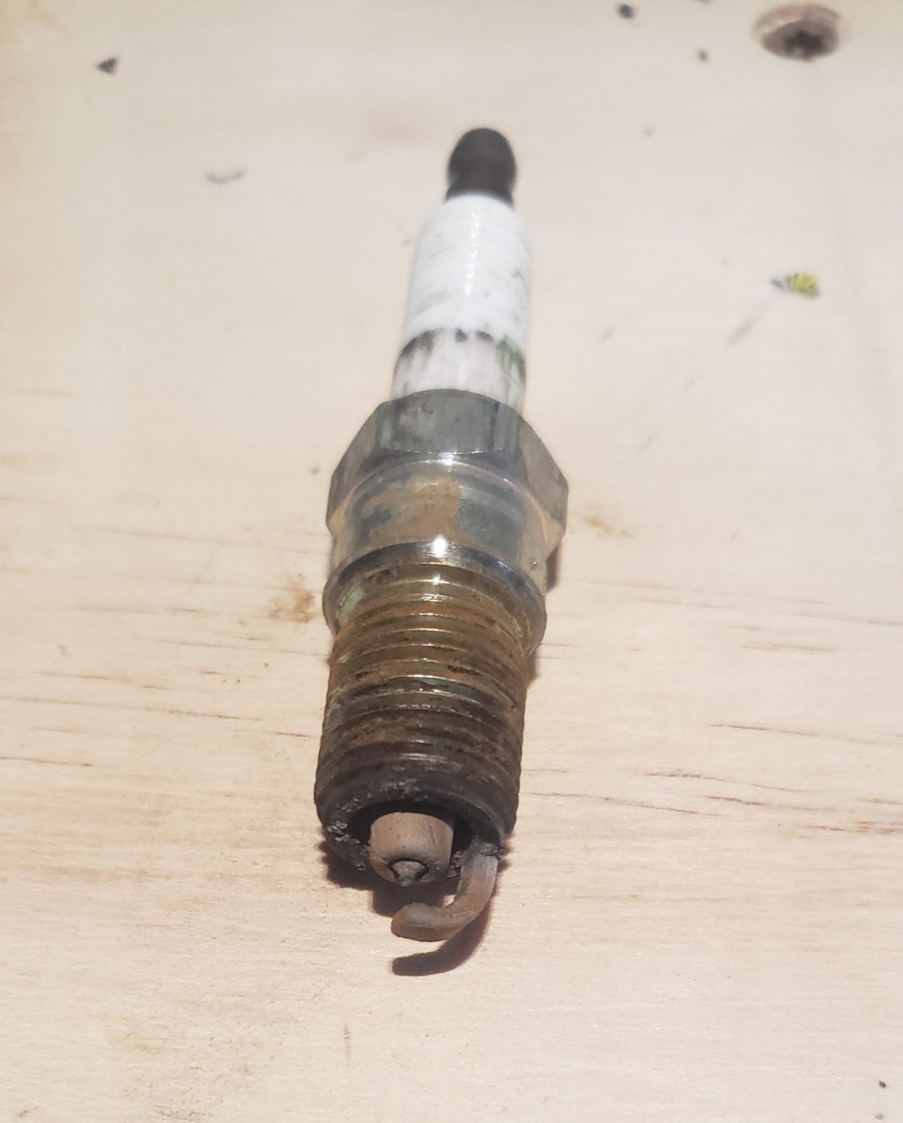

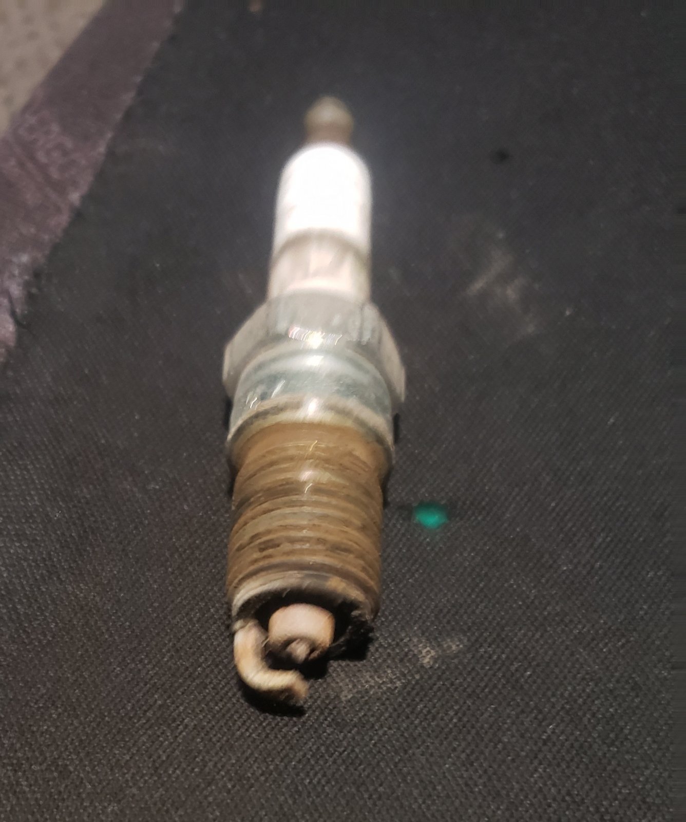

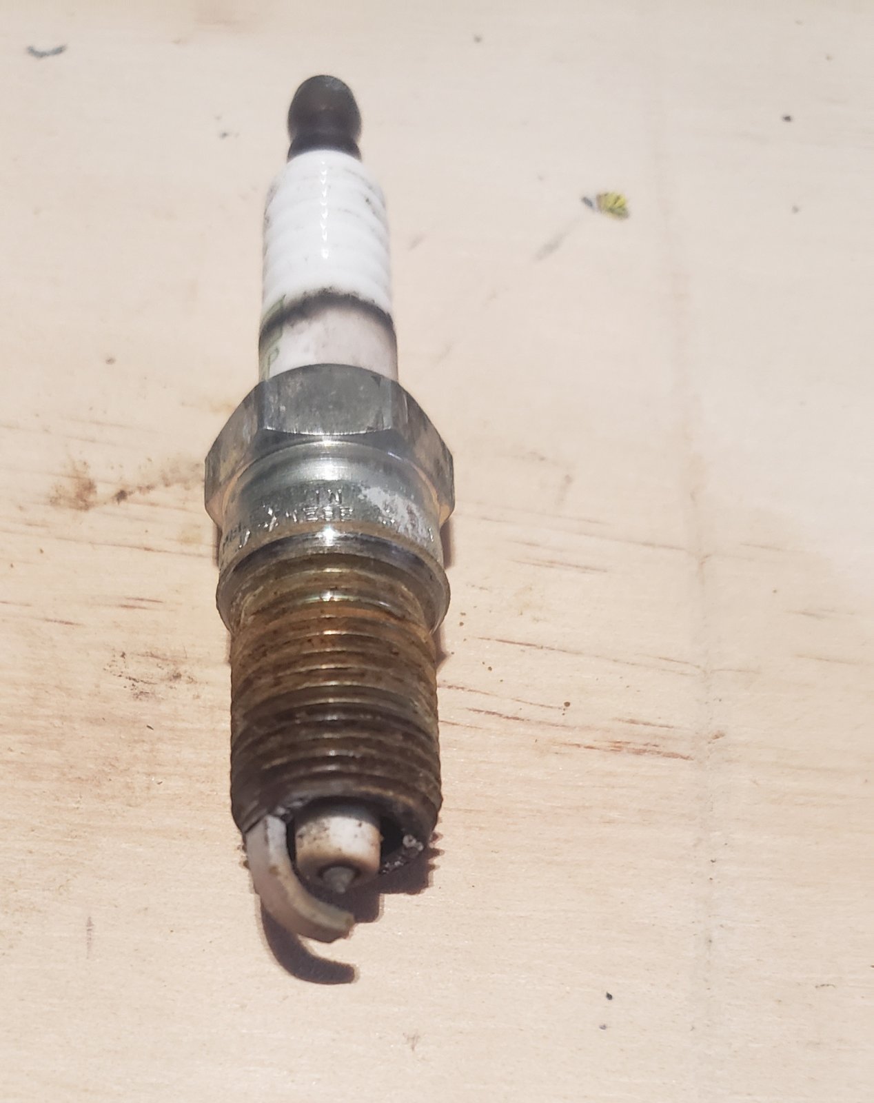

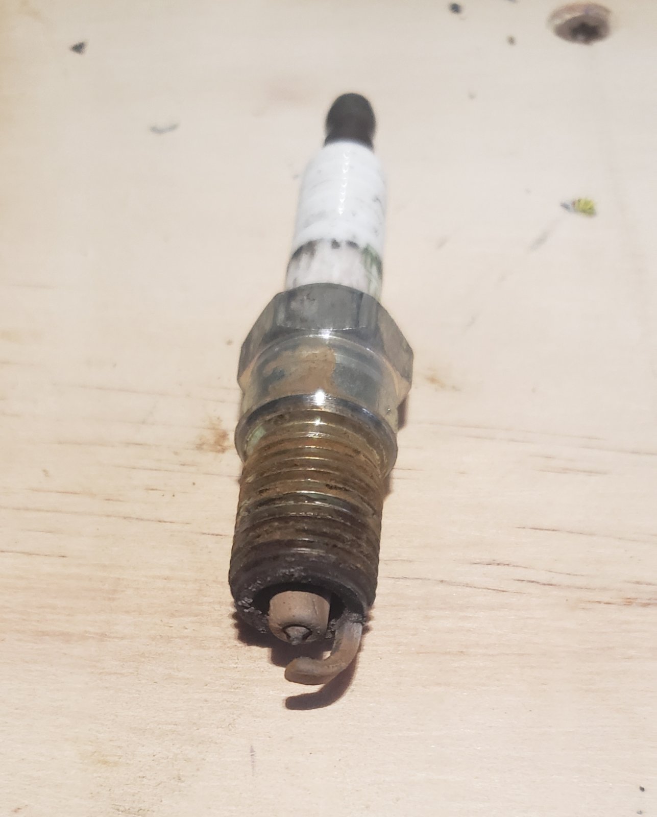

I am going to try and pull the plugs this evening. As far as the wires, I haven't changed them, so the may be original or its unknown.
Edit: here are the 2 plugs. They look as expected to me. Took a wire brush to the threads and put them back in.
Plug 5
Plug 6

I would start by pulling off your cap and rotor. Those are like consumable items on these trucks. Cheap insurance for me is, replace cap, rotor, plugs and wires, and clean or replace air filter.

Poor man's ocilliscope....Get a spray bottle with water and a few drops of dish soap. Have someone lightly power brake the truck while you mist some water around the plug wires. If you have a bad wire it will start missing. Also look at the porcelain of the plugs for any carbon tracks looking for the path of least resistance. As the plug gaps gat bigger it increases the load on the ignition and the additional voltage will jump to whatever is easier.

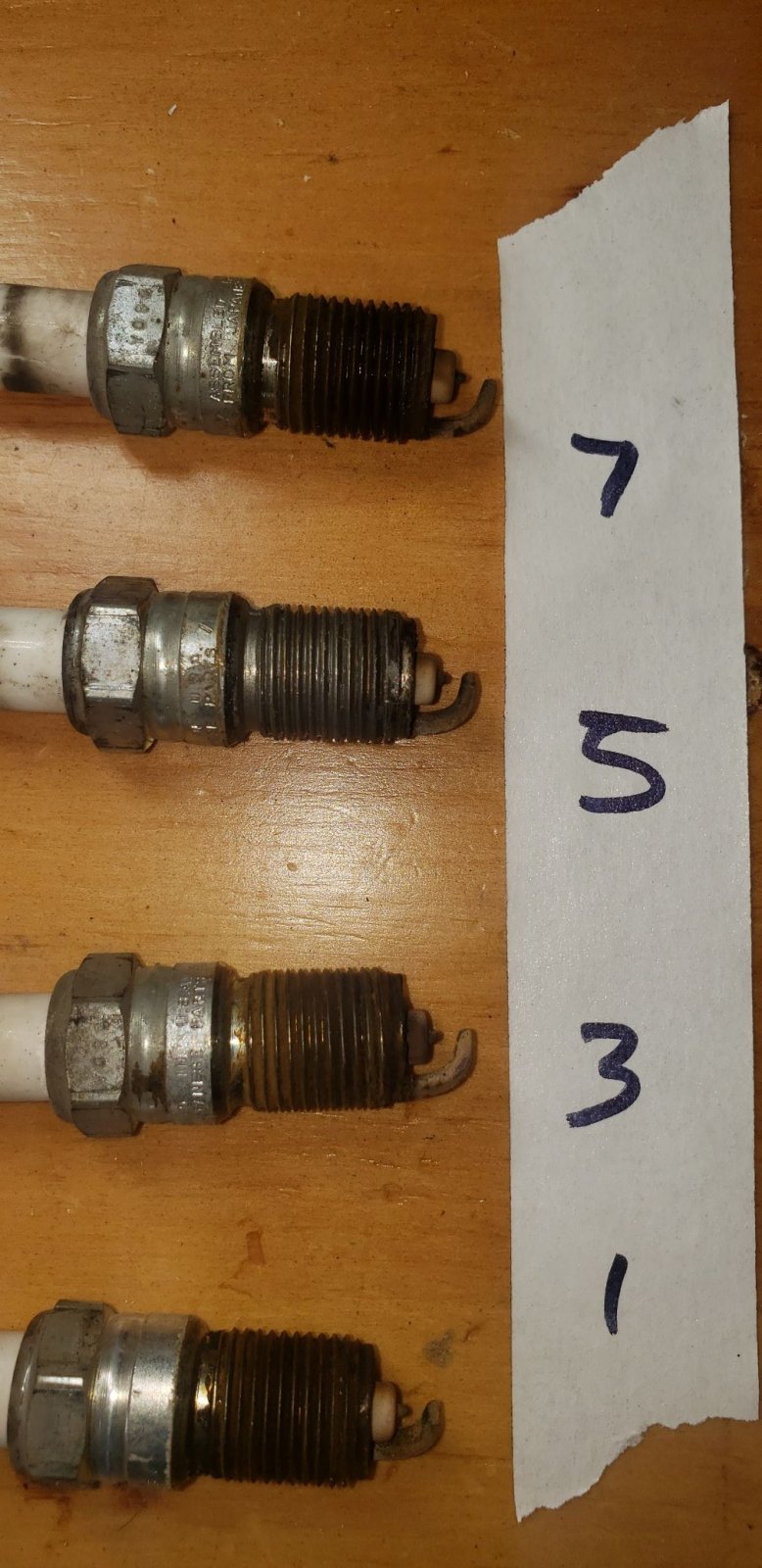

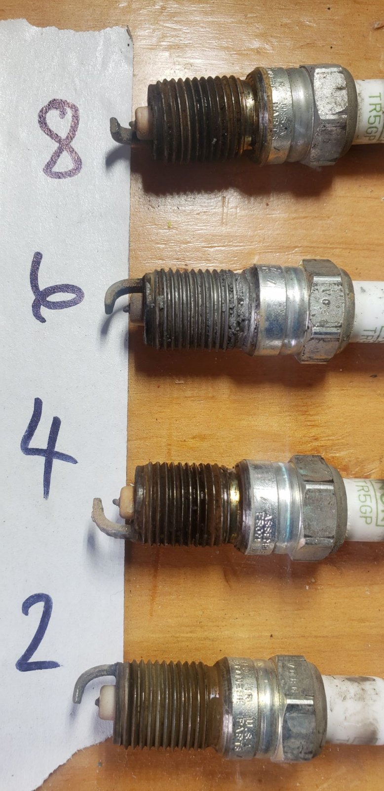

Then out of nowhere, I started getting pretty consistent misfires on cylinder 2 once it warms up. Any suggestions to look for? I checked the plug wire and it's not loose. I am going to try and pull the plug this evening (work hours have been crazy the last few days).
And since you asked, here are the 8 plugs when I pulled them out.
What has been said. Replace plugs, cap, rotor and wires, especially since you think the wires may be OE. Deposits on those plugs and would love to see all 8 plugs when compared.

What is your plug gap? I don't see any anti-sieze on the threads either.
