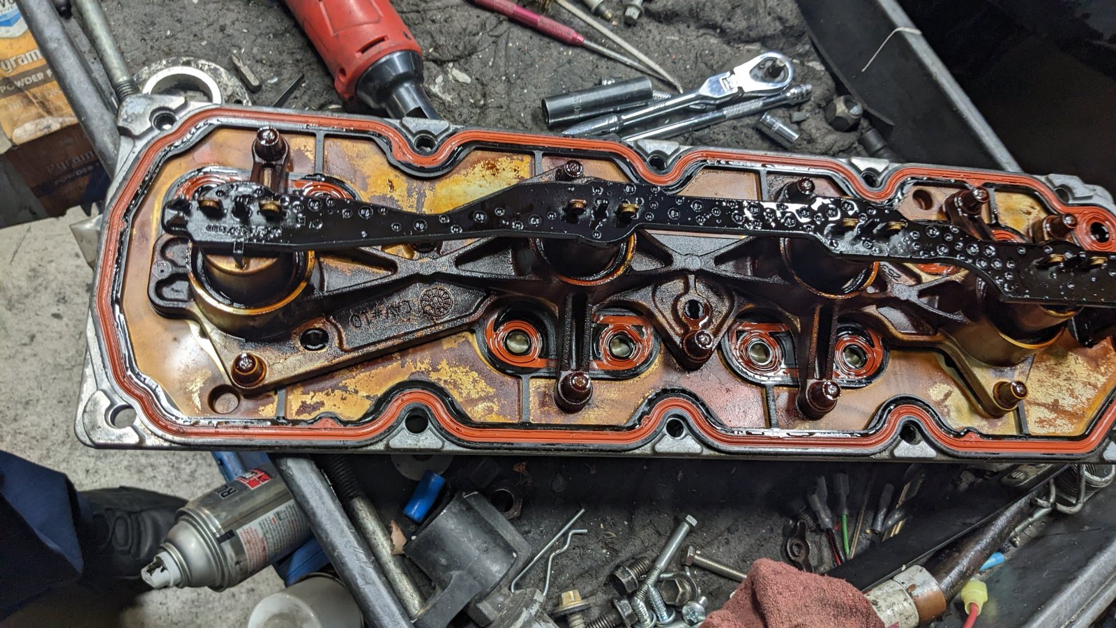

Hey all!
I found a bad leak coming from the valley cover gasket. However, it’s a whole assembly, Damnit!
anyone else replace one of these or know if you can get just the gasket?

Thanks! I’m researching. It doesn’t look like I can take it out without breaking the little plastic connectors to the inner gaskets. Hmmm

looking at your Pic, the gasket looks to be in good shape. I don't see it ripped up? it's pretty common for the bolts to come loose. I didn't have a leak, but I reused it without issue. in your case, unless you wanna buy a whole new vlom cover. I'd probably just use back silicone rtv on the gasket and put it back together. Just straight black rtv, it's a bit hard to find but don't like their ultra black. black or Grey is the only ones I have any luck with. the others don't seem to be very oil resistant.
the sensors can leak pretty commonly too.

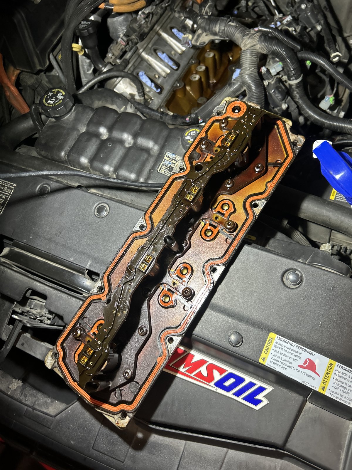

Holy crap!
Most of the bolts on my cover were lose! I was able to take them out by hand. WTF.
On a second note, this post also said the cover I have on my 08 Tahoe is not the revised cover, which you have, j91z28d1
I’m wondering if it’s worth a try to clean and torque down to spec with loctite. I can always take it apart again if it still leaks. I doubt I’ll be able to get an OEM assembly in town.
Thoughts?

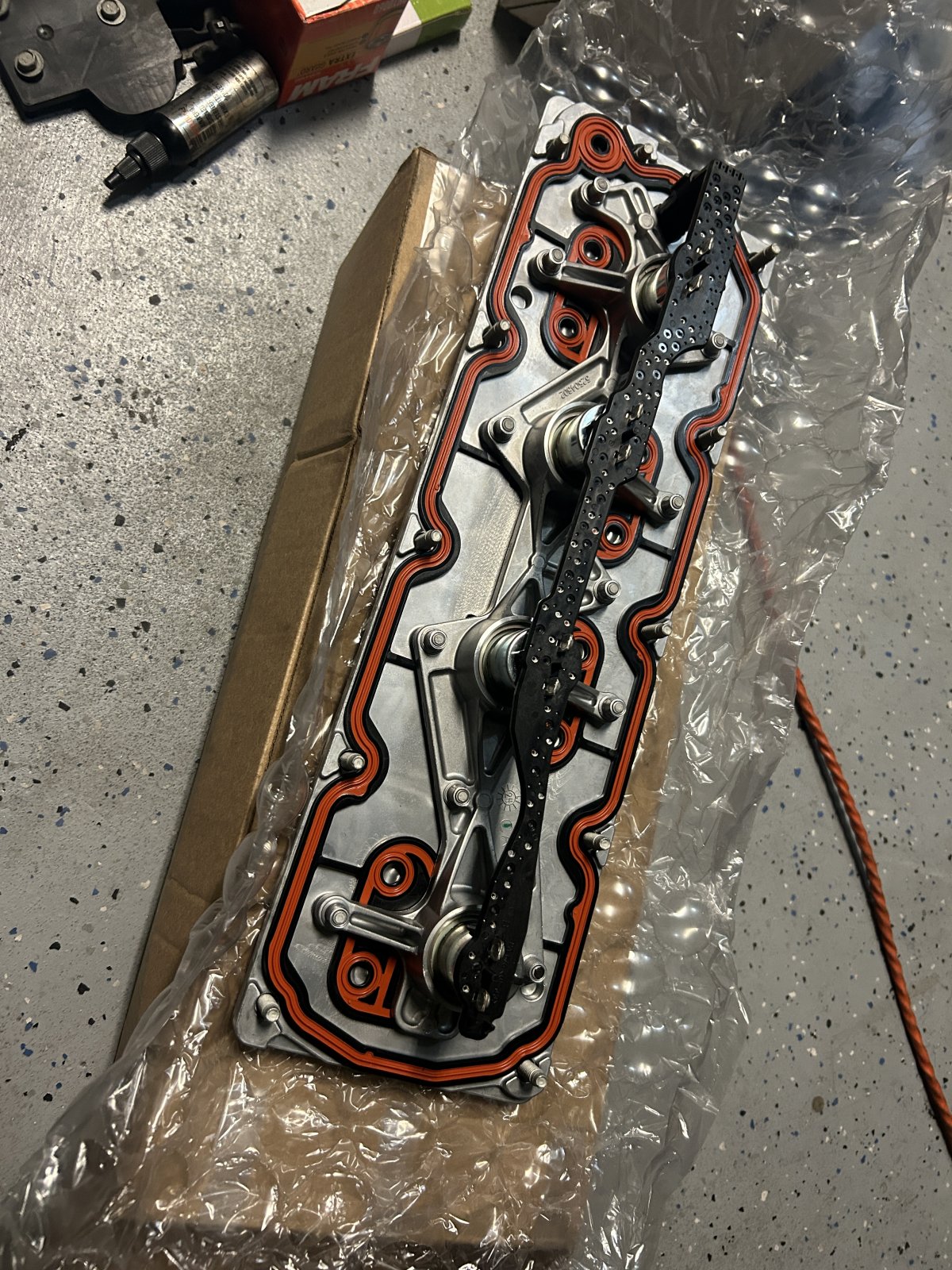

Update!
Yea AFM is active and working. My attempt at using RTV and torquing down the original VLOM was not successful. It kept on leaking after a few minutes and was shiny all around it when I took the intake off again. I ended up finding the updated VLOM at the dealership and popped it in. It goes into v4 mode much smoother and I can tell a big difference in performance of the back and forth between v4 and v8.

Known problem on these trucks is those bolts come loose. That type of valley cover the solenoid assembly is riveted on and the gasket is sandwiched in between. I just bought the complete assembly. I got the dorman one from a chain store.

Appreciate the suggestions. Yes it was leaking from several areas around the VLOM because of it being loose and the gasket was shot. It was also been leaking from the 5 pin connector on the original VLOM.
