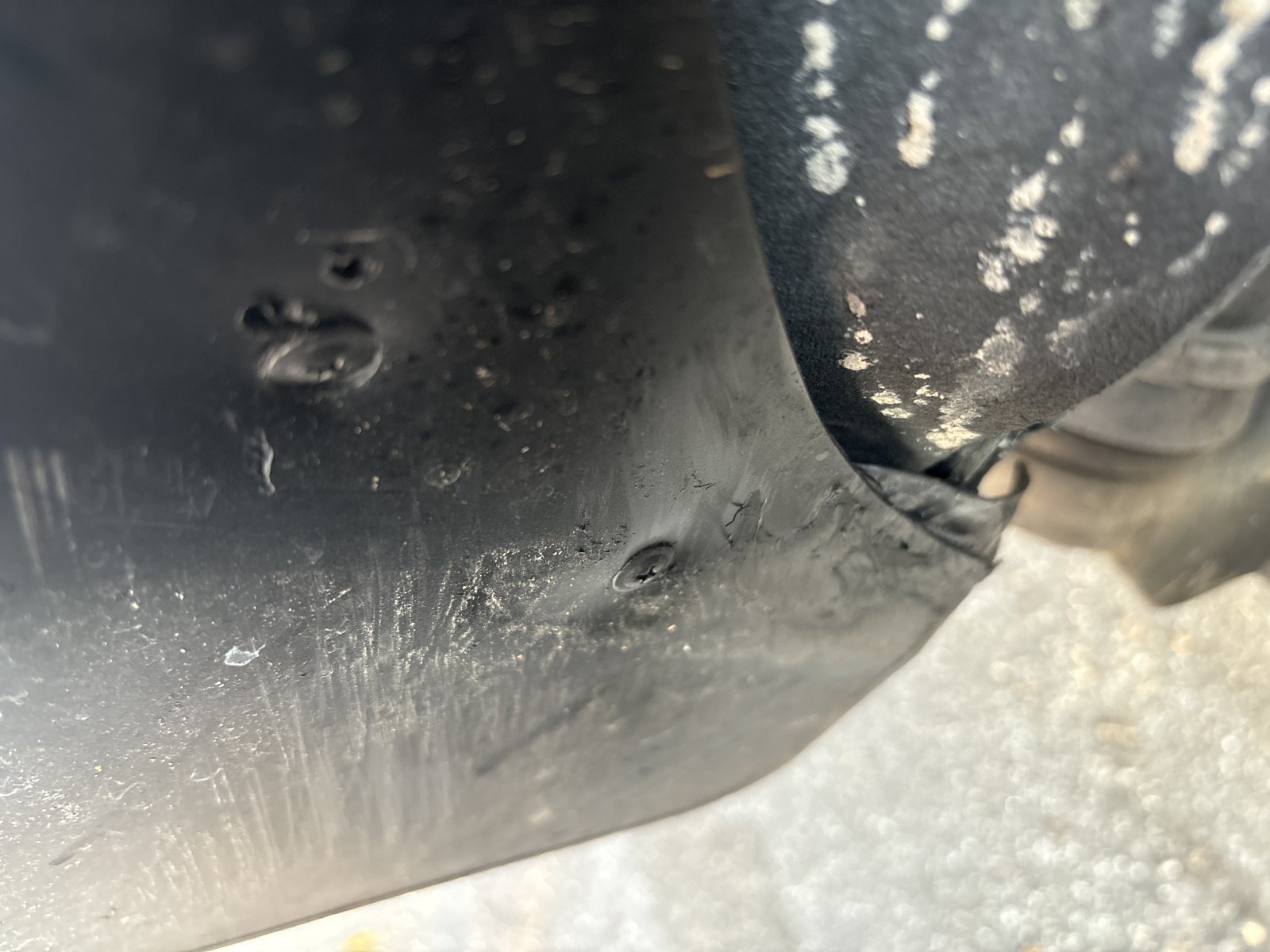

so I have a body lift and basically a leveling kit on wheel spacers I made it home alright but if I turn slightly I rub like crazy tomorrow I’m gonna ****** the cab side of the fender wells in the front

I’m gonna ****** the hell out of the cab corner I might affirm a lift kit to absolutely clear it
No surprise. I have a 6" suspension lift and I still needed a significant amount of trimming to prevent rubbing from my 35's.

the main problem is that i think my torsion key on the driver side is installed wrong so it sits super low? I should have a 3” lift and a 3” body lift from the torsion key but the driver side sits wonky I think it’s because I’m fat

I’m gonna test it without wheel spacers tomorrow and see if that helps at all

you need to find a wheel shop and request the nor-cal mod, that will fix you right up, if they do not know what a nor-cal mod is then keep calling around because you want it done right. any good shop that does lifts and wheels will know how to do it.
basically they cut and bend the fender just right to give you clearance.

I think the sledge and grinder will do me plenty fine

Do the NorCal mod on the inner fender/cab corner and trim the front bumper a hair you should be good may have to remove the wheel spacers if you got them up front

That’s weird though when we lifted mt buddy’s truck back in the day we did 3” body lift and 3” ford torsion keys and we cleared 33/12.50 atturo mt on 22x14s full lock just about with minor trimming

I think my keys are installed wrong I didn’t install them a shop did and the drivers side does not sit right at all
