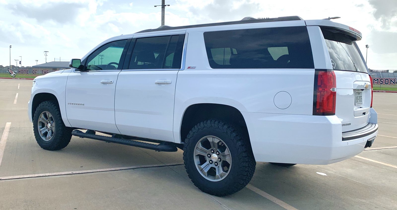

Running 33’s on 1.25” level, I’m sure with the right offset and some trimming 35s would work.

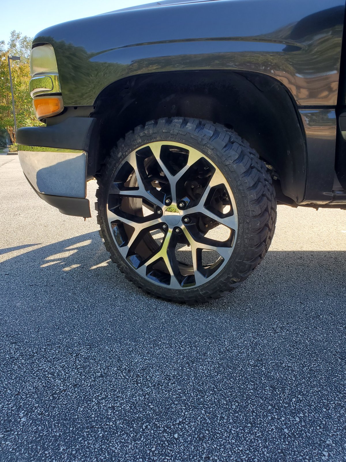

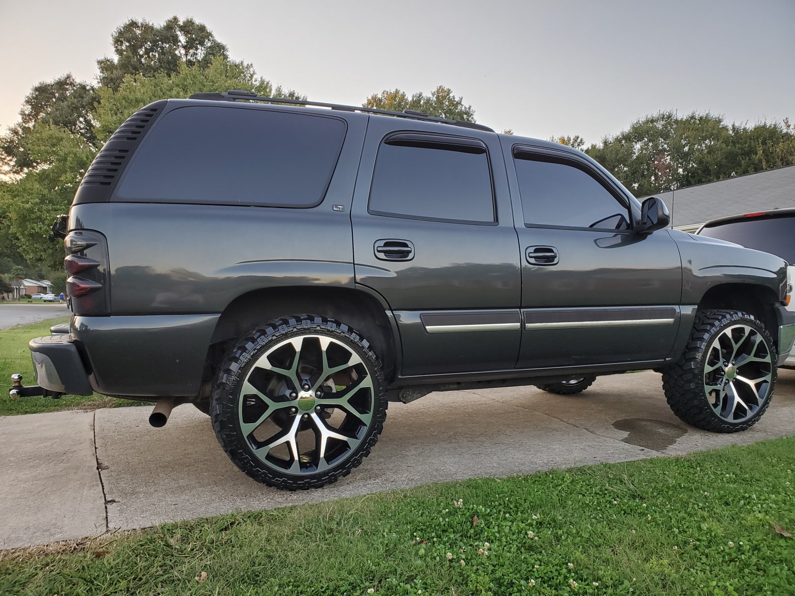

2005 tahoe, with level kit. Keys are just about maxed out. 33" fury country hunter m/t x 12.50 x 24's
24x10 Positive 24 offset no rubbing
Wanted 35" m/t but would've had to trim
