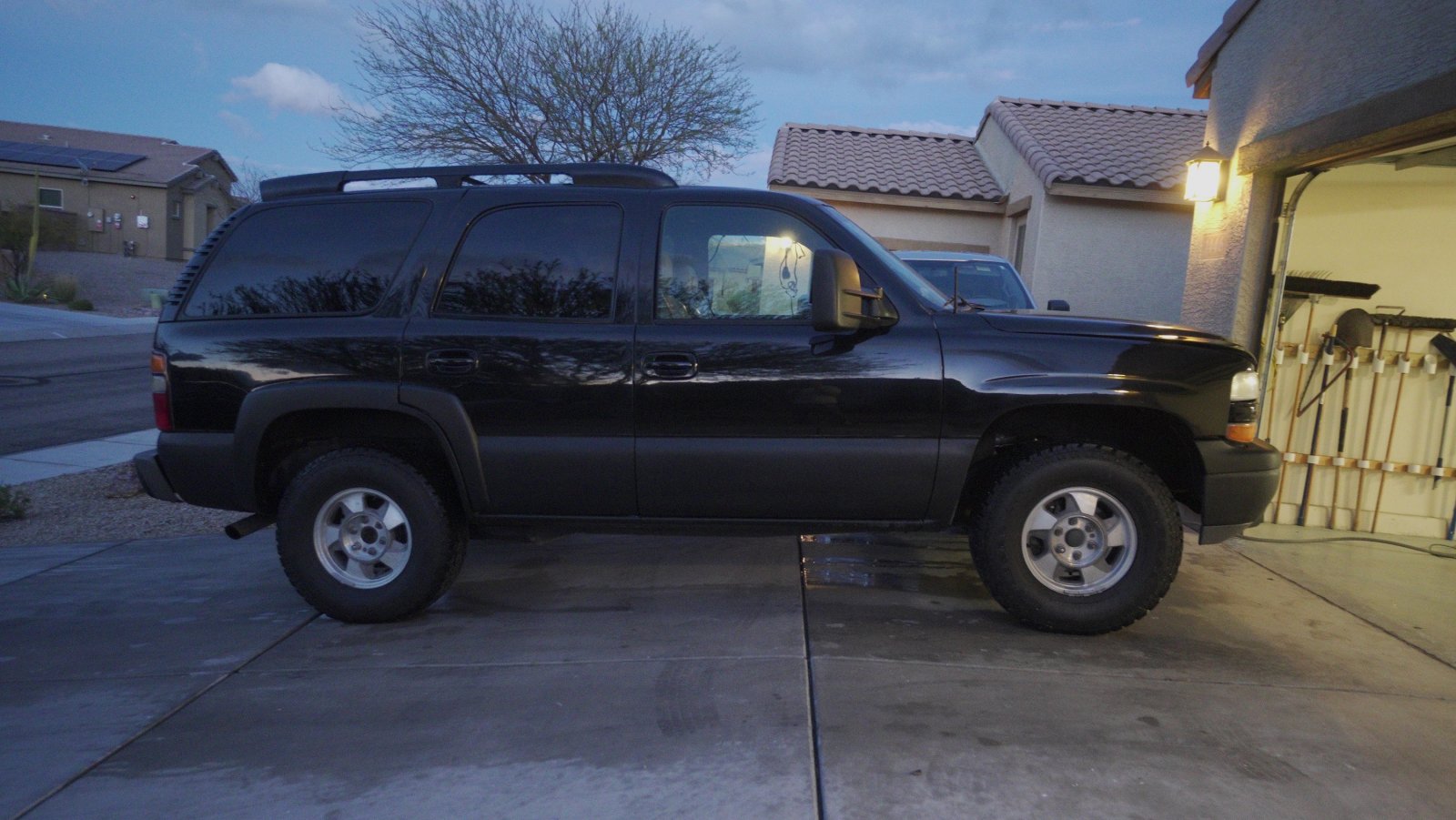

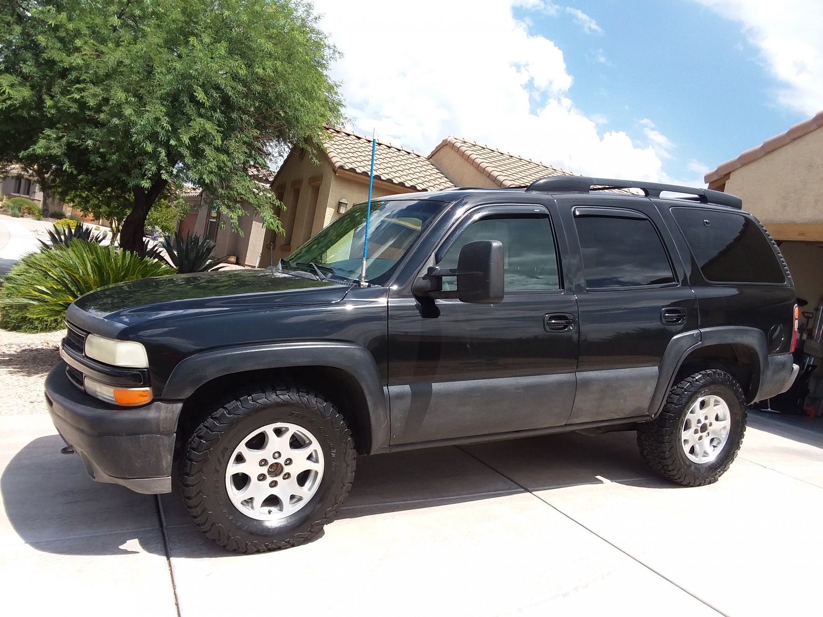

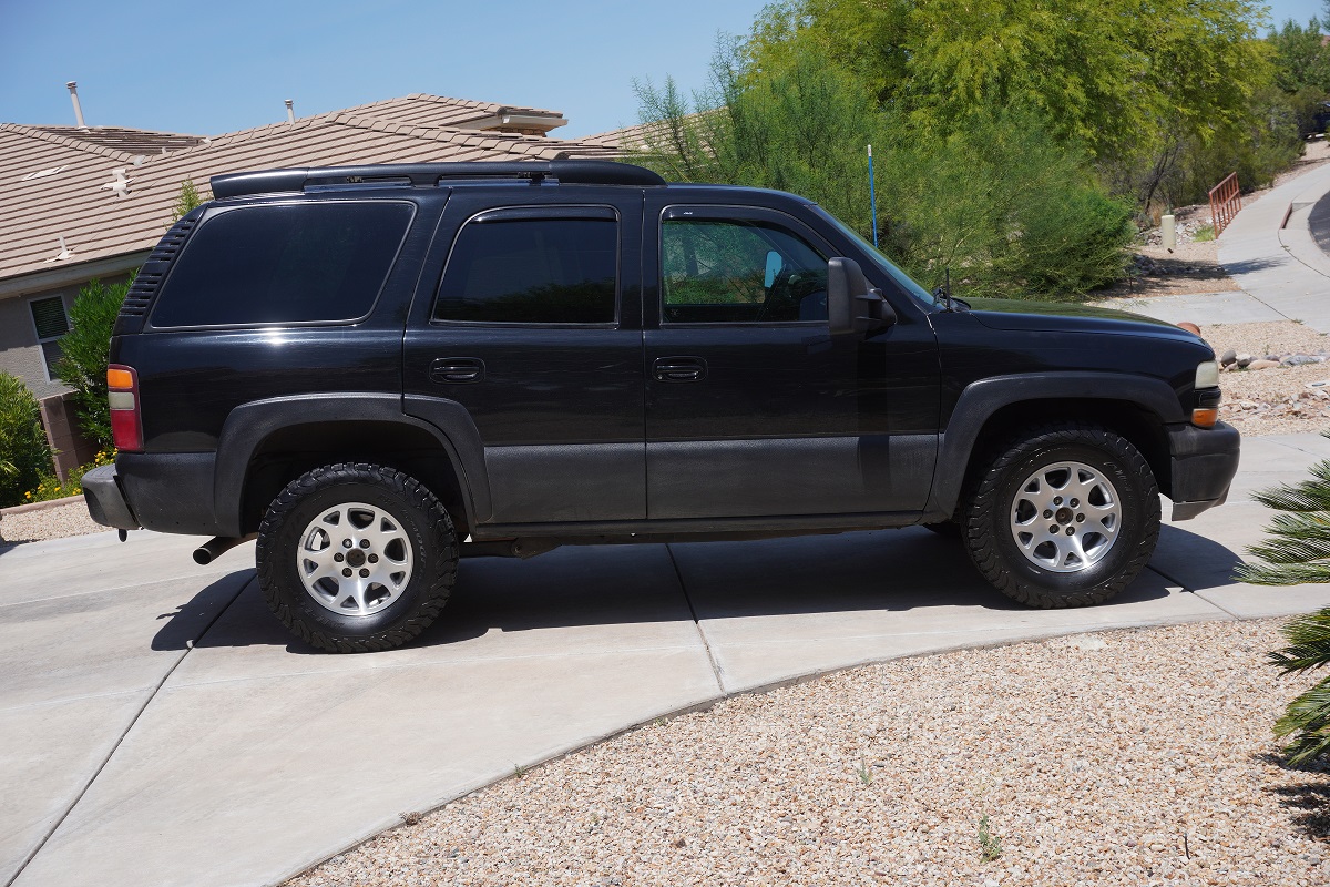

This time I wanted larger tires I went with 285/70R17 which is a touch bigger than factory at 265/70R17. All my test fitments are good so far, no rubbing. I think there might be some rubbing on the plastic fender liner on the back when I get off road and test full articulation... Not sure this would be an issue on a truck chassis / bed as they don't have those plastic liners. I don't think front wheel wells will be any issue. I have stock geometry suspension w/ 1" lift in front / leveling kit. I didn't want full 2" lift as I wanted to maintain some rake and stay reasonably within factory control arm spec. I also tested to see if the tires would fit in the spare tire well and zero issues there. Other than I had to buy a 17" spare tire rim off a GMT900 and 5th tire for another $100. So add $230 to price above for complete set of 5 tires, making it $500 w/ spare tire and rim.
I made SURE my spare tire was a Load E 10 ply K02. However, I didn't realize when I bought the other KO2 tires they were Load C 6-Ply / 116 Load Index. The 116 Load index is fine, however, I've never run 6 Ply tires off road. I run over rocks and all sorts of gnarly stuff. Anybody else had experience with Load C tires? This has me a touch concerned.
16" Factory spinners truck came with
17" 265/70R17 w/ factory snowflake wheels I pulled off GMT800 Z71 Suburban I found in junkyard
Those 17" Snowflake wheels with 285/70R17 KO2 tires

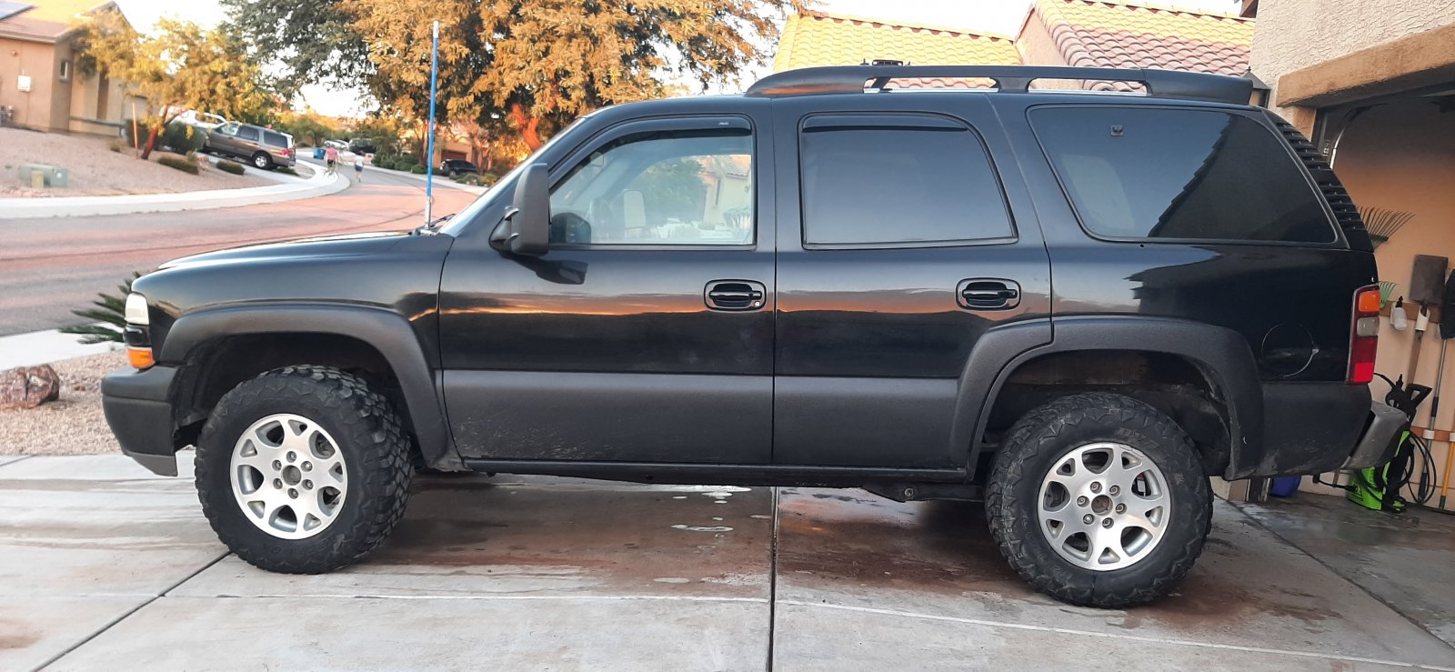

I need to update this post. The 285/70/R17 wheels do rub in the back fenders at full articulation. I've observed this in myr GMT800 Tahoe. I don't believe the pickup trucks would have this issue as they don't have a inner fender insert like the SUV version. If I go on two wheels off road the rear wheel with the load on it rubs on the plastic insert.
I should note, I did see somebody with 35x12.50R17 wheels. These are 35" tall, he didn't have a lift. It was a 2005? Tahoe. He showed me his front fender liner had to be cut a bit on the front and the back as when turning the tire grabs it.
He also only drove on the highway. It's hard to find people who go off road and have tested these larger tires with full suspension articulation along with full stop both ways on the steering.
