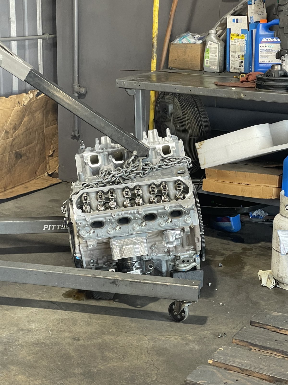

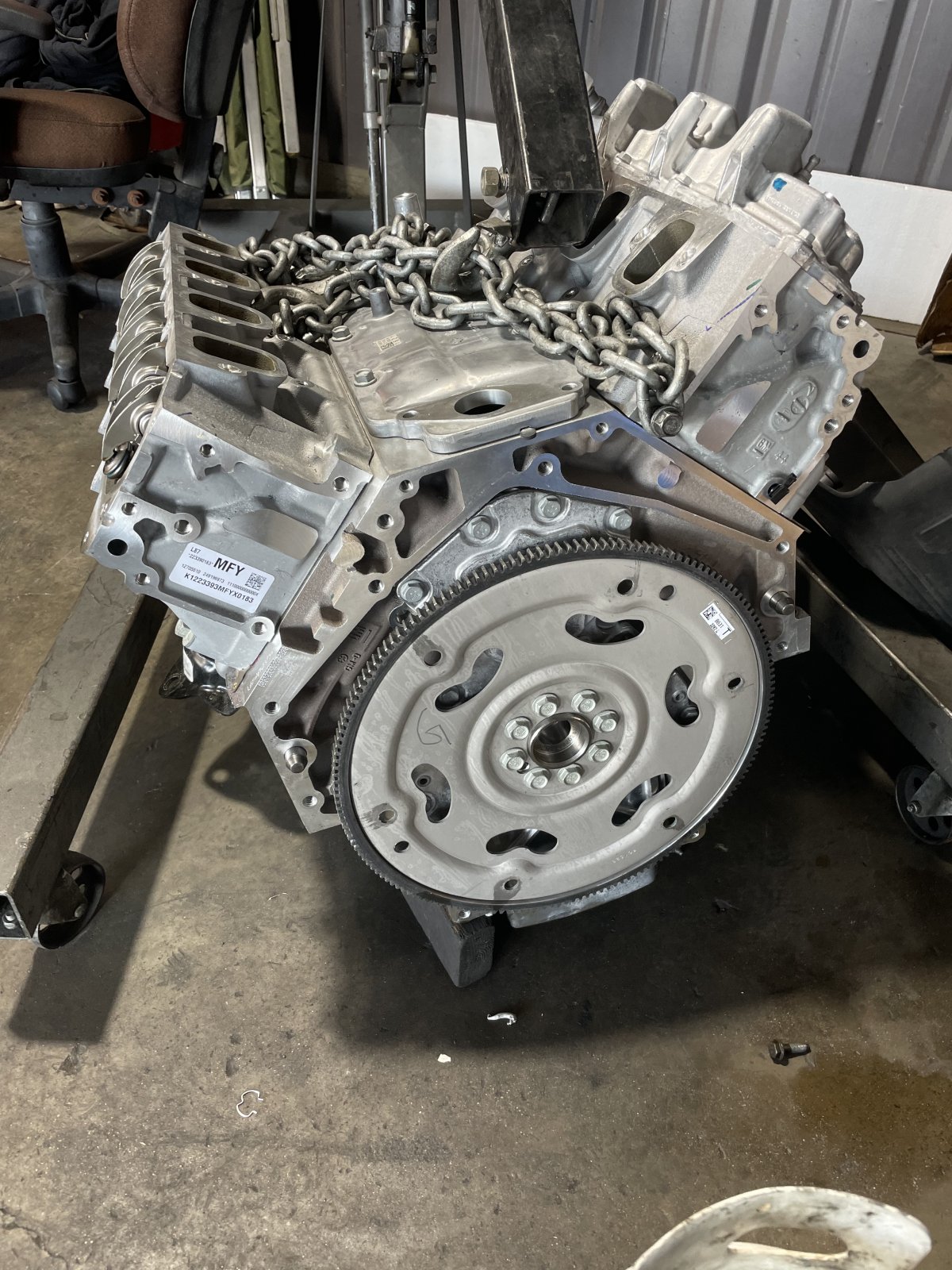

My motors been pulled. I picked up the dealers loaner and parts has told the new motor is en route and could be here by Friday. Here’s my old motor in a heap on the floor ..
Very UNPROFESSIONAL way to pull an expensive engine. Notice the way the chains are bolted to the engine. Any self respecting mechanic would use what is called an engine fixture that bolts directly to the engine for removal. I even have several at home to remove GM engines and other brands also. Only question I have is where is the shade tree? Someone needs to tell that dealership to spend a little of that 100 bucks an hour labor and buy an engine bracket!
